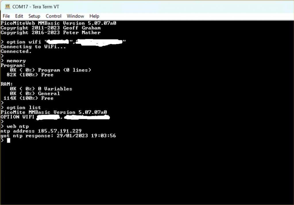

It's cold and dull in the UK and I was bored....
If you have a pico_w try the attached
PicoMiteWeb.zip
The firmware is identical to the PicoMite except for the following:
Removed
GUI command, CTRLVAL command and CTRLVAL function
Changes
Available memory - still to be tuned - may increase or decrease
Added
OPTION WIFI SSID,PASSWORD
To disable wifi use: OPTION WIFI "",""
WEB command with currently one sub-command
WEB NTP 'connects to an NTP server ("pool.ntp.org") and updates the system time and date
TBD
All the other WEB subcommands
Edited 2023-01-30 05:10 by matherp

Posts: 6624
Posted: 09:12pm 29 Jan 2023
I knew I purchased a wifi module for a reason.
(too soon to ask but) Will the WEB NTP command get a timezone parameter?
> OPTION LIST
PicoMite MMBasic Version 5.07.07a0
OPTION WIFI someplace, not_telling
> web ntp
ntp address 88.198.226.248
got ntp response: 29/01/2023 21:12:54
> print time$
21:13:25

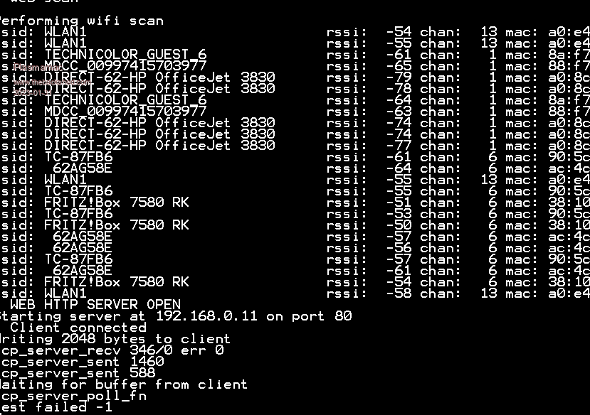

Posts: 11996
Posted: 10:14am 30 Jan 2023
V5.07.07a1
PicoMiteWeb.zip
WEB NTP [adjust]
The optional parameter 'adjust' is a float between -12.0 and +14.0 and allows you to offset the time given by the NTP server to suit your timezone
WEB SCAN
Scans for wifi access points in the vicinity
NB: forgot to mention in the first post GP23, GP24, GP25, GP29 are now completely inaccessible from MMBasic as they are used by the pico_w to communicate with the cyw43. The LED on the pico_w is actually driven by an IO port on the cyw43.
You can also try
WEB HTTP SERVER OPEN. This will create an HTTP server on the pico_w on port 80 (NB: not HTTPS). Doesn't do anything at the moment but you can connect to it from a browser and you will see the diagnostics. You will need to reset the pico_w to get out of it.
