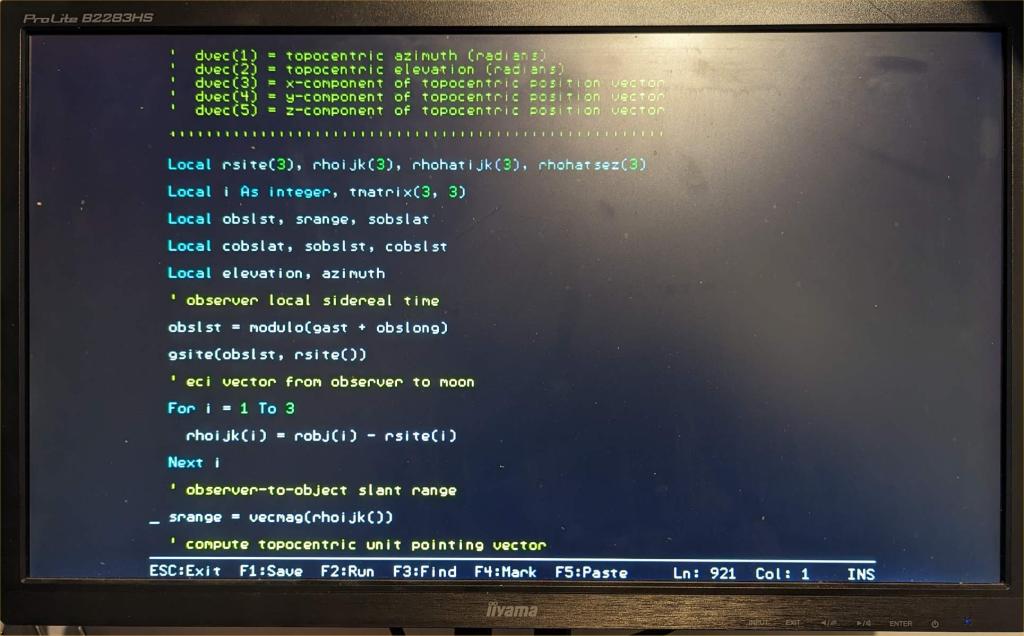

I was working on the Telnet connection to the WEB version when, prompted by posts on the TILE thread, I realised, based on a similar approach to the implementation of Telnet,  I could potentially significantly enhance the VGA functionality much more easily than I had previously thought and this is the result.
Basically to achieve this I just had to modify two drawing primitives in the firmware DRAWBITMAP and SCROLLLCD and gain some memory.
The memory was gained by reducing the maximum program size to 96Kb (from 100Kb) and consigning some of the SDcard routines from RAM to Flash memory. This allows for 80x40 tiles 8 pixels wide and 12 pixels high, or the existing 40x30 tiles 16 pixels wide and 16 pixels high.
The key to this release is in the DRAWBITMAP routine. Previously in mono mode this just output an "on" pixel or an "off" pixel. However, it was already being fed with the foreground and background colours - it just ignored them.
Now, it analyses the bitmap subject to the following conditions:
Does the bitmap start on a pixel exactly divisible by the current tile size both vertically and horizontally?
Is the bitmaps' width and height an exact multiple of the current tile size?
In the case of the editor both these conditions will always be met.
If the conditions are met then the DRAWBITMAP routine now sets the tile(s) where the bitmap (typically a text character) will appear to the foreground and background colours requested.
The change to SCROLLLCD was similar. If the vertical scroll is equal to an exact multiple of the current tile's height then scroll the tile colours as well as the screen pixels
These two simple changes effectively enabled full colour editing in 640x480 resolution (mode 1). There was a bit of tidying up in the editor around the cut-and-paste functionality and making sure to set tiles to the correct colour when deleting characters. Otherwise it just worked.

Edit with Colorcode looks Nice, Peter..
but ..
I just discovered a small imperfection..
1. in the editor (mode 1 or 2, color code on or off)
when you move the Cursor from bottom to top and it starts scrolling, the content disappears, except for the top line.
2. If you start editing a Line, everything below this Line disappears
This effect is independend of TILE SMALL or LARGE
Cheers Mart!n

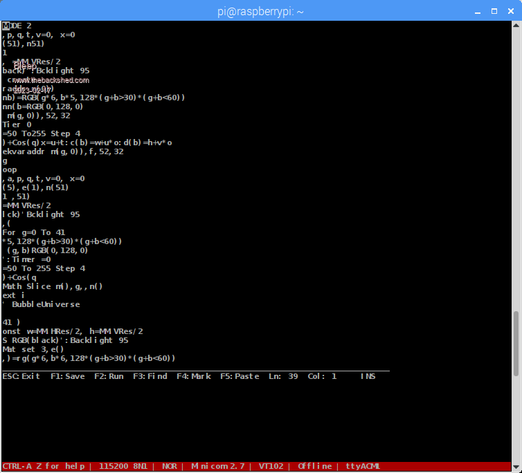

I have a problem when using the editor in mode 1.
If I change to Mode 1 and then Edit, the editor only shows some of the lines of the program and locks up solid, requiring a power off reset.
PicoMiteVGA MMBasic Version 5.07.07b19
OPTION SYSTEM I2C GP22,GP15
OPTION COLOURCODE ON
OPTION KEYBOARD UK
OPTION DEFAULT MODE 2
OPTION DISPLAY 30, 53
OPTION SDCARD GP5, GP2, GP3, GP4
OPTION AUDIO GP6,GP7, ON PWM CHANNEL 3
OPTION RTC AUTO ENABLE
OPTION DEFAULT FONT 7, 1
I have now found that it's the OPTION DEFAULT MODE 2 that is causing this, if I change it to OPTION DEFAULT MODE 1 all seems to be ok.

Also, I accidentally copied and pasted all of this piece of code, using autosave.
vgabubble.bas.zip
I realise it's several slightly different versions of the same code, however once loaded the editor mangles it, the first 35 lines of code are fine and consist of a loop so the rest is never executed. However I didn't think the remainder should get corrupted like this, even though it shouldn't be there? the image is after scrolling down one page. I had done a flash erase and fresh install of b19 with no options set this is a terminal, but the VGA looks the same. This isn't particularly important as I shouldn't have done it! :-(
Any Ideas?

Fixes a bug if OPTION DEFAULT MODE 2 is set and you execute EDIT 1
