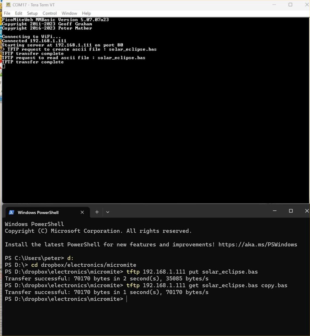

V5.07.07a24
PicoMiteWebV5.07.07a24.zip
Note the times taken and the file size
See here for how to enable TFTP on windows (tested on W11). Linux users: you are on your own
The TFTP server is automatically enabled if you are connected to wifi and makes transferring files easy and fast. NB: The protocol TFTP does not support directory listing etc. so don't ask. It is also completely insecure so only use on your local network.

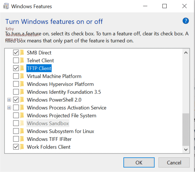

Posts: 3884
Posted: 01:28pm 13 Mar 2023
  TassyJim said  Works from Windows 11 after enabling tftp client in apps and featuresJim
Thanks for that. I struggled with the installation of the SolarWinds TFTP server. It ran through most of the steps, then said the installation had failed. I ran it again, and it asked if I wanted to Repair or Remove. I chose Repair, but TFTP from the PowerShell didn't work. I uninstalled and repeated: again failed, again repaired.
Now with Jim's suggestion, after searching for Windows Features, I went here:
Clicked TFTP Client and OK, and now it works. Great improvement in speed of transfer and ease of use.
Posts: 11938
Posted: 02:04pm 13 Mar 2023
Just to be clear to anyone else.
You need to install a TFTP client and not a server to use the new functionality. The link I provided explains both and I should have made it clear that only the client is needed and in windows that is just a matter of enabling it.
