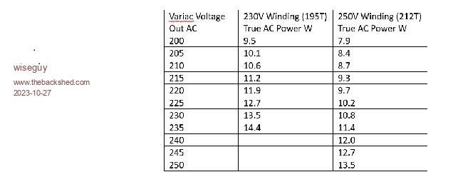

wiseguy
Joined: 21/06/2018
Posts: 1307
Posted: 01:11pm 26 Oct 2023
Hi sPuDd, sorry to bump an old thread, what did you do about your Toroid core search ?  I am also in the process of creating and building up a 7kW continuous inverter that should easily handle peaks up to around 15 or 20kW.  If you haven't solved this yet below is my proposed solution.
I am not keen to wind up a toroid from scratch and have been considering what approach to use for a while now. Before I went on holiday some months back I had recently bought 2 x complete 3.5kW Aerosharps ($50 each).  They have a big Toroid, 195T 230V winding and a 212T 250V secondary. I propose to unwind 17T from the outer 212 turn secondary (making 195T) and place the 2 x 195T in parallel for lowest impedance.
If I do this to both toroidal transformers and then place one on top of the other and wind just a 13T primary that passes through & around both cores and parallel the 4 x 230V windings the result should be quite good, The primary is just 25mm square (or 32mm) PVC single core cable.
I initially experimented with a 25T primary on 1 toroid, which gave the best results, but 2 stacked toroids means the primary turns are halved. That is the basis for my solution, using 2 x professionally wound toroids (albeit with 17T removed from the outer windings), sure it doesnt give a big hole in the centre but it appears the 13T primary should be a cinch to add to the ~ 52mm central hole.
Stacking 3 such cores and using an 8T primary is also possible but would be hard to physically manage, the idling power for the 2 cores would be ~ 38W, 3 would be ~ 57W
If instead of removing 17T from the 250V winding you added 17T to each 230V winding and paralleled up all the 250V windings but ran the output voltage at 230V from the 250V windings, driven from a 9T primary, idling is a bit better at ~ 16.5W for each toroid or 49W for the 3 toroids.
Cheers Mike
wiseguy
Joined: 21/06/2018
Posts: 1307
Posted: 01:32am 27 Oct 2023
Hmm those figures of idling current seemed a bit high so I went and remeasured with a Variac and an accurate watt meter. Sure enough they were very wrong.
The figures I posted above were logged about a week before posting and were for the total DC Power idling Watts for various output voltages using an EG8010 controller drive, no wonder they were a tad high!
I relogged both windings separately against various 5V increments from 200V to 250V and made a table of the results for the Aerosharp 3.5KW Toroid.
So reposting the last paragraph from the previous post of the idling watts with the CORRECT values:
Stacking 3 such cores and using an 8T primary is also possible but would be hard to physically manage, the idling power for the 2 cores would be ~ 27W, 3 would be ~ 40.5W
If instead of removing 17T from the 250V winding you added 17T to each 230V winding and paralleled up all the 250V windings but ran the output voltage at 230V from the 250V windings for a 3 stack, driven from a 9T primary, idling is a bit better at ~ 10.8W for each toroid or 32.4W for the 3 toroids. Note this is AC power required for just idling an inverter with no load and does not take into account inverter and solenoid etc running currents.
Edited 2023-10-27 11:33 by wiseguy
Cheers Mike
