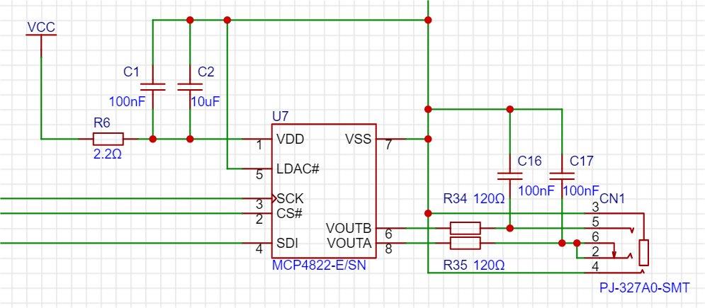

@Lizby.  The audio will be as above the MCP4822!
I bought a couple to play with I'm contemplating using a couple of those PAm8302A amps
Should give a good sound.. I'll feed the amps via trimmer so I can get a decent level

  IanRogers said  @Lizby.  The audio will be as above the MCP4822!
Ok, here's the schematic pinched from Peter's EasyEDA project:
If it's the only SPI device, then /CS could be tied low, so only 4 pins need to be wired: V+, V-, SCK, MOSI/SDI (but maybe the firmware needs for CS to be specified).
Edited 2023-06-09 23:20 by lizby
Posts: 9031
Posted: 01:20pm 09 Jun 2023
I think you may need CS# as part of the SPI synchronising process. Not sure.
Consider yourself lucky that you don't need LDAC# too. :)
Posts: 11746
Posted: 01:35pm 09 Jun 2023
Without CS it won't work
Posts: 3855
Posted: 01:53pm 09 Jun 2023
  matherp said  Without CS it won't work
Thanks. Second thought had made me believe that would be the case.

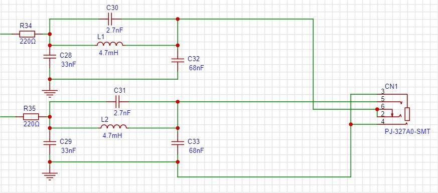

Here's the inductor circuit from the EasyEDA V1.0 file:
I don't have and can't find on aliexpress through-hole 2.7nF capacitors. Will either 2.2nF or 3.3nF suit?
Posts: 9031
Posted: 02:10pm 09 Jun 2023
You'll get something, but it won't be as accurate as it should be as it's a tuned circuit. A 1nf and a 1.5nF in parallel would be closer.
Posts: 3855
Posted: 02:25pm 09 Jun 2023
Ok, I found these 2700pF
