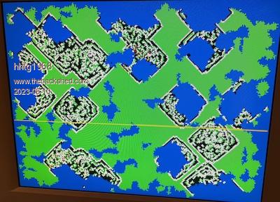

Hi from Germany.
Since a few days i convert an old Basic program from the 80s. During school i programmed a bological/ oekological simulation on my amstrad cpc 464 for computer science. i conbverted it later for the colour maximite 1 and 2.
i cannot test it on my picomites cause my interface for vga is still not ready (i am waiting for the sub-d vga adapter) but i tried to use commands for the picomite basic. i think you have to use the command mode 2 (instead of mode 7 on cmm2) for 320x240 resolution, i test the system variable mm.device$.
the progeram use pixels as plants or animals. black is nothing or desert. green is gras. white is sheep. red is wolfe. blue is water. and magenta is poison.
water helps to erase poisened areas. wolfes need sheeps, sheeps need gras etc.
you can press "h" for help. "q" for quit. with keys you can insert wolfes and sheeps, you can make rain. poisoned rain and you can use an atomic bomb.
i do not know why the save image command is so slow. i use it for caching the screen during help. perhaps i should use kind of framebuffer.
i will add several functions the next weeks. so i want to code a gui to change the q
i would be happy if someone tests it on the picomiteVGA.
screenshots will follow...
yours hhtg.

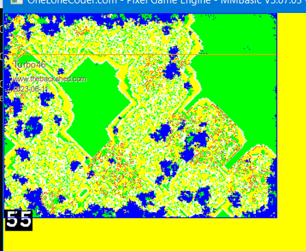

Greetings, hhtg -
I just tried porting your program to the PicoW, using a WaveShare Pico-Eval-Board (480x320 ILI9488W LCD display) and firmware version 5.07.08b1, and the following declaration for the display:
OPTION LCDPANEL ILI9488W, RPORTRAIT,GP8,GP15,GP9,GP13
Without any changes in logic (but a little reformatting), I ran into a problem, getting this message on the terminal after lots of green pixels are displayed:
LIFEpx3c2 v4.0.1 FOR WebMite
converted from my version FOR the amstrad cpc 464
from 1985!
(c) hhtg. 09-06-2023  21h00
press a key OR wait a little bit...
i_schaf: [ 217, 194]
[218] o = Pixel(x, y + 1)
This is unexpected; the WebMite manual, page 133, says that the PIXEL function works for ILI9488 displays.
(I added the PRINT statement within i_schaf to see if the coordinates are outside of the screen; they're not)

two screenshots and one small movie...
screen3.mp4.zip

Yes MMB4W does have graphics, this is a display:
It only displays on a small section of the screen. I've not tried it on the CMM2 yet.
I see that you are using a Mac so MMB4W is not so easy. The program just starts and it's not clear what is happening if you don't already know. If the start screen shows something like:

ecological simulation. yellow is desert. green is grass. white is sheep. red is wolfe.
you can press h or ? for help. there are several functions: atomic bomb. poisoned rain etc. try the keys...
if you change mx and my (320x240 at this time - for the picomitevga and mode 2...) you can have a greater 8or smaller) area...
i will integrate the hint to help at the beginning...
