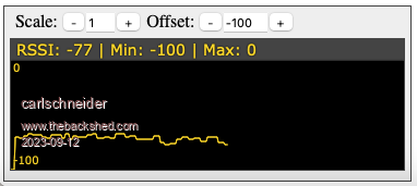

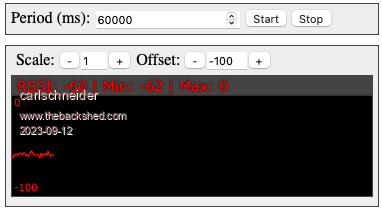

The WiFiScannerv1_0.bas is a WiFi Scanner with the option to continuously monitor and graph the RSSI of a selected SSID.
Copy the expanded content of WiFiScannerv1_0.zip onto the Pico W, load WiFiScannerv1_0.bas into program memory and launch.
WiFiScanner.zip
The WiFiScanner will do a web scan and present the SSID RSSI table and wait for the case sensitive plain text SSID to monitor. Once the SSID has been typed and Enter'ed the WiFiScanner will do a web scan every 60 seconds and print the RSSI on the console. It also assembles a JSON string which is automatically fetched by graphrssi.html when launched. Note that the refresh and polling rate is once per 60 seconds, so slow and patient ... This the way.
This means that it will take >120s before the first RSSI is printed on the console and available in the JSON string.
Given the above it is best to wait with launching graphrssi.html in the browser until the first RSSI is printed to the console.
You can dig around in the code and change the timing of the refresh in graphrssi.html and in WiFIScanner.bas, but be aware that web scan takes around 10 seconds to produce the SSID RSSI table, depending on the number of SSIDs found. Further, it is possible to overload the web server running on the Pico which will cause the program to abort to console.
The trending over time gives one an idea of what is happening in the WiFi environment the Pico W finds itself in, as well as what sort of signal strength is being seen by the Pico W for the SSID of interest.
I have noticed that the Pico W in the Breakout Board appears to have a worse RSSI than the Pico W lying on the desk.
An example of the graphing below, firstly the Pico W lying on the desk and second the Pico W plugged into the breakout board.
Pico W in breakout board
Hope this is of some use to somebody.
Cheers Carl

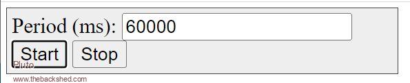

Thanks Carl for the nice utility!
I have scanning ongoing and the results are nicely presented on the console.
However, I am not able to get any results to the browser.
The layout of the page is slightly diferent from what you showed in your post! Start and Stop at the bottom instead of to the righ of the "period" window.
option list
WebMite MMBasic Version 5.07.08b15
OPTION AUTORUN ON
OPTION DISPLAY 41, 140
OPTION WIFI HuaHuaNisse, ***********, PICOE6616408439
OPTION TCP SERVER PORT 80, 20000
A:/
  <DIR>  .
  <DIR>  ..
00:03 01-01-2000       6272  .DS_Store
00:04 01-01-2000        128  404.html
00:04 01-01-2000        128  all
00:04 01-01-2000        128  apple-touch-icon.png
00:00 01-01-2000          4  bootcount
00:04 01-01-2000        128  favicon.ico
00:04 01-01-2000       2432  graphrssi.html
00:04 01-01-2000       1024  graphs.js
00:04 01-01-2000        128  JSONHeader.txt
10:50 12-09-2023        200  log.txt
00:05 01-01-2000       6528  WiFiScannerv1_0.bas
2 directories, 11 files, 512000 bytes free
Used the proposed 192.168.32.13/graphrssi.html to access graphing.

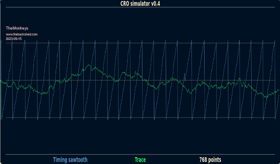

Hi Carl,
Have you considered using csv and a browser canvas?
It works fine for me.
Cheers,
Chris.
