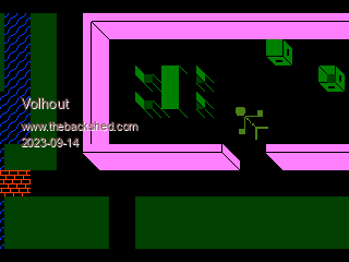

All,
Have spend 1 evening in toying around with my idea's about a basic implementation of PETSCII ROBOTS on the picomite VGA. This is VERY inmature. Just a scrolling landscape dynamically created from a world map.
No animations yet (opening doors, AI robots), just a player walking the map.
Some tiles (sprites) are based on commodore PET artwork, some are plain trials using color (with mixed success...pink...auch!!).
I will update the status in this thread.
P.S. the "player" is pasted in since SAVE IMAGE will save the active layer only. And player and world map are in different layers.
P.P.S. Thanks to Martin.H who's sprite editor (SPRED version 102) is very usefull.
Edited 2023-09-14 21:51 by Volhout

Posted: 12:25pm 14 Sep 2023
That looks promising.   I'm excited to see how it plays

Posts: 6187
Posted: 01:13pm 14 Sep 2023
@peter,
SAVE IMAGE "file.bmp" still gives the active layer only
I am on FRAMEBUFFER WRITE N
I have FRAMEBUFFER LAYER
also tried:
SAVE IMAGE IFF "file.bmp" gives "expected a string" error

Posts: 6187
Posted: 01:32pm 14 Sep 2023
  matherp said  One more try
PicoMiteVGA.zip
YES, that does it.
Thanks !

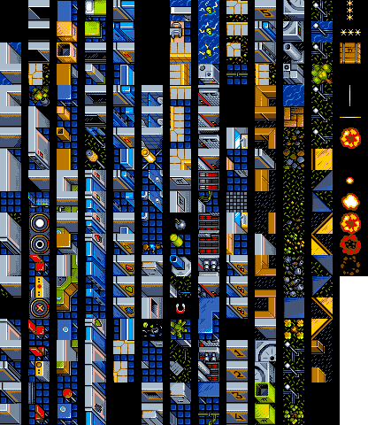

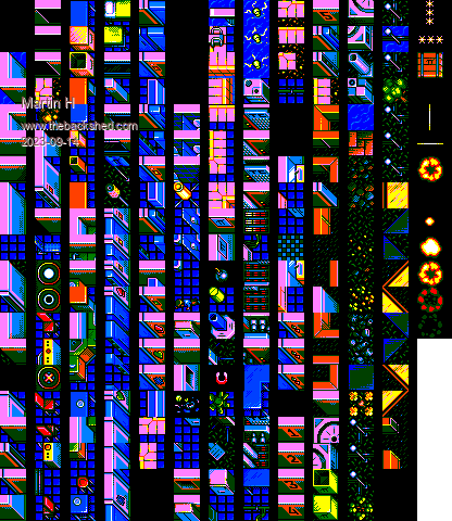

  Volhout said
Hi Martin,
I have taken the short route to getting some tiles. Create them myself from the youtube video on PETSCII ROBOTS part 1 and your character set.
When the game is funrther ahead, me, or you, or any volunteer can create a marvelous tiles set....
The Tiles on Amiga
and here, how the Tiles could look in the 16 Pico Colors...
not so ugly at all
Edited 2023-09-14 23:42 by Martin H.

Posts: 6187
Posted: 01:45pm 14 Sep 2023
The pico has memory for roughly half the tiles the amiga has.
But we may not need to since robots and player (and maybe explosions) are on a different layer. So I do not need a player on tarmac, a player on carpet, a player on grass etc...
Layer "F" (the framebuffer) can hold 130 tiles (24x24).
Edited 2023-09-14 23:47 by Volhout
Martin H.
Joined: 04/06/2022
Posts: 1570
Posted: 02:01pm 14 Sep 2023
  Volhout said  The pico has memory for roughly half the tiles the amiga has.
Using the F layer cost you another 36k of Memory
Maybe better buffer the Tiles on A: as it is much faster than the SD Card B:.
If you now map the score and health display to a 64x240 area on the edge only on the layer, you can temporarily save 14 tiles you need on the N screen below without them becoming visible.
--edit--
You can also consider halving the resolution and reducing the size of the tiles from 32x32 to 16x16 the Space under the Layer would last for 60 Tiles
Edited 2023-09-15 00:17 by Martin H.

Posted: 03:29pm 14 Sep 2023
On the Amiga, the Playfeeld is just 266x168  (AmigaScreen is 320x200)
So, I repainted the Mask for the Layer and reduced the Tilesize to 24x24
PicoTiles.zip
Edited 2023-09-15 01:33 by Martin H.
