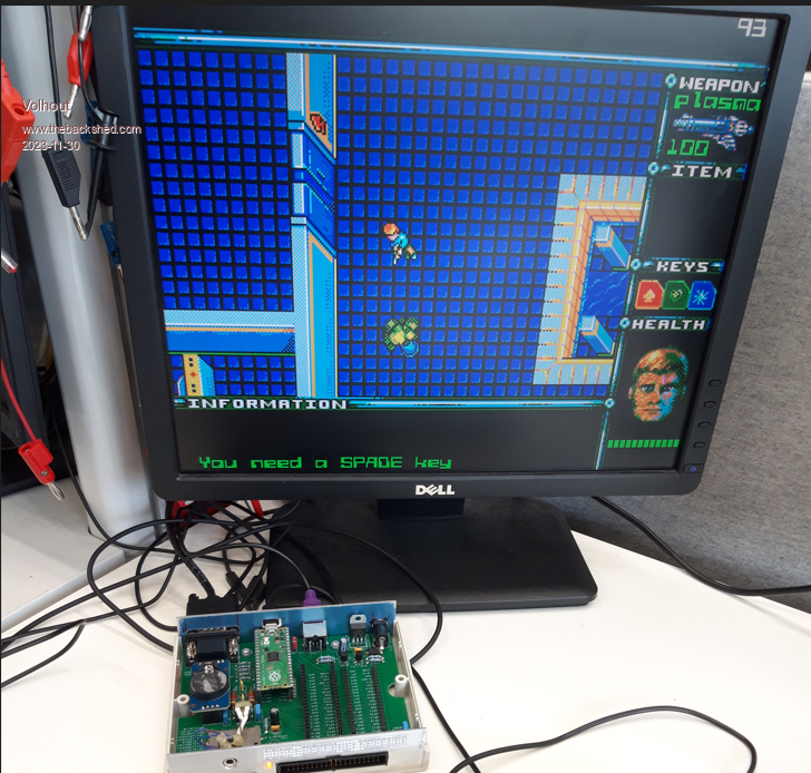

The development of the PETSCII ROBOTS game (original designer David Murray aka The 8-bit guy) for MMBasic for the PicoMite is in beta phase.
The game should have all game elements implemented. In this phase we are looking for testers. People who want to play the game, and report problems with functionality of compatibility.
Attached in this post are
- the original game manual
- the game itself
- picomite firmware versions for picomite and picomiteVGA (V050708RC21)
The game will run on:
- Picomite VGA platforms, using keyboard control
- Game*Mite platform (LCD), using the 8 buttons for playing. You must start the game using the keyboard though, since it is not autorun becuase you replaced the GameMite firmware.
- PicoGameVGA platform, using either keyboard or NES controller.

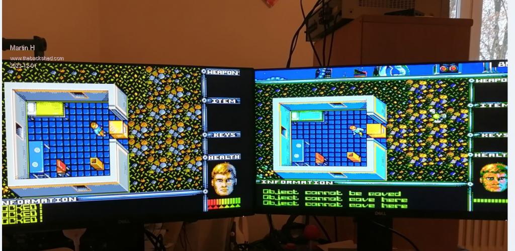

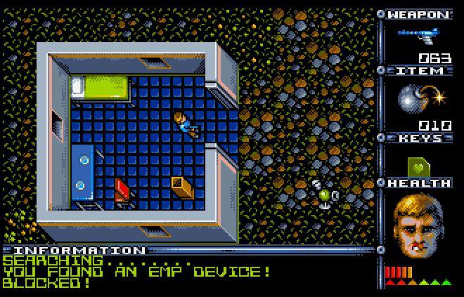

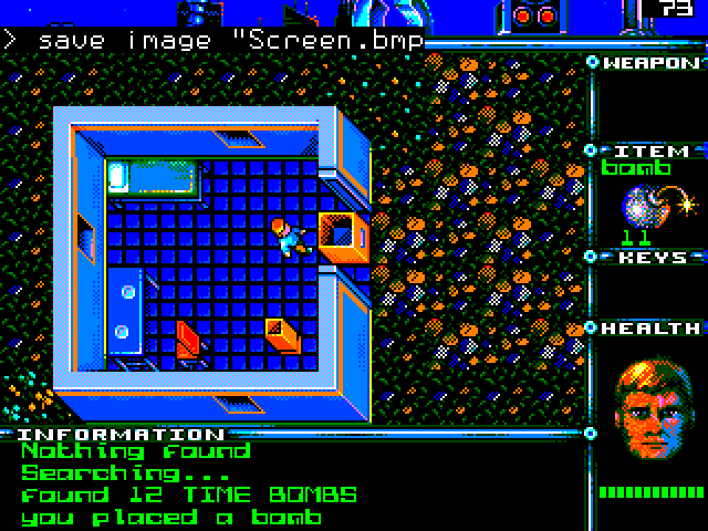

You can block your own path by placing boxes in external doors but the same thing happens in the Dos version.
so its not a bug
but There's a slight difference:
In the Dos version, objects in the direct area of the bomb can be destroyed. and you can move on
on Pico they just open and you are stuck .. esc to end the Game

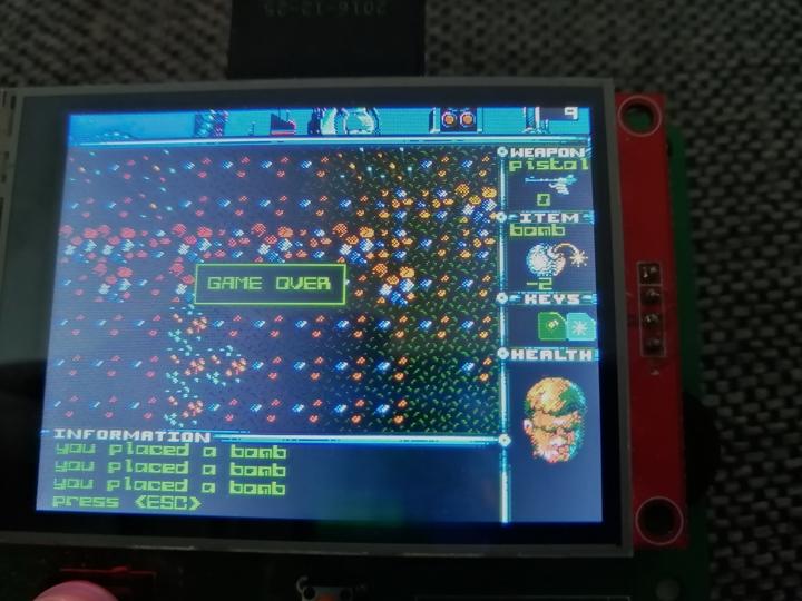

another special feature in the gameplay...
somehow you can have a negative number of Timebombs (and use them)..
Edited 2023-12-02 18:51 by Martin H.

I will look at these. Both should be easy to fix. I assume the plasma gun would also destroy boxes.

I have taken Tom's version, and fixed the bugs that Martin mentioned.
The Timebomb now can destroy virtually all objects, where as the plasma gun can not.
You cannot use more bombs and magnets than you have.
I left the option open to put a bomb on top of a bot. I like it...
