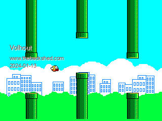

Just a teaser....
It is 10 years ago that flappy bird was taken out of the APP stores because "it was addictive" ....
It is far from finished... so patience....

Here is the first version of the flappy bird game for picomite VGA.
It took met almost 6 hours to complete. Most of it in graphics design.
SPRED102 is your best friend, as is MS PAINT.
Game mechanics
- you control the bird with the space bar, that makes the bird fly higher
- avoid hitting the pipes
- just try to get as far as you can
known issues:
- the game ending does not show the score board and the medals, it just stops
- there are no sound effects yet, only the music.
- collision detection is not perfect.
to do list
- game ending and medals
- LCD version
- controllers.
Have fun playing....
flappy7.zip
Unzip all...
RUN "FLAPPY7.BAS"
P.S. if you find it difficult to play, change line 76 "v=-8" to "v=-7"
