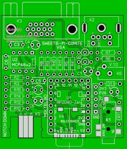

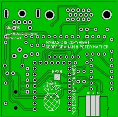

*UNTESTED* - HERE BE DRAGONS!
This uses Peter's facility to move the VGA pins to good advantage. It allows VGA output from a RP2040-Zero for the first time.
I wonder if, as the PCB is only 50mm square, this might be a contender for the smallest fully user programmable games console? :)
Sorry, no RTC on this one (not enough space), but it has got an expansion port.
GP28 (on the above) is, by default, used to detect a WII controller. If GP28 is high then a controller is plugged in and is the correct way up. There should be no damage if the controller is plugged in upside down as the supply is disconnected with this design. GP28 can be isolated from the WII connector via a solder blob link.

Love it--so compact. 50mm--does that mean it can be panelized 4 to a PCB?
What a great instructional tool this would be for a teacher who wasn't afraid to have pupils soldering (or for an after-class club). Tiny--but with MMBasic, incredibly powerful. If panelizable, 20 PCBs for under $5.

You could only get two out of a 100x100 board because you have to allow for some waste edges for the machine to grip. Because of the cutting out for the WII socket it might make panelization rather more expensive than buying individual boards, although using two to a panel and putting the WII sockets opposite to each other on the non-grip edges would be fine.
If you were going to use it as an educational device then it might be better to get the microSD hard holder pre-mounted at least. They are fiddly to solder. Incidentally, I use that type because it will fit!

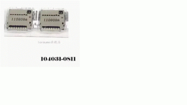

My preference is certainly for the 6-pin micro SD module--far easier to solder, and 5 cost less than one of the sockets on this board (at Digikey). But space is at a premium.

The 104031-0811 sockets are currently £3.38 + postage & VAT for 10 from AE. Not very expensive, just a little fiddly. I bought 20 a while ago as I decided to try to minimize dependency on ready built modules.

Can you provide a link? I've bought 2 sets which are wrong. The ones I'm finding now have a width of 14+mm, whereas the ones with that part number on Digikey appear to be 11.8mm.

see if this works.
The number printed on each socket is 131117A and the bag they came in is labelled 10431 0811. They are 12mm wide.
They look like the ones in the official drawing on Mouser's site, right down to the hole punching. They say they are 11.95mm wide, but my ruler isn't that accurate. :)

  Mixtel90 said  see if this works.
Thanks. I did not see any imprinted with 131117A, but I ordered this one

They look like they might be the ones. They are all made in China anyway. :)
Yep, I like the 'Zero. It seems to be rock solid running MMBasic. You get less GPx pins, but that's the point - you don't have them going to waste. :) Having a Reset button and WS2812B LED are nice icing on the cake. There are a couple of minor disadvantages though, RUN and 3V3EN aren't available on pins. The latter is useful because it can be used as an on/off switch. The regulator has the necessary enable input too. Of course, breadboard compatibility has had to go but you can develop on a standerd Pico and transfer stuff over.
I realized - if you arrange these boards on a 100x100 with the WII connectors outwards you can get 4 to a board providing you cut them up yourself. Having the VGA & PS2 connectors to the middle allows for the width of the cutting blade as this dimension is non-critical (at least to a mm or two). If you want JLC to panelize them then you will need a longer board and the price will go up. They now charge for panelizing anyway I think.

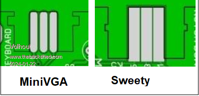

I have build few of your VGA board with the board edge WII connector, and before you release this one you may be able to "tune" the board edge connector a bit.
1/ the cutouts for the locks can be smaller and the edge facing outward can be 0.5mm more inward (when locked, the connector can still be pushed 1mm more inward). Tested this with a nunchuck and my (finally arrived) classic controller.
2/ the locks just "barely" lock. It is absolutely possible to push in the connector at 15 degrees, where only 1 lock locks. Maybe the edges that have the lock cutouts can be brought closer together to force the connector alignment.
I am not sure how much of this is due to JLC tollerances. Maybe you could check your board dimensions with the WII connectors (I assume you received these already).

Thanks for the info. I'll have another look at the connector. I didn't have any official connectors when I drew the SL6 macro.
TBH I hate that arrangement and I'd much rather use anything else with the necessary four pins. Even Duponts.
The locking system is excellent when used with the matching PCB connector, but unfortunately it's a struggle to get those. I'm doubtful if they are even being manufactured now - we may be seeing old stock as they only appear to be used as spares for WII controllers. The last of those was made over 10 years ago!
I'm currently intending to use the official connectors on PicoGAME 4 but only because I'll get moaned at if I expect people to make adapters or change the lead for one with a RJ12 6P4C on it.

I've re-done the WII connector to a tighter tolerance after measuring the proper things. I'm doing a circuit diagram too.
JLCPCB appear to do 4 to a 100x100mm board, separated by screen printed lines only, for their usual $2 special price. If I've understood it right, it's $7.80 if you want them V grooved. I'm not certain that I've got it right though. :)
