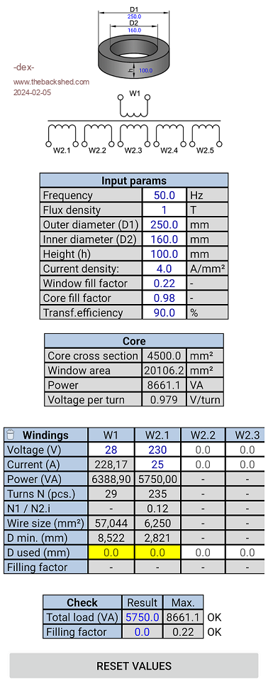

We have here 230V 50Hz as standard.
I have checked these values in other calculator and looks like below.
It takes into account the current density proposed by Solar Mike at 4A/mm2.
The initial value suggested by the calc is 2.4A/mm2. Decreasing this value lowers the available power score.

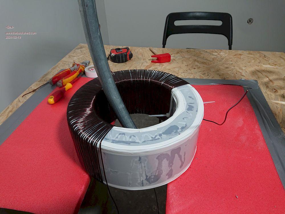

Finally, I decided to stay with ~1T. I have prepared a winding wheel and a stand, now I'm going to finish the first layer. The core was insulated with a sheet of 0.19mm Mylar foil and the corners with tape.
Taking into account the advice of others regarding the hardness of the wire and sore fingers, I used 1.8 mm, but I see that I could work with a slightly thicker 2.0-2.2.

That is looking good Dex and I like that the core has nicely chamfered edges. Is the core a "standard" part that you bought  ...  or did they wind it to your request?
I used 1.8mm wire and did wonder just how much harder 2mm would have been. I have used 2mm on some motor cycle coils many years ago and they were hard to wind being relatively small and fiddly  ...  but these big toroids are heavy enough to stay in place while we pull and stretch the wire around. I would not be afraid to try 2mm or maybe even 2.5mm.

-dex-
Joined: 11/01/2024
Location: Poland
Posts: 104
Posted: 12:26pm 19 Feb 2024

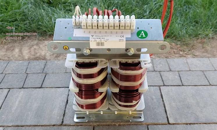

Thanks. The steel core was wound for my request.
The weight and price increase with the wire diameter. Unfortunately, I had to buy this copper wire, but for the primary winding I have a large U-shaped transformer with a thick wires. I'll diasemblly them and then I just need to find a way to straighten this bent wire.

Wow, that is a very nice supply of wire on that transformer.
I'm not sure how others would do it  ...  but I would anchor one end and wind it out  ...  then I would go along and use my thumbs to bend it as straight as I could get it. Unless I absolutely had to, I would not use any mechanical tools in the process as I'd be too worried I might damage the enamel.
And it doesn't seem to have any severe bends  ...  except maybe all the way inside  ...  so I would be hopeful it will be relatively easy to do.
I know some would stretch it tightly  ...  which does help a little  ...  but I don't know if that does any damage. But by the time you've wound the secondary, you should be able to accommodate some imperfections in your primary.
I was surprised at the hole size of your toroid  ...  it seemed very large. At least you shouldn't run out of room for your primary.

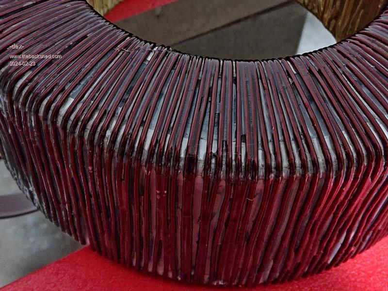

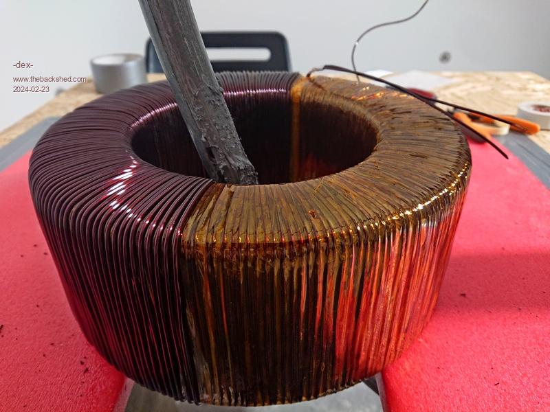

I took a closer look at this large U-shaped transformer and it turned out to be an aluminum winding    I have to find another one.
The first winding was covered with varnish and then wrapped twice with thin Kapton tape. I put quite a lot of it because the gaps are quite large, it takes a long time to dry, but I think it is enough to stiffen it.
Now I winding the second layer. The target is 223 turns per layer
