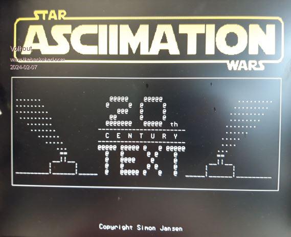

Posts: 6037
Posted: 09:25pm 06 Feb 2024
All,
find attached ZIP file.
It contains the start wars movie, and a test file called "rick_roll.txt"
In it is a file compressor "compress.bas" based on only adding different lines.
it compresses the 95kb file "rick_roll.txt" to 34kb file "rick_roll_c.txt"
in the ZIP is also a player "player.bas" for the compressed file.
This works in MMB4W. Tested on the rick_roll.txt file that is 13 lines x 68 characters video window.
The programs are a little more complex than I expected since MMB4W removes leading <SPACE> characters in a string when reading from a file when using INPUT #1,a$
The player cannot play uncompressed files.
No guarantee for this set of programs, use at your own risk...

homa
Joined: 05/11/2021
Posts: 668
Posted: 10:20pm 06 Feb 2024
Not bad! Thanks for that. BUT where is the sound? ;-)
I tested it on a PicoMiteVGA.
It's still a bit rough compared to the original ...
Pause t*50 'previous time
and changing the timers only helps to a limited extent ... then the text becomes too fast ...
I have attached the sw1_c.txt.
sw1_c.zip

Posts: 6037
Posted: 08:52am 07 Feb 2024
For the PicoMiteVGA users...
Here is the movie player and movie for PicoMiteVGA.
The size will fit on the A: drive of a PicoMiteVGA, but it runs just as well from the SD card.
UNzip, and run "player.bas"
If needed change the variable "fps" to your desired speed.
Have fun.

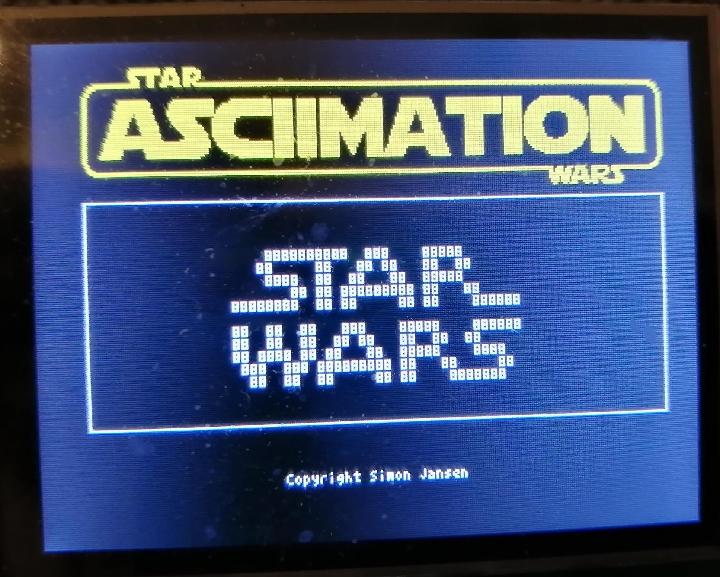

btw .. with Font 8 the Game*mite is also able to play the Movie
Edited 2024-02-08 04:06 by Martin H.

Here is my version adapted for Game*Mite
GameMite.zip
copy both files in the SW1 Folder and start the GM_Player.bas
Edited 2024-02-08 04:38 by Martin H.

Posts: 4392
Posted: 07:05pm 07 Feb 2024
I've seen this before, but it's awesome to have it on the Game*Mite.
These changes to the player help it find the assets, though you do have to start it with RUN rather than through the EDITor (because that doesn't set the path):
'ascii movie player for compressed (indexed) files
'Game*Mite Version
Option default integer
Font 8
'open "sw1_c.txt" for input as #1
Open MM.Info(Path) + "sw1_c.txt" For input As #1 ' < ----
