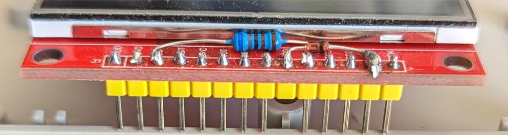

Does this screen still need the resistor diode mod to get it working properly, can someone point me to a definitive version of how to connect up this mod, a simple circuit diagram showing resistor & diode & what pins to connect to will be fine.
Regards Kevin.
Posts: 12010
Posted: 10:36am 15 Mar 2024
Thing to remember about the ili9488.
1. They are slow
2. You need an extra resistor and diode to get reliable reading
3. They are slow
4. They are too big for both a framebuffer and a layer buffer to fit in memory
5. They are slow
Reasons:
The ILI9488 controller has a bug where it doesn't tri-state MISO properly hence 2
The ILI9488 does not support 16-bit RGB565 over SPI so all writes and all reads are 3 bytes per pixel
The ILI9488 needs a much slower clock for reading pixels than any other display
They only support H/W scrolling in portrait mode so use for a console is terrible. It takes about 1 second to scroll a line of text up the screen
They have 2x the pixels of an ILI9341 and need 3 bytes per pixel vs 2 so things like CLS take 3x longer than on an ILI9341
Wiring mod
Edited 2024-03-15 20:45 by matherp

Hi Peter,
I realise they are slow, :-( I want to use one as a console on a Picomite USB I like the 340x480 space, but it appears this is the only display of that resolution that can be used as a console, now that the 9481 is disabled, it looks like scrolling is very slow, but page up/down not too bsd, so I'll have to train myself to mainly use that.
Thank you for the photo of the mod, that looks very simple.
Regards Kevin.

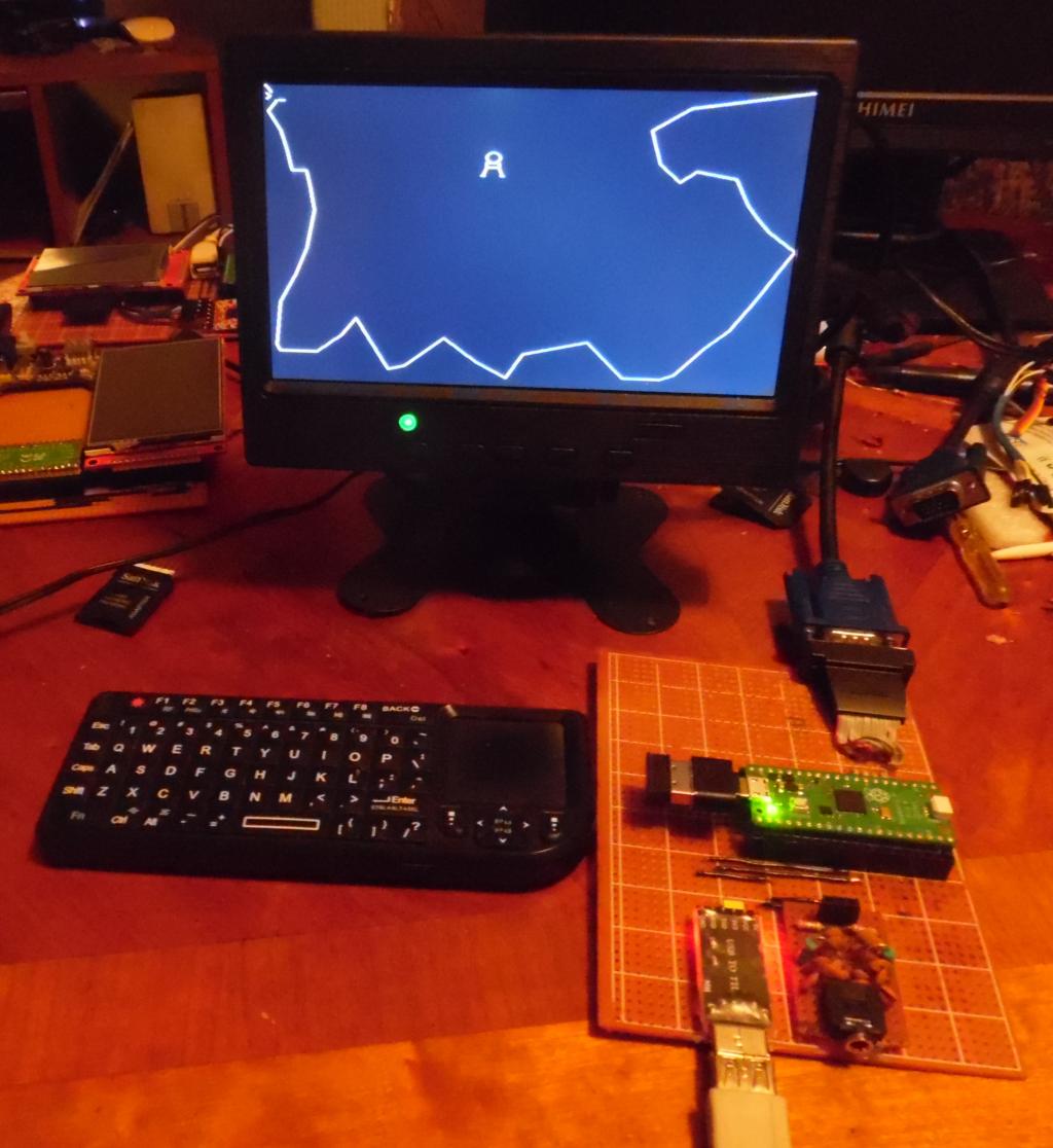

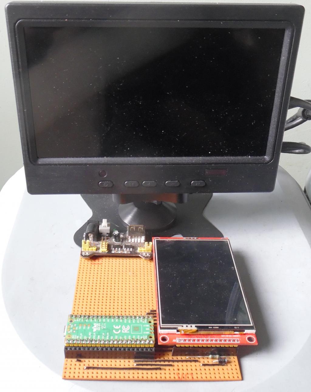

Posts: 2807
Posted: 02:08pm 15 Mar 2024
Kevin, don't want to digress but these 7 inch displays I paid £12.50 for. Sold as car reversing monitor. got hdmi, vga and composite video... not avi as advertised- no audio- no speakers. says 5V to 24V supply but need 2A 5V. 12V 1A ok
vga 640x480 and pico is readable and scrolls as vga does. uses little space.
use with a small usb keyboard makes a small system.. no touch screen or sd card slot though. just a suggestion. stan

Posts: 2807
Posted: 08:43pm 15 Mar 2024
  Bleep said  Ok thanks Peter, it looks like I'll have to try to build one of your 1963 parallel USB boards, or find a nice small bare VGA display to use with a VGA USB board.
Regards Kevin.
these vga displays are take to bits able but why. the base is standard tripod mount.
small case border
