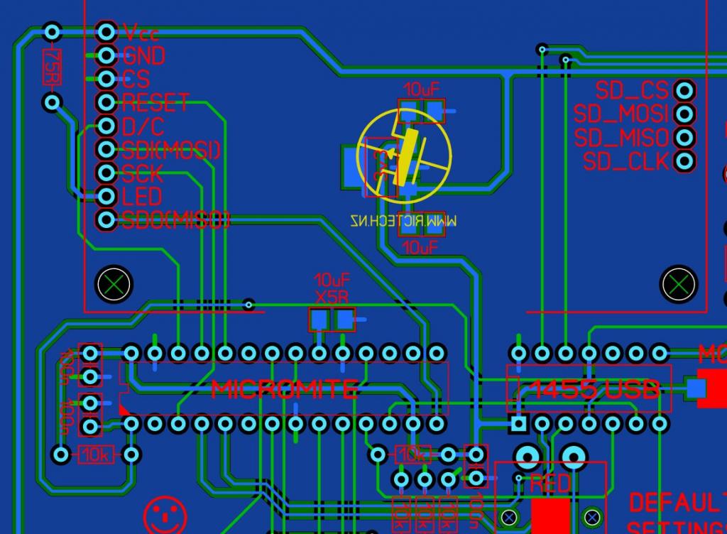

THIS one has me totally confused.
I designed a PCB to use a 9341 SPI LCD coupled to a 170 MM2 chip, and that board worked fine - so did the LCD.
I then redesigned the board to allow for an extra button, BUT the layout to the LCD remained EXACTLY the same as the old board, but the LCD won't work in the new PCB.
All I get, is a bright-white LCD, but it never seems to initalize.
If I take the LCD and the MM2 chip, and plop them back in the OLD board, everything works just fine.
Now, I know what most of you are already thinking at this point - the PCB is bad or has a disconnection on one of the tracks between the LCD and the MM2 chip.
NO, IT DOES NOT!
I have traced out all lines between the LCD and the MM2 chip, DIRECTLY on top of the LCD, and on the top of the pins of the MM2, so that this also tests the connections in the sockets for the LCD, and also the IC socket for the MM2 chip - ALL signal lines are intact, and zero ohms.  None are a high resistance or anything like that, they are ALL there, where they should be.
I tried a couple of different LCD modules on the NEW board - they WON'T work, but they WILL work in the old board.
I'm out of ideas at this point, as it does not seem to be the LCD, the MM2 chip, the PCB tracks OR the connectors for the LCD and the socket for the MM2.
Electrically, it traces out as exactly the same as the one that DOES work, but it will NOT work on the new board.
I'm now left scratching my head, as I cannot work out what the hell is going on here.....
Here is an image of the relevant part of the PCB layout:

About the only thing I can now think of to test, is that we have one or more lines between the MM2 chip and the LCD, that are shorted to ground(or each other) or something, so I will test for that next.
There HAS to be a reason.....

I've now checked the LCD sockets - just pulled up and off the plastic insulator thing, leaving just the pins soldered in the board.  No shorting going on in there, everything looks fine.  Put the plastic insulator thing-y's back on.
I then used my multimeter(on diode-test, which only allows a forward current of about 1mA or so) to test all the pins.  NOTHING is shorted out between pins, none of the SPI lines are shorted to ground or supply or each-other.
Everything is PERFECT.....but it won't work in this PCB, which as far as the LCD setup is concerned, is exactly the same as the old board.  Put the MM2 and the exact same LCD module back in the old board - the LCD works just fine.
I really don't understand this, and I was actually hoping to find a shorted pin(or pins) on either the LCD socket or the IC socket.
I also tested with both the LCD and the MM2 chip OUT of the board, so I could rule out any kind of parasitic thing perhaps spoiling the results - no error found.
If it WAS just a touchy LCD module, you'd expect another LCD to work then, woulden't you, but nope.
ANd it's not like this is my first LCD - I've lost track of how many of the SPI LCD modules I have used in various things, so......brain overload....

Looking at the default backpack schematics:
LCD   MicroMite     Your board
SDO------14-------------14
SCK------25-------------25
SDI------3--------------3
D/C------2--------------26
RESET----23-------------24
CS-------6--------------GND
Is this (D/C and RESET) correctly reflected in the OPTION LCDPANEL settings ?
Can you put CS low permanent ?
There is a not in Geoff's manual. The CPUSPEED must be set to 20MHz or greater.
What voltage regulator are you using. The 1117's do not have GND in the centre pin. Are you using a 1264 ?
Edited 2024-04-18 18:02 by Volhout

MM2 manual, page 18, says that you can use any free pins for D/C and RESET, and CS is permanently connected to ground, so the LCD is always enabled.
VR is old faithful MCP1703A-33.  I've used hundreds of those, and you can suck up to 200mA out of them, but this circuit is way below that, and the LED backlight is connected via it's resistor to 5v, so it is not a load on the VR.

Cut MISO track, added 10k pullup to pin 14, added 100uF across LCD.
No change in behaviour.
Backlight only, no LCD activity.
Anything else I can try?

Setup an ILI9341 on a breadboard following your PCB tracks.
> Micromite MKII MMBasic Ver 5.05.05
Copyright 2011-2022 Geoff Graham
> GUI TEST LCDPANEL
> OPTION LIST
OPTION BAUDRATE 115200
OPTION LCDPANEL ILI9341, RLANDSCAPE, 26, 24, 0
And it works. Tried to make it fail by wiggling the jumpers. The only one that was touchy was Reset. Seems quite sensitive to noise so make sure you have 3.3V on the LCD panel Reset pin.
Maybe worth soldering a 10nF cap from Reset to Gnd. on top of the panel pins to ensure it has a clean 3.3V.
