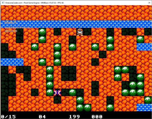

Here is the version with working routines for butterflies and fireflies.
The zip file only has the basic program, so the folder structure and files from the first upload are needed.
Now all that is missing is a proper framework( Menus , Gameover etc.)
Then the enemies will also be set to deadly.
GNR-Beta2.zip
have Fun

I'm still on Beta 1, here is what MMB4L currently makes of it https://youtu.be/wP7mwUbPs1Q.
I'm assuming the trail when I move the player is some MMB4L bug, not a program bug ?
On a related matter can someone point me at some example data for *uncompressed* memory sprites.
Edited 2024-05-16 05:14 by thwill

  thwill said  Hi guys,
Hi Tom
Nice but much to fast
The trail is not on the mites, as I fill the cell of the map array with "0" when the player left the cell. The screen is completely redrawn with each run (like in PetsciiRobots), so only the background should be displayed in the places where the player was.Looks like you dont refresh the whole Screen.
but the MMB4L looks very promising
I have to go to sleep now, I will zip the Spr Files tomorow

Posts: 4405
Posted: 09:36pm 15 May 2024
  Martin H. said  The trail is not on the mites, as I fill the cell of the map array with "0" when the player left the cell. The screen is completely redrawn with each run (like in PetsciiRobots), so only the background should be displayed in the places where the player was.Looks like you dont refresh the whole Screen.
Slaps own head.
Well figuring that out was fun ...
... I hadn't noticed that some of the sprites were uncompressed ... and I hadn't written the code to render uncompressed sprites, which is why I was asking for examples.
D'Oh!
Edited 2024-05-16 07:41 by thwill
