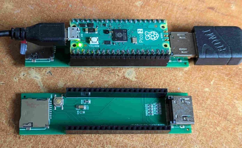

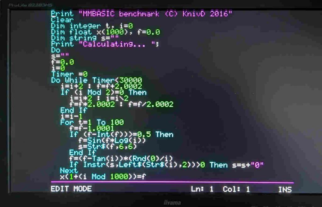

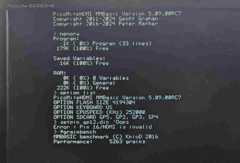

Posts: 12176
Posted: 02:53pm 20 Aug 2024
Progress
NB: as discussed elsewhere GP12 to GP19 are not available as these are dedicated to the HSTX peripheral and can't be changed. CPU speed is fixed at 252MHz. The HSTX peripheral can only run at power-of-2 multiples of the CPU speed.
To get this to work I've disabled tiles and other small bits and still haven't enabled the extra pins on the 80-pin chip or implemented the other graphics modes yet so still a fair bit to do.
The underlying graphics will be 640x480x15bits running RGB555. This keeps the bus bandwidth to half of RGB888 and still allows 32 true grey scale levels if that is the sort of thing you want
Running on my little HDMI adapter board GBP20 for 5 fully built from JLC
Gerber_PCB1_2024-08-20.zip
BOM_Board1_PCB1_2024-08-20.zip
Image quality is excellent, here editing in mode 2
Edited 2024-08-21 01:03 by matherp

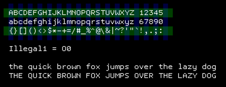

Posts: 2556
Posted: 05:41pm 20 Aug 2024
hi Peter,
   moving to DVI could be a good opportunity to also upgrade the font used in the editor. have a look here:
http://www.fial.com/~scott/tamsyn-font/
there is an 8x15 version of this font, where (most) characters are 6-pixels wide (ie, 2 pixel spacing between letters). this makes text far more readable than the current 7-pixel width (with just a single pixel between letters). there are also proper descenders!
rob   :-)
Edited 2024-08-21 03:43 by robert.rozee
Footnote added 2024-08-21 18:23 by robert.rozee
see also:
https://github.com/sunaku/tamzen-font/tree/master
for another version derived from Scott Fial's work. there are also 7-pixel wide versions that could be widened (by the addition of an extra column of blank pixels) that look extremely good.
