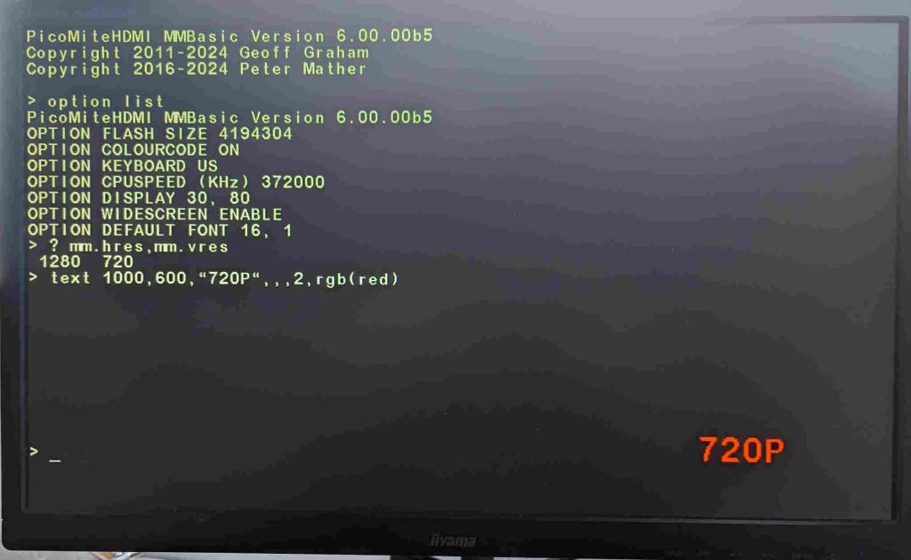

Posted: 02:42pm 06 Sep 2024
Download from here
Use
OPTION WIDESCREEN ON/OFF or ENABLE/DISABLE to switch to 1280x720 720P mode
MODE 1 ' 1280x720x2-colours with RGB332 tiles (use the TILE command as normal)
MODE 2 ' 320x180x16colours with optional layer (no memory usage) and colour mapping to RGB332 palette
MODE 3:' 640x360x16 colours with optional layer (significant memory usage) and colour mapping to RGB332 palette
Default font for mode 1 is 3 which is now 16x24
Default font for mode 2 is 7
Default font for 3 is 1
and if you want to edit in more detail

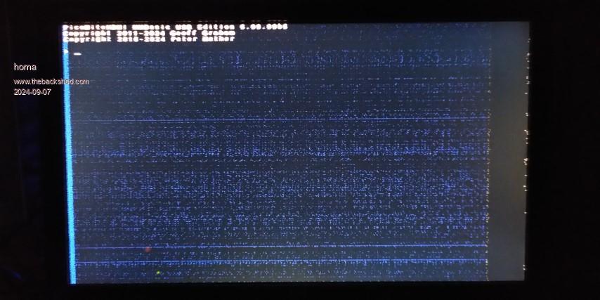

Too bad, it doesn't work for me (720p, all modes), even though it's a full HD monitor (HP 2309m) with DVI input.

I've checked it both normal and USB versions using a bog standard 1080p monitor. I've also checked the signals on the scope and the clock timing is pretty much perfect.
720P is a TV standard rather than a normal monitor standard but is the only widescreen mode that has a clock speed in range of the RP2350 - 371.25MHz (rounded to 372MHz - 0.2% error). My monitor is perfectly happy with a 375MHz clock speed so I don't think the trivial error is the issue - the advantage of a clocked system unlike VGA.
Are you using  270 ohm series resistors on all lines? My tests are using my little I/F board and the Olimex board. In both case the signal lines form the Pico2 to the HDMI socket are very short. At 372MHz signal integrity is likely to be an issue if breadboarded.

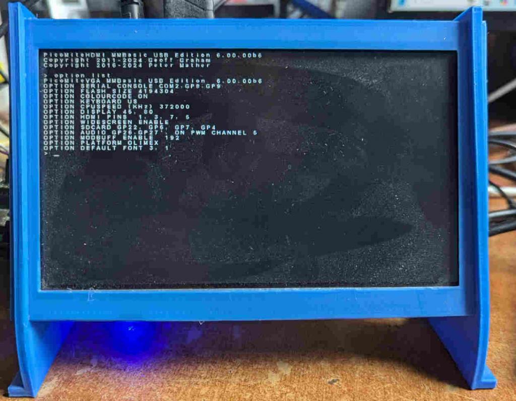

Even works on one of the little 800x480 displays with the multi-input adapter board

Posted: 04:37pm 06 Sep 2024
it works on my tv :-) but that's not a permanent option.
I'm about to switch from the dvi input to the hdmi on the monitor ... but I'm afraid that won't work.
What I noticed: in mode 3 and then “files” changes the font?! that looks strange.
Otherwise good job!
Switching between widescreen on/off is only possible via OPTION? I tried it in a small test program. The first switch works, but then the program is closed, right?

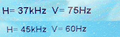

As feared, no improvement at the other entrance. This shows the OSD info normal 4:3 vs 720p:
