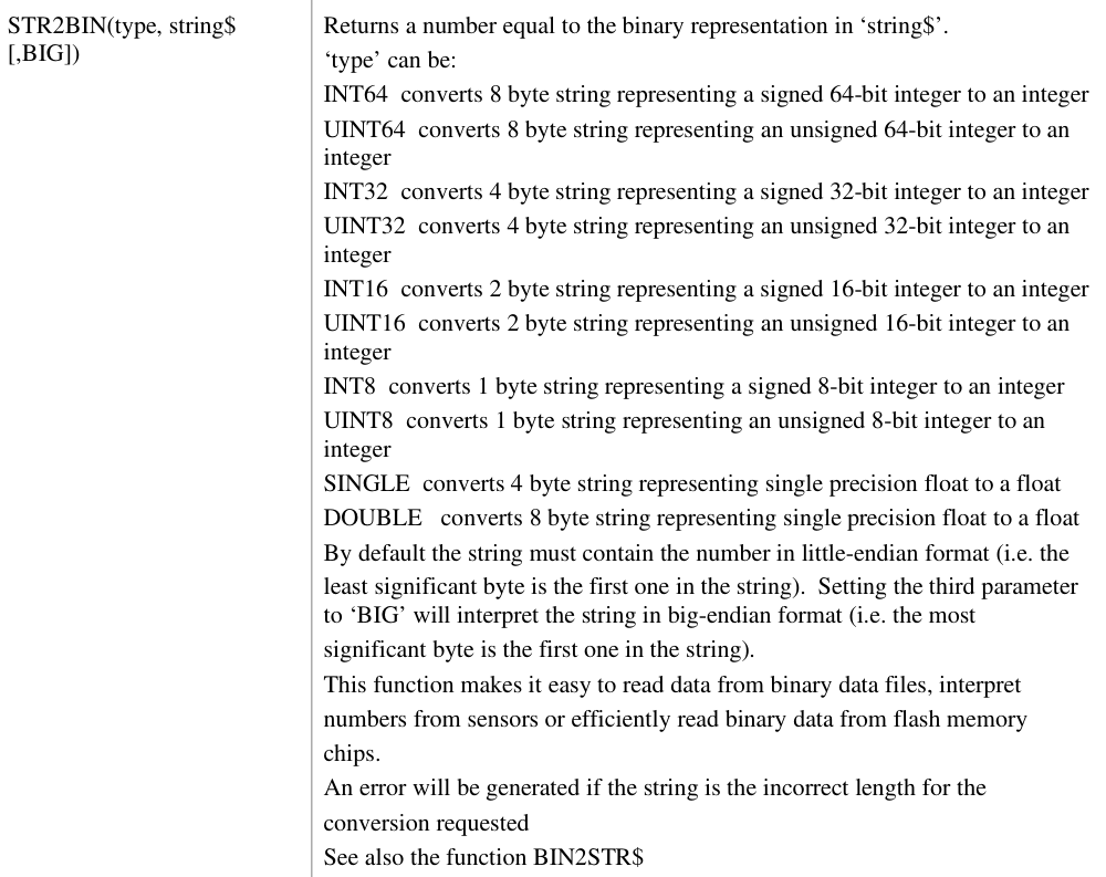

I have a vague (and probably wrong) idea that someone used LONGSTRING to do it.
  manual said  LONGSTRING PRINT [#n,] src%()
Prints the longstring stored in ‘src%()’ to the file or COM port opened as ‘#n’.
If ‘#n’ is not specified the output will be sent to the console.

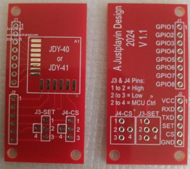

If anyone is interested, here is a breakout board I created for the JDY-40/41 modules.  Be kind... It is the first PCB I ever designed. 😲
JDY-40 41 Breakout - V1.1.zip
--Curtis

Justplayin
Joined: 31/01/2014
Posts: 330
Posted: 05:33pm 24 Oct 2024
@Mixtel90
I liked your design and had an order of boards made. However, the pin header holes were the size of vias making them useless.  Don't know if it was a manufacturing error or a design error. That was what inspired me try and design my own board.
--Curtis
Posts: 9038
Posted: 05:48pm 24 Oct 2024
Ah...The holes were 0.72mm dia. Too small for male headers, as you noticed. :) At that time I used 0.6mm diameter wire (the silver plated copper crafting sort) instead of pin headers as it's kinder to the breadboard. I still do that a fair bit. Unfortunately I keep picking up one particular breadboard that need a hammer to plug anything into it and that bends my skinny wires. :(
I've now added a version to take conventional pins if anyone wants one.
Edited 2024-10-25 03:50 by Mixtel90
Justplayin
Joined: 31/01/2014
Posts: 330
Posted: 06:15pm 24 Oct 2024
Good to know I can stop cursing the PCB manufacturer. 🤪  The positive side is I finally got inspired to learn to use AutoTRAX DEX to create my own PCBs.

Justplayin
Joined: 31/01/2014
Posts: 330
Posted: 11:04am 25 Oct 2024
In order to configure, both SET and CS must be pulled low. Then you can send the 14 bytes needed to properly configure the module. Once configured remove the ground from SET, and CS may need to be set high, low or float depending on the programmed configuration used.
--Curtis
