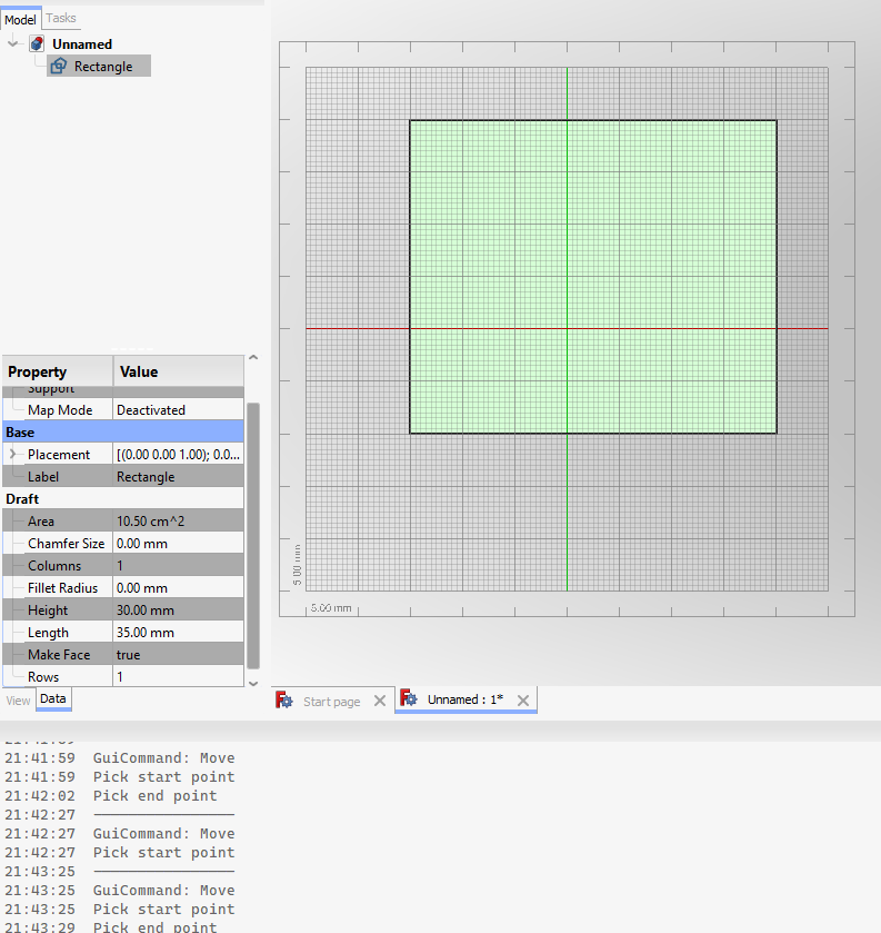

OK, FreeCAD; I just took-to-it like SL6 (think and do) and it exports DXF.

However, I can do everything I need with FreeCAD and I have also linked it up with OpenSCAD. Now I can create any shape I desire for Front Panel Designer

I'll keep plugging away but thus far, I have spent way more time on LibreCAD than I have on FreeCAD but FreeCAD simply works without having to jump through hoops.

PhenixRising
Joined: 07/11/2023
Posts: 2050
Posted: 10:56am 29 Oct 2024
Yeah it installed with a hideous violet workspace and barely any grid contrast.
With it being 3d,the workspace kept rotating all over the place.
Set the theme and figured how to keep it on Top view and plain sailing from there.
