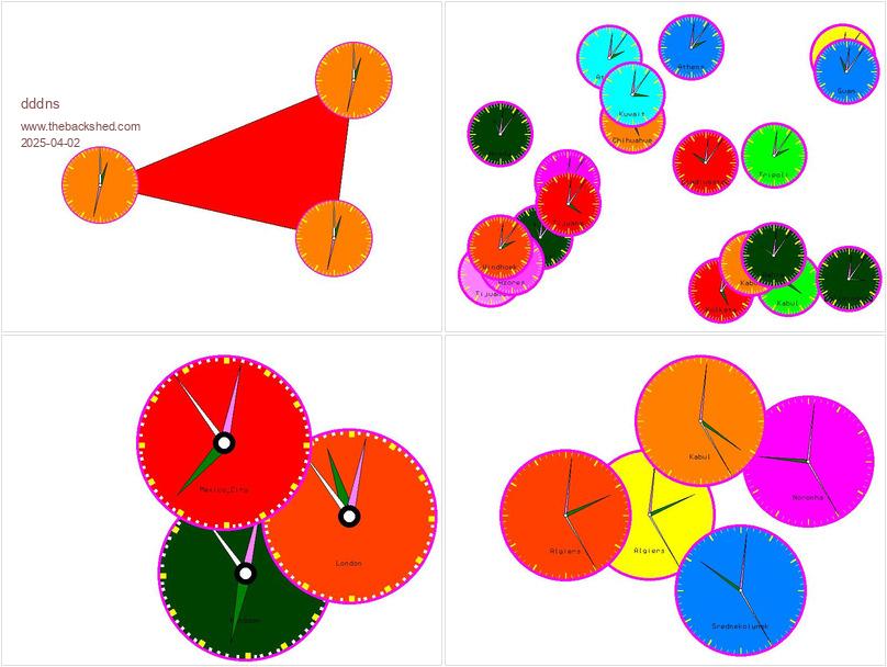

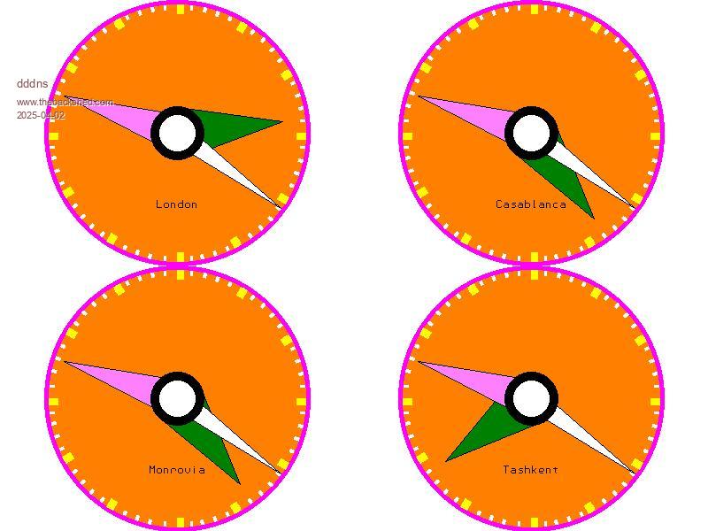

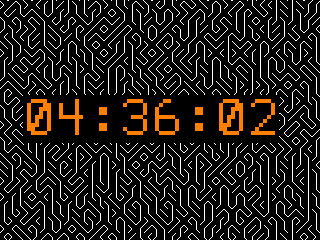

Hello World :))
My first basic program! A few days ago I setup my first VGA PicoMite and was so taken, I couldn't stop. Have fun!
I tried to make really everything configurable and no end of ideas in sight :)
They move, change colours, can be static with favorites etc.. have a look
I tried my best to comment it so everybody can modify it as easy as possible.
VGAclocks_RC1.bas.zip

Const Mode.N=2
Const Font.N=1
Const T.Scale=4
Const T.Size=Len(Time$)
MODE  Mode.N
Const X.Res=MM.HRES,Y.Res=MM.VRES
Font  Font.N
Const X.FSize=MM.Info(FONTWIDTH)
Const Y.FSize=MM.Info(FONTHEIGHT)
Const X.Offset=X.FSize*T.Scale*T.Size\2
Const Y.Offset=Y.FSize*T.Scale\2
Dim integer X.Dir=1,Y.Dir=1
Dim integer X.Pos=MM.HRES\2,Y.Pos=MM.VRES\2
Dim Clr(15)=(0,1,2,3,4,5,6,7,8,9,10,11,12,13,14,15)
Colour Map Clr(),Clr()
FRAMEBUFFER LAYER 0
FRAMEBUFFER WRITE L
Font 9
Print @(0,0);
For n=1 To (X.Res\8)*(Y.Res\8)
 Print Chr$(32+Int(Rnd*3));
Next
Blit READ  1, 0,0,MM.HRES,1
Blit 0,1,0,0,MM.HRES,MM.VRES-1
Blit Write 1, 0,MM.VRES-1
Blit Close 1
Pause 20
FRAMEBUFFER WRITE N
If C=0 Then C=Int(Rnd*15)+1
Text X.Pos,Y.Pos,Time$,"CM",Font.N,T.Scale,Clr(C)
Inc X.Pos,X.Dir:Inc Y.Pos,Y.Dir
If X.Pos-X.Offset<0 Then X.Dir=1
If X.Pos+X.Offset>MM.HRES Then X.Dir=-1
If Y.Pos-Y.Offset<0 Then Y.Dir=1:C=0
If Y.Pos+Y.Offset>MM.VRES Then Y.Dir=-1:C=0
FRAMEBUFFER WRITE L
Loop While Inkey$=""

Posted: 10:25pm 02 Apr 2025
One single object is now possible and favorite font & scale is implemented.
VGAclocks_RC2.bas.zip

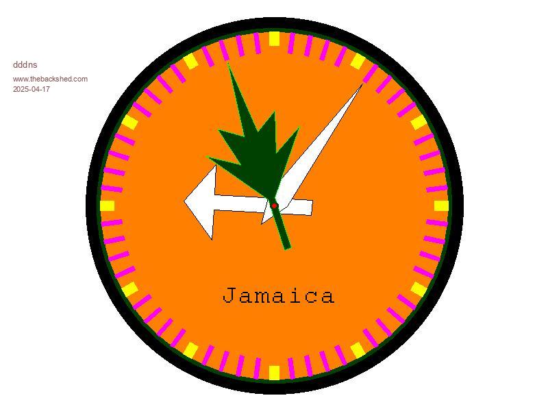

dddns
Joined: 20/09/2024
Posts: 924
Posted: 11:28pm 10 Apr 2025
I never typed that much in my life :)) My lost cost cherry keyboard is lost..the cursor keys
So here it is, my first real MM Basic program. I couldn't comment it yet but I thought somebody might want to play already. I tired my best, it shows a picture..
VGAclocks_V1.bas.zip
have fun :)

dddns
Joined: 20/09/2024
Posts: 924
Posted: 02:58pm 11 Apr 2025
This is VGAclocks Version1
VGAclocksV1RC1.bas.zip
This is a library to draw in a convenient way clock objects.
A clock object consists of parameters stored in a database at the end.
Variables and their content are dynamically created during INIT.

This is noob work. This program is doing three things: parsing the arguments, a "database" and its routines to fill up arrays with mass(mess) data and handing them over to the drawing routine.
Now I think every part has to be reworked and this is more or less brainstorming and by far not finished. I can now turn the page in the manual and rewrite the drawing routine as there are all these fantastic MATH command options I couldn't discover yet. My plan is to even expand the list of variables as e.g the clock hands are anyway a polygon already and I want to make them design able.
In the variable list above only a new variable name needs to be added and the according array will be created and filled up with the content of its correspondent data line label name.
I plan Array(0) of every variable as a buffer..it's not used right now, because the object count starts at 1 and I thought it's more logical to have the array element number according.
Edited 2025-04-12 19:29 by dddns

Hello :)
I am happy for taking the next big step.
VGA_clocks_V1RC4.bas.zip
Everything is drawn with polygon, circle or arc.
Polygon is such a fantastic command and must be written by a genius.
A line drawn with a polygon looks simply the best. You can achieve any possible line width, by simply scaling the coordinates.
So VGAclocks draws objects, which can seamlessly be scaled.
Every and each element that an object consists of can be configured in terms of colour and size. You can initialize up to 30 objects.
The polygon can have up to 16 corners and is individual for every object and for every clock hand.
The minute/second drawing is now also an polygon.
This program in the main loop:

Forgot to say, that I didn't find the time to build sense making coordinates for the clock hands as I am doing nothing but getting the frame done.
dddns
Joined: 20/09/2024
Posts: 924
Posted: 05:09pm 16 Apr 2025
Coordinate section for the clock hands look like this example for the second of the first then objects:

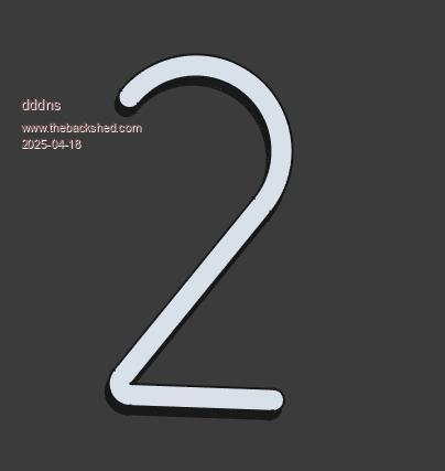

This is how I plan to vectorize the numbers. Very simple and hard coded coordinates.
Number 1 would need 1 polygon and 2 arcs. If you store these numbers in an array, you can scale them with one command.Its calculated 1:1 in 8x12 and it will look brilliant scaled. finally hand this array to polygon. arc radius x scale for linewidth
Edited 2025-04-17 08:14 by dddns

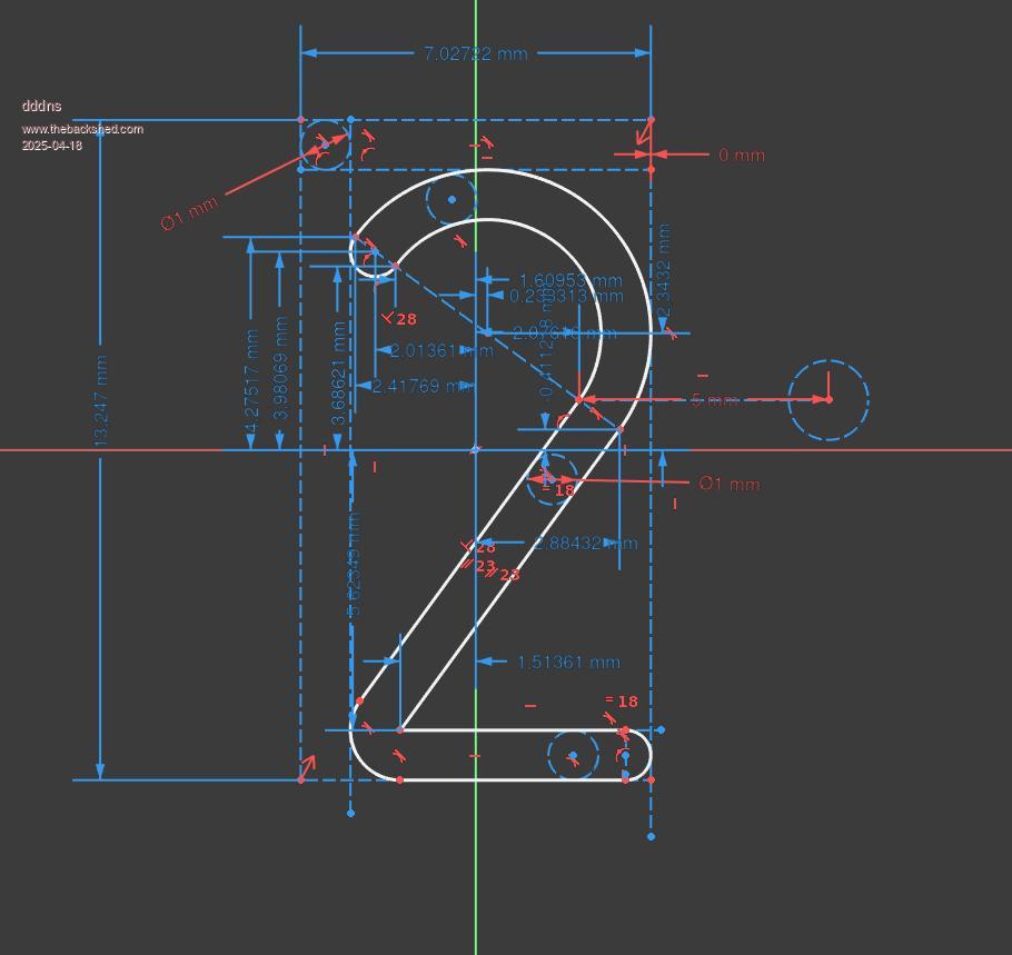

Posted: 12:38pm 17 Apr 2025

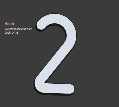

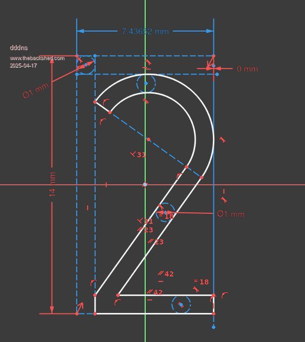

I think this is how its possible to print number 2 with few lines of code scalable and rotatable. Brainstorming work as this is all out of thin air.
Here is an Freecad sketch in which only the red constrains need to be changed and the whole gets scaled. Variables are diameter for line width and upper left for spacing.
The other constrains in this drawing are just geometrical.
freecad.zip

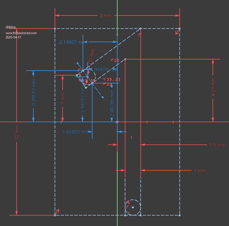

Posted: 02:27pm 17 Apr 2025
This one is nice. Just grab the right circle in the middle with the mouse and you can design the 2 within the constrains and move the center of 2'S arc.
All blue values get updated just in time.
edit: of cause I wanted to say constrainTs!
freecad.zip
with line width = 1
with line width = 2
Edit:Final layout sheet for number 2 with freecad. Its very stable now and doesn't crash freecad at all. You can really freely design the shape now.
freecad.zip
Edited 2025-04-18 01:50 by dddns

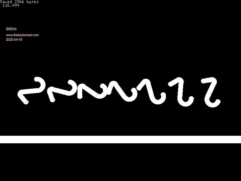

Posted: 04:29am 18 Apr 2025
option explicit
Option angle degrees
Dim integer x = MM.HRES / 2
Dim integer y = MM.VRES / 2
Dim integer arcs_x(3)
Dim integer arcs_y(3)
Dim integer arcR1(3)
Dim integer arcR2(3)
Dim integer arcA1(3)
Dim integer arcA2(3)
Dim integer arct_x(3)
Dim integer arct_y(3)
Dim integer polyt_x(6)
Dim integer polyt_y(6)
Dim integer arc_R1t(3)
Dim integer arc_R2t(3)
Dim integer count,count1,count2
Dim float scale = 1
Dim float angle = 30
arcs_x(0) = 0
arcs_y(0) = -29.5
arcR1(0) = 11
arcR2(0) = 26
arcA1(0) = 302
arcA2(0) = 126
arcs_x(1) = -15.4
arcs_y(1) = -40.4  'upper left
arcR1(1) = 0
arcR2(1) = 7.5
arcA1(1) = 125
arcA2(1) = 304
arcs_x(2) = -7.9 'bottom left
arcs_y(2) = 28.4
arcR1(2) = 0
arcR2(2) = 15
arcA1(2) = 180
arcA2(2) = 314.18
arcs_x(3) = 18.6 'bootom right
arcs_y(3) = 35.8
arcR1(3) = 0
arcR2(3) = 7.5
arcA1(3) = 0
arcA2(3) = 180
Dim float poly_x(6) = (  9.2, 21.6,-7.9,18.6,18.6,-7.9,-20.3) 'from upper left
Dim float poly_y(6) = (-23.3,-14.5,28.3,28.3,43.3,43.3,19.9)'to bottom left clockwise
Timer =0
For x = 100 To 700 Step 100
Inc angle,20
'MATH SCALE in(), scale, out()
Math scale arcR1(), scale, arc_R1t()
Math scale arcR2(), scale, arc_R2t()
Math scale arcs_x(), scale, arct_x()
Math scale arcs_y(), scale, arct_y()
Math scale poly_x(), scale, polyt_x()
Math scale poly_y(), scale, polyt_y()
'MATH ADD in(), num ,out()
Math ADD arct_x(), x, arct_x()
Math ADD arct_y(), y, arct_y()
Math ADD polyt_x(), x ,polyt_x()
Math ADD polyt_y(), y ,polyt_y()
'Math V_ROTATE x, y, a,xin(), yin(), xout(), yout()
Math V_ROTATE x, y, angle, arct_x(), arct_y(), arct_x() , arct_y()
Math V_rotate x, y, angle, polyt_x(), polyt_y(), polyt_x(), polyt_y()
'ARC x,y,r1,[r2],a1,a2[, c]
For count = 0 To 3
 Arc arct_x(count),arct_y(count),arc_R1t(count),arc_R2t(count),arcA1(count)+angle,arcA2(count)+angle
Next count
'POLYGON n, xarray%(),yarray%() [, bordercolour] [,fillcolour]
Polygon 7, polyt_x(), polyt_y(), RGB(white), RGB(white)
Next x
Print Timer
Edited 2025-04-18 14:30 by dddns

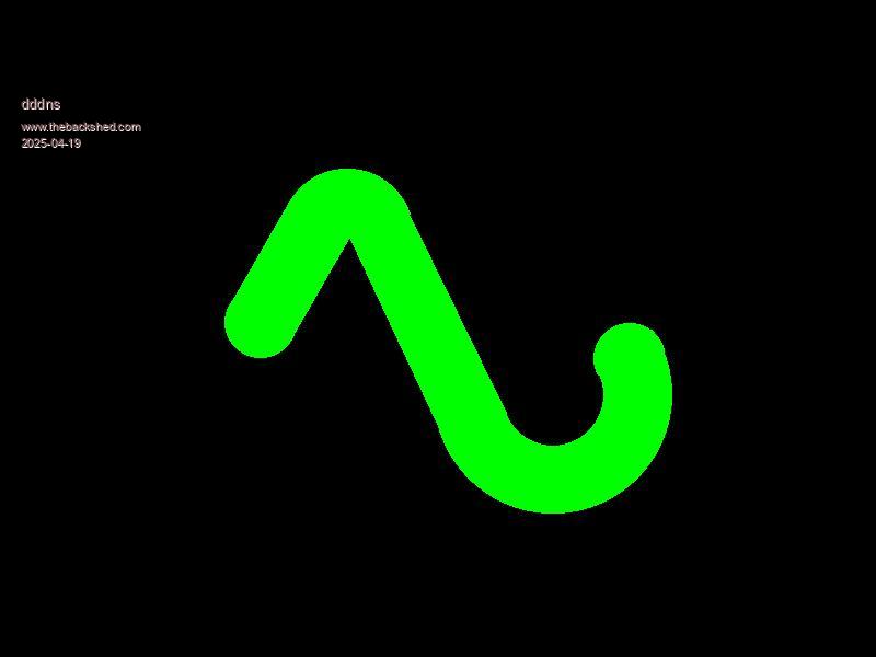

Posted: 06:58pm 18 Apr 2025
Hello :)
I posted the above at 6 in the morning sitting 18 hours non stop in fron of my PC doing that. I must be crazy but I think it was worth it.
MM Basic is so incredible superb I cant find words. Thank you!
This is the skeleton of the library I will use. Have fun let the 2 scroll and scale with your cursor keys :)) Here we go:
