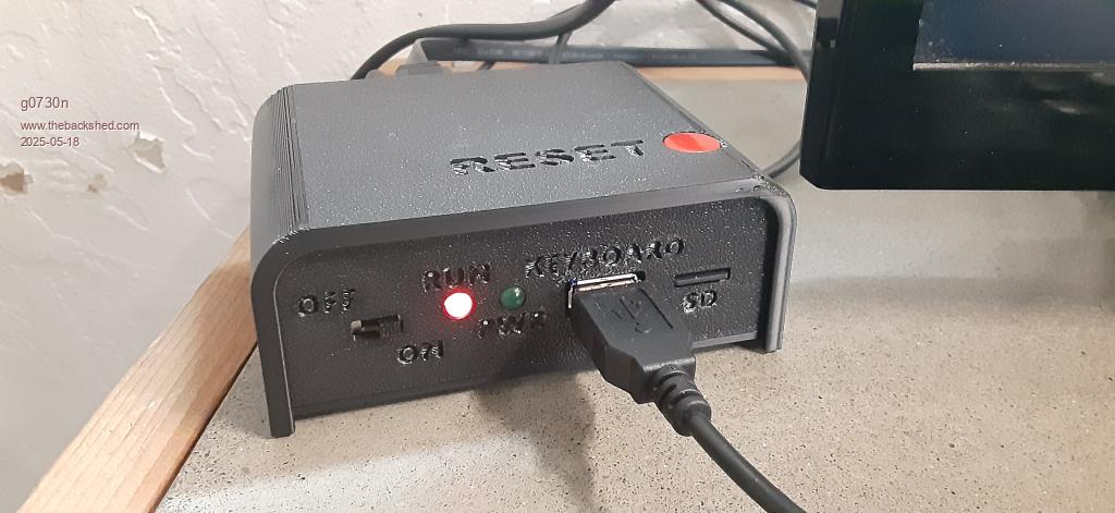

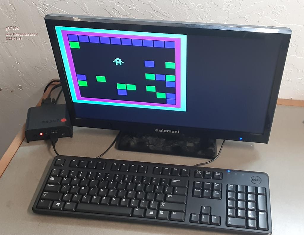

I was able to get an AC adapter for my laptop and printed a case:
And am using a small TV instead of the other monitor. It has USB port in back so powering picomite from that. Turning on/off TV also turns on/off picomite. Plan on printing a VESA mount to attach to back.

Posts: 3884
Posted: 10:27pm 17 May 2025
Very nice, neat job. Looks like a computer.

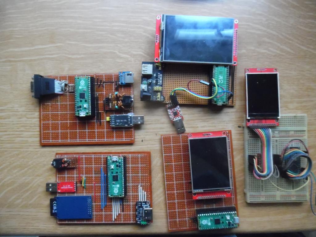

if you start off with no pcb then strip board works

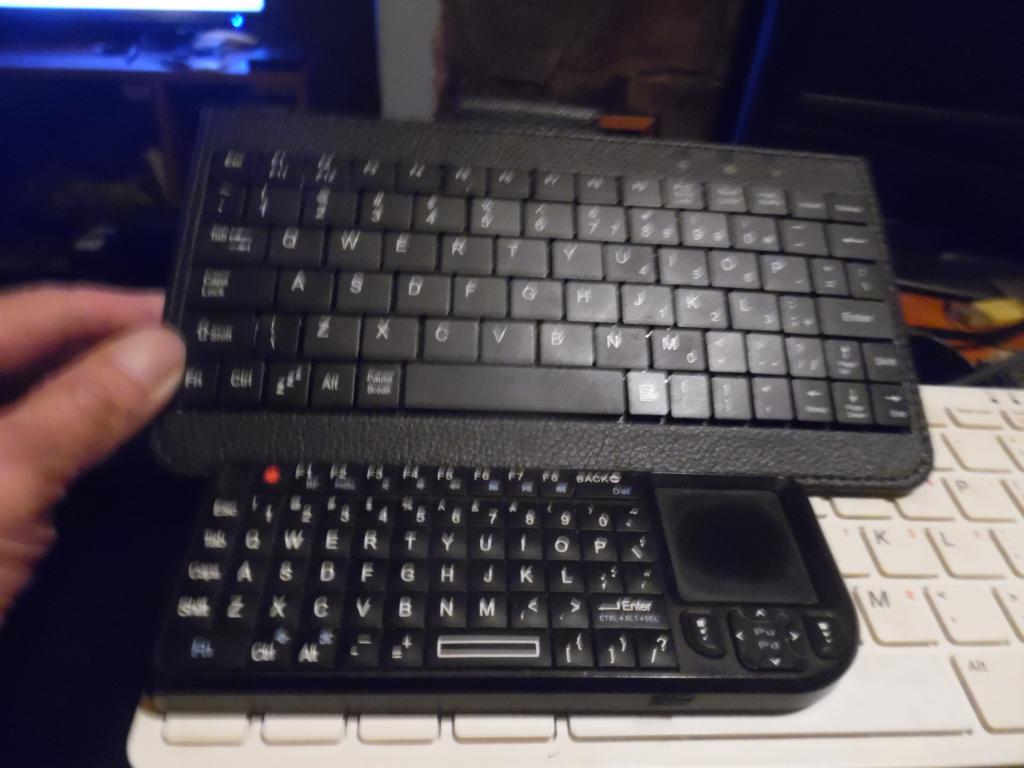

Great collection and very nice done but one type is missing :))
Does your mini keyboard still work??
Edited 2025-05-19 05:46 by dddns
Posts: 2807
Posted: 10:54pm 18 May 2025
I use the hdmi usb and mini usb kb ok and mini wireless dongle kb ok.
just a rant that you need a pcb to use mmb rpi when cheap strip board is quicker??

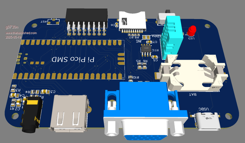

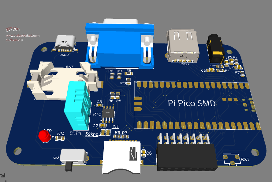

I have started designing a PCB for the next version. I will not finalize and order PCB until I have used the protoboard one for quite some time and have all the quirks figured out. I usually design on EasyEDA, and order PCB JLCPCB. I order the minimum of 5 boards. Ideally I will build all 5 and gift 4 to certain friends of mine who love stuff like this.

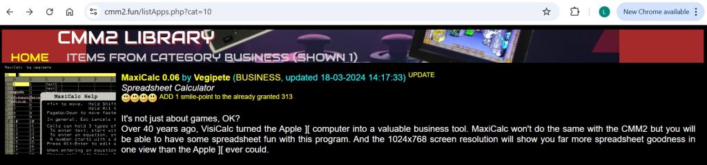

A program I was thinking it would be cool to write for such a computer is a simple spreadsheet program. I use LibreOffice Calc heavily for my business stuff, but also some smaller sheets for personal record keeping. These smaller sheets I think would easily be readable/editable by a lightweight program. Then the possibilities of visualizing the data with MMBasic are endless!

Posts: 2807
Posted: 11:13pm 18 May 2025
rpi pico works well with stripboard.. it's vga and hdmi that don't fit.
same with the board the author of the thread posted

  Quote  A program I was thinking it would be cool to write for such a computer is a simple spreadsheet program.
VegiPete wrote one for the CMM2.
It's shown on the site, CMM2.fun, but the link to the zip file doesn't do anything. VegiPete still posts, so if you're interested in porting it to the PicoMite, you might be able to get the source from him. It probably wouldn't have run well on the early versions of the PicoMite, but possibly could do so now.

Here is my current layout for the PCB version. Was trying to get all cables to plug into one side, and all user interaction (Reset Button, power switch, LED, and SD) on one side. Ended up being slightly larger than originally planned but it's still small
Posts: 3884
Posted: 12:48am 19 May 2025
Very tidy. Do you solder smd yourself, or would you have have JLCPCB do the whole job?
You might want to have the DHT11 socketed, or use a DHT22 or AM2302. People here have reported that the DHT11 humidity sensor very quickly goes out of spec. I think TassyJim regularly bakes his in the oven to reset it (I'm not sure over what period of time or for how long at what temperature). DHT22 may not be much better.

  lizby said  Very tidy. Do you solder smd yourself, or would you have have JLCPCB do the whole job?
I hand Solder the SMD. It is very tedious, but have had success soldering TSSOP and down to 0402 components. If there is enough space I usually choose 0805 for more easy soldering.
I am probably going to ditch the DH11 entirely for the BME280. It is I2C, and the placement on board puts it right next to I2C bus used for RTC. More expensive but way more accurate and also does atmospheric pressure. I wasn't sure if there was any support for it or if I could write my own driver, but looks like someone did it already !
https://www.thebackshed.com/forum/ViewTopic.php?TID=8362
I used DHT11 in current build because I have a handful of them in a box and saw there was already support baked into firmware.

Posts: 3400
Posted: 01:17am 19 May 2025
  Quote  You might want to have the DHT11 socketed
Yes, all humidity sensors require occasional reviving, the DHT11 more so than any other.
Some other humidity sensors have a built-in heater to do that.
For the DHT11 the recommended method it to heat it in dry air at 50°C for at least two hours. This will remove moisture stuck to the sensing surface however other vapors can also stick to it resulting in a false high reading. Removing them may require heating to a higher temperature (70 to 80°C) for much longer.
