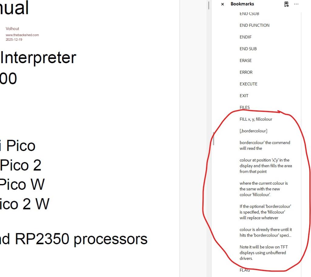

Geoff,
It may be just me, but I find the command list (in several places) is corrupted. Maybe you could confirm this is also shown at your original ? See below picture. This is the user manual that I just downloaded (19/12/25 13:00 CET).

Seems OK to me, though file shows as
Dec 18 20:54 PicoMite_User_Manual.pdf
GMT here.

Command list also corrupted in my user manual. Dated/downloaded 16.12.2025.
