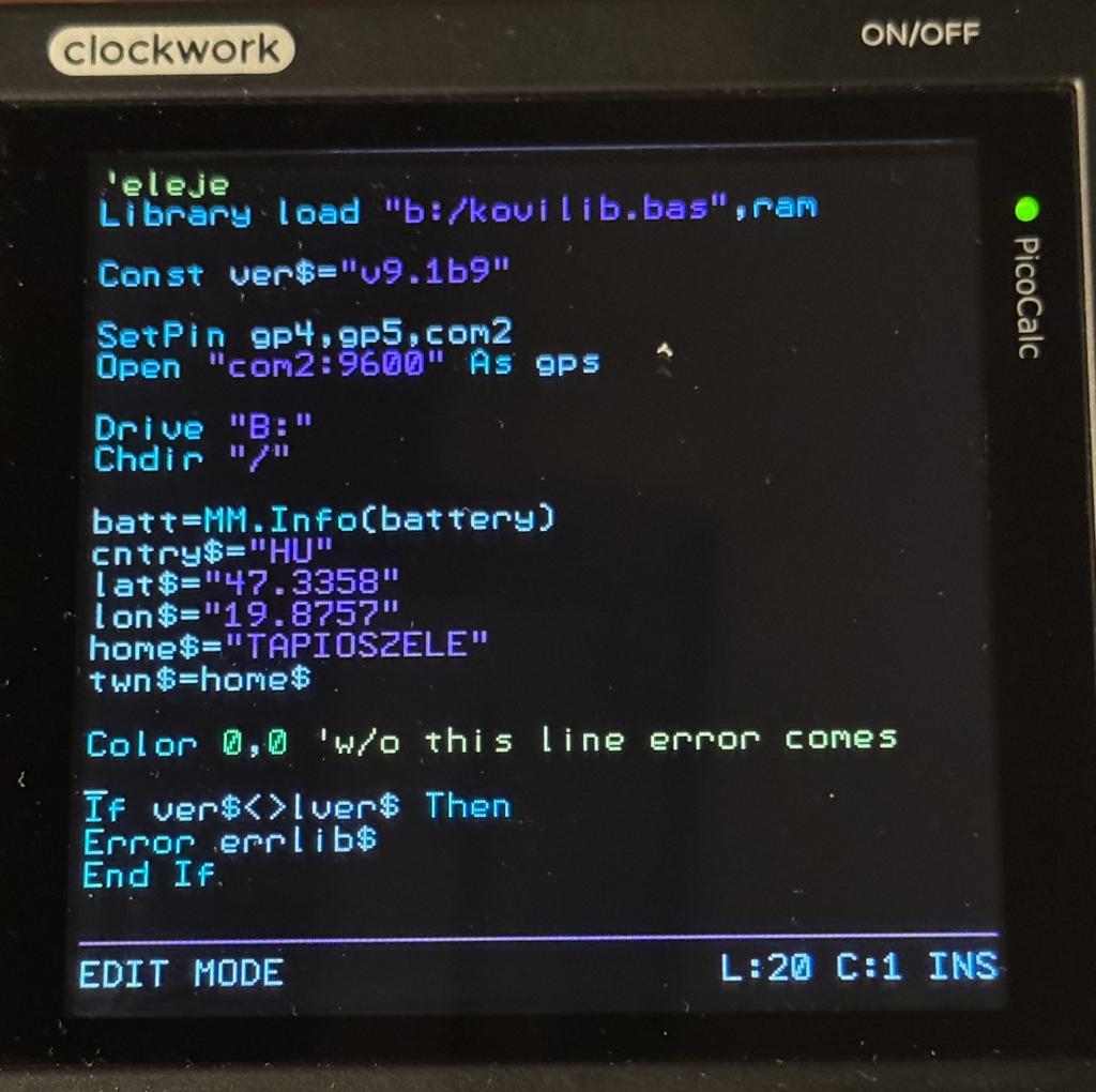

Hello Peter!
I used LIBRARY RAM with 6.03.02b12 worked well.
Now on 6.04.00RC0 I got Not enough PSRAM memory error. Same library - variable declarations, font definitions.
I tried RAM ERASE ALL, no success.
I have 6444K free RAM (100%).
Webmite version Pimoroni Pico Plus 2W
G@bor
Footnote added 2026-09-22 16:26 by terekgabor
I tried again is occuring after restart the system (Picocalc in this case).
If I delete RAM option from LIBRARY command the error disappears - library loads to flash. When I write back RAM option the error never comes again until next restart.
Footnote added 2026-09-22 16:51 by terekgabor
If I delete program from memory (NEW) then just LOAD back it can read library from RAM again.
So seems something happening after restart.

Posted: 06:49pm 22 Sep 2026
Hello Peter!
With RC1 I got new error:
Error: Invalid memory request of 0 byte.
Error is always referring to the library:
[LIBRARY] Dim cnvrt conv(9)
Conv() is an array created in type cnvrt.
Structure definition is in the library also.
If I delete Dim cnvrt conv(9) from Library error disappears.
Very strange, but there is an IF..ENDIF in the beginning of the main program. If I delete it or comment out, error also disappears.
This IF is checking two strings are equal or not only. Independent from conv() array totally.
Memory status:
Program: 47% free
Save var: 100% free
RAM: 100% free (6447k)
G@bor
Footnote added 2026-09-23 05:09 by terekgabor
I jusr put a COLOR line (for example COLOR 0,0) befire IF and no error at all.
Strange.
Posts: 12173
Posted: 06:57pm 22 Sep 2026
What is the definition of cnvrt. The more you can list the better my chance of fixing
Are you loading the library with LIBRARY LOAD? What happens if you use LIBRARY SAVE?
terekgabor
Joined: 02/01/2026
Location: Hungary
Posts: 161
Posted: 07:33pm 22 Sep 2026
Type cnvrt
R1 as float
R2 as float
Rstr as string
Bstr as string
End type
I simply put a line COLOR 0,0 before first IF in the main program and error disappeared.
Library Save is ok.
G@bor

Posted: 07:58pm 22 Sep 2026
Peter!
I reduced the main program and library as the followings:
Library: (mylib.bas)
Dim cnvrt conv(9)
Type cnvrt
R1 as float
R2 as float
Bstr as string
Rstr as string
End type
Main program:
Library load “b:/mylib.bas”,ram
If ver$=“” then
End if
The content of the if statement doesn’t matter. Can be anything.
Error Invalid request of 0 bytes comes.
If I put for example Color 0,0 before If error disappears.
Color 0,0
If ver$=“” then
End if
Error comes back if I delete or comment out Color line:
‘Color 0,0
If ver$=“” then
End if
G@bor
Posts: 12173
Posted: 09:42pm 22 Sep 2026
Thanks - that should give me what I need. Will work on it tomorrow

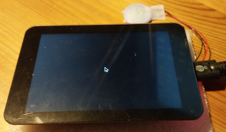

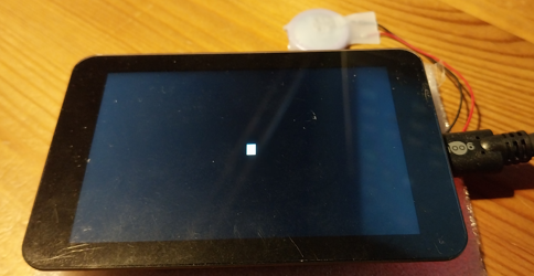

Posted: 06:39am 23 Sep 2026
GUI cursor on/off – when I set the cursor to off, a light-colored box remains.
> option list
PicoMite MMBasic RP2350B V6.04.00RC0
OPTION LCD SPI GP18,GP19,GP16
OPTION SYSTEM I2C GP34,GP35
OPTION FLASH SIZE 16777216
OPTION COLOURCODE ON
OPTION PICO OFF
OPTION CPUSPEED (KHz) 200000
OPTION LCDPANEL ST7796S, LANDSCAPE,GP20,GP23,GP21,GP22,INVERT
OPTION TOUCH FT6336 GP25,GP24,,50
GUI CALIBRATE 1, 6, 312, 10243, -9961
OPTION GUI CONTROLS 50
OPTION SDCARD GP31, GP26, GP27, GP28
> gui cursor on
> gui cursor off
/Peter63

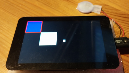

Posts: 12173
Posted: 07:24am 23 Sep 2026
What does GUI CURSOR HIDE do?
Can you blit on this screen?
BOX 0,0,100,100,5,RGB(RED),RGB(BLUE)
BLIT 0,0,100,100,100,100
If that doesn't work your screen doesn't support reading from the framebuffer and the cursor can never work
Edited 2026-09-23 17:32 by matherp
Peter63
Joined: 28/07/2017
Location: Sweden
Posts: 220
Posted: 07:30am 23 Sep 2026
  Quote  What does GUI CURSOR HIDE do?
tested GUI CURSOR HIDE
when I set the GUI CURSOR HIDE, a light-colored box remains.
/Peter63

Peter63
Joined: 28/07/2017
Location: Sweden
Posts: 220
Posted: 07:36am 23 Sep 2026
tested BLIT doesn't work
Edited 2026-09-23 17:40 by Peter63
Posts: 12173
Posted: 07:40am 23 Sep 2026
The ST7796S controller does support reading from the framebuffer. Check the schematic for your screen and that GP16 is properly connected. You may be able to modify something to get MISO working.
P.S. I tested on a ST7789_320 and the cursor commands work perfectly
