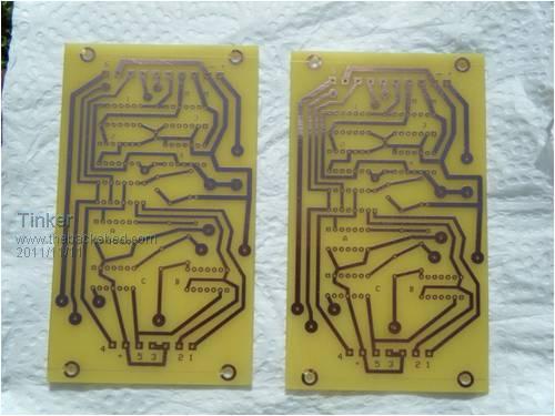

Posted: 02:15pm 11 Nov 2011
Success at last, today I etched two PCP's ant they turned out better than expected for a first time trial .
The freshly etched tracks are shiny copper but difficult to photograph all shiny.
It was a longish learning curve to get to this stage.
I had some PnP paper on hand so I tried that first before trying other media. The laser printed image of my artwork looked well so I went on to the iron on tone transfer to the PCB stage.
Dismal failure
Despite trying several heat settings and 'ironing' times the image would never fully transfer.
Then I remember reading about the 'ultrakeet' instructions how to modify a laminator for this job. The original instructions were for a specific laminator but it only did 1/32" max thickness boards - mine is 1/16" single sided.
But now ultrakeet mentions a new home laminator and its the cat's meow for this job
1. Its cheap, <A$20.- at office works
2. it has a spring loaded roller to cope with the thicker board
3. its easy to modify - see instructions on the ultrakeet website - to set it for the higher toner transfer temperature required.
4. only one <A$10 part required to modify the unit (a 160 degC thermostat)
Of course, once modified its only good for PCB's
I think it takes all the stuffing about out of the iron tone transfer method.
The laminator is a "Lowell A4 Home Laminator model LOOL 280. Only this model has the spring loaded roller suitable for thicker boards I believe.

Posted: 02:07pm 12 Nov 2011
Thanks Trev And Vasi for your comments.
Its certainly better than veroboard but after having drilled almost 300 tiny holes into the two boards my aging eyes needed a rest. Just as well I have a nice pedestal drill with an air/relay footswitch which lets me sit on a stool and do the precision drilling looking through a jewellers eye shade magnifier .
Trev, I think you can leave the thermal fuse in place as it was, I traced out the whole circuit of the machine and the fuse in mine was 194 degree C rated. I did replace mine with a 217 degree fuse but on second thoughts could have spared myself this fiddly job.
If I were to do tiny board I would laminate them on board strips long enough to pass through the machine. Since it might require several passes pulling the board out on something stuck to it might be like a request for Murphy to assist .
There appears to be sufficient spacing at the guide fins to let 1/16" boards pass without disturbing the TTP stuck to it. There was a faint groan like noise on the third pass but I don't know where that originated and the laminator still works fine.
I bought a cheap samsung B/W laser printer, to be used mainly for this job but am having toner fusion issues when using the Pulsar brand TTP. This is being looked into at the moment.
