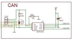

I have made a preorder of the CGCOLORMAX. I want to add CAN to it. Not sure whether to add a CAN shield and use SPI. or just add the CAN circuitry. So I am asking the brainiacs on this forum as to which approach would be the better with the plan of using mmbasic 4.0 with CAN commands. Thanks in advance.

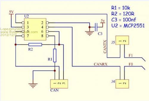

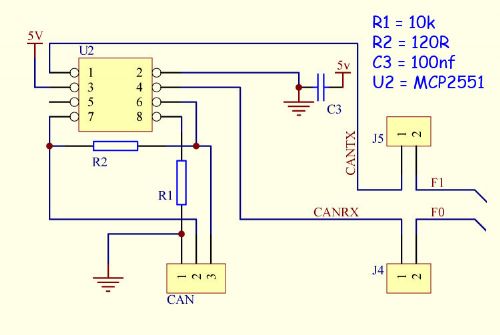

  Lopezjm2001 said   I have made a preorder of the CGCOLORMAX. I want to add CAN to it.
I believe Geoff is going to bring out a version of MMBasic that supports CAN using PIC32 Pins F0 and F1.
This is the circuit I have used on the UBW32-MCC PCB. It would be a piece of cake to wire this onto the proto area of the CGCOLORMAX. J4 and J5 are jumpers, and if you are going to always want CAN they can be simply ignored and wired across. CAN header is GND, CAN-H, CAN-L (pins 1,2,3). R2 is Bus termination and can be ignored if not required.
I got the circuit from the Duinonite range of `mites so I assume that it works ok as many people are using DM for CAN.
PS. The pinout of U2 (in the schematic) is NOT drawn the same as the physical IC numbering convention.

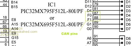

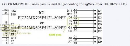

Adding my own circuitry to the prototype area as shown above is the option I want to go with but I am not 100% sure it will work with the mmbasic 4.0 with John Harding's CAN commands. As this board CGCOLORMAX1 is not exactly a color maximite and little documentation on it is available. So looking at the color maximite and the Duinomite Mega they appear to use different pins for CAN TX and CAN RX.
DUINOMITE MEGA - uses pins 58 and 59.
COLOR MAXIMITE - uses pins 87 and 88 (according to BigMick from THE BACKSHED)
So due to the difference in pin numbers I am optimistically hopefull that the MM basic 4.0 with CAN commands will work. Any opinions?

Posted: 01:55am 22 Oct 2012
Lopezjim,
Both systems use different chips!
The colour maximite is build with a 512L (notice the L on the end of the partnumber) the 100 pin version.
For can bus these pins canbe used:
C1RX 87 bus receive pin
C1TX 88 bus transmit pin
C2RX 90 bus receive pin
C2TX 89 bus transmit pin
AC2RX 8 Alternate bus receive pin
AC2TX 7 Alternate bus transmit pin
The alternate for C1 (CAN1) has a pin that is already used for the sd card.
If can1 is used on the DM then it corresponds to the same internal peripheral on pins 87 and 88 on the colour maximite.

Before adding CAN support to the UBW32-MCC discussion with Geoff and John was entered into as to appropriate pins to use for the Tx and Rx and this was Geoff's response.
This would mean that on the Colour Maximite the CAN would appear on the UBW32 F0 (RX) and F1 (TX) which are the same as Arduino D4 and D5. If Mick/Don included the CAN transceiver into their board using these I/Os that would be fantastic.
Hence the reason for adding it to the UBW32-MCC PCB... I provided link options for the CAN as F0 and F1 are also GPIOb pins and could conflict if CAN wasnt needed.

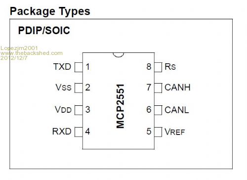

Lopezjm2001
Joined: 08/07/2012
Posts: 42
Posted: 01:20am 07 Dec 2012
Hi Gizmos, Geoff and JDH2550,
I would like to set a standard (or let you guys set a standard or a concensus) for the CGcolormax1 as to which pins numbers to use for a CANport. At the moment I am going with pins 87 and 88. I know they conflict with D4 and D5.
Any input or comments please?

Posts: 2984
Posted: 03:14pm 07 Dec 2012
Hi Lopez, All,
Firstly, CAN is not yet available on the Colour Maximite.. I think Geoff is going to include the routines using F0 and F1 as the CAN pins.
Secondly, taking note of the section of my schematic, (the one with the pale yellow background), please note the pin Numbering of the IC is not the same as the PHYSICAL pin numbering so dont wire up as if the position of the pins are as shown, use the pinout as shown in the "package types" above., (i.e. The NUMBERS are correct, the physical location of the pins is not.)
Also I have provided links to connect F0 to F1 as these are also used as D4 and D5 on the Arduino connector. This is so the CAN chip can be in circuit but not connected to the PIC32 unless you decide to use it.

Posts: 3372
Posted: 04:38pm 07 Dec 2012
Hi All,
Yes, I plan to implement John Harding's CAN with the Rx signal on pin 87 of the 100 pin PIC32 (also Arduino D4) and Tx on pin 88 (Arduino D5). This is on the Colour Maximite so it should also work on Mick's board and the CGCOLORMAX1. CAN should also work on the Duinomite. This of course is subject to everything working out as planned, but I am confident it should be OK.
I originally intended to put CAN into ver 4.1 but a number of bugs meant that I had to push 4.1 out early. So, now it will be in 4.2. Also, 4.2 will have support for RS485. I will probably put out a beta version first as I do not have the facilities for testing either CAN or RS485 and this should happen in early January.
