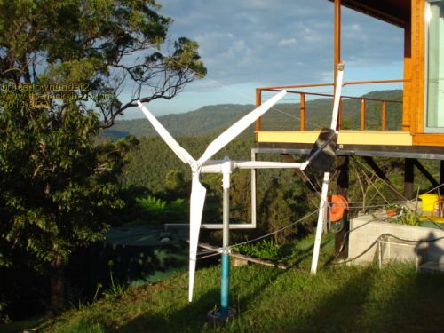

I admire you guys .. Have you ever thought of giving us "not so gifted" controller guys a hand ?
What I'm asking is how about a few of you get your caps on and help us by you developing a rpm controlled brake/slow down gismo/furling thingo. We ,for ever, have had this problem with our mill,s going into overspeed and busting blades or even worse,bringing the tower down.
I'm thinking along the lines of a motorcycle hydraulic operated disc brake /caliper.
You guys develope,I pay, something that could be up the top or in my control/meter room, to keep this wild bull mill from screaming it's blades off ..
What do you reckon , bet it would be a walk in the park for you techo's ,lol.
no issue with wiring,or it could be remote with a small battery pak and solar cell up the top for the actuator control .
Bruce

brucedownunder2
Joined: 14/09/2005
Posts: 1548
Posted: 05:04pm 22 Aug 2014
Thanks Grogstar.
Been thinking that a anamoneter (can't spell ) wind thingo up there could measure the wind speed and regulate the on/off/slowing mech. I have all of that stuff here.
Big stainless disc ,, hydraulic operated caliper and pads , brake line and resavoir
and the master cylinder with a push rod actuator.
I have a well equipped workshop to do any turning ,milling welding ,wiring ETC.
just the "smarts' in a box or down in my work area that can be operated remotely would be the cream that I'm after .
Also , I thought of a function on the "smarts" box to test the operation ,just to confirm all is ready for the strong wind event.. and turn it on,to lock it permanently if I go away for more than a few days.
Your last remark --furling on most winmills-- Yes, be sadly , I and many have had some bad experiences with these "wishfull thinking" arrangements.
Bruce

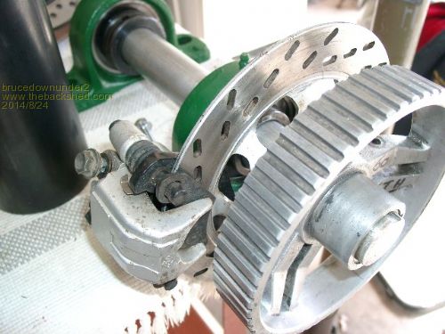

brucedownunder2
Joined: 14/09/2005
Posts: 1548
Posted: 11:45am 24 Aug 2014
OK, better get off this subject --it's not really anything to do with micro-controllers,Etc.
Anyhow, lastly, here's a pic of what I thought I might do some years back..
Still have plenty of this stuff ,,,so may fiddle a bit more.
Thanks for you guys ,but i really don't think you are into what i wanted.
End.
Bruce

brucedownunder2
Joined: 14/09/2005
Posts: 1548
Posted: 01:57pm 24 Aug 2014
Thanks grogstar,,
I didn't mean to be rude, I sort just came to the conclusion that maybe I was "off-topic" a bit ,within this section .
My original idea was some sort of sophiscated micro-controller that senses the wnd strength/power and convert this data into a brake controller ---like a car going down a steep mountain range -brake is not on all the time ,just keeping the car under control . And maybe after a period the controller decides to brake completly for an hour or more ,until that wind event passes.
If you are at home ,no problems,you do it.. but it's when it's(windmill) is unattended ,,thats when this "controller could be a real help.
Thanks for your interest, thats a motorcycle disc brake and caliper in the Pic.
Bruce
