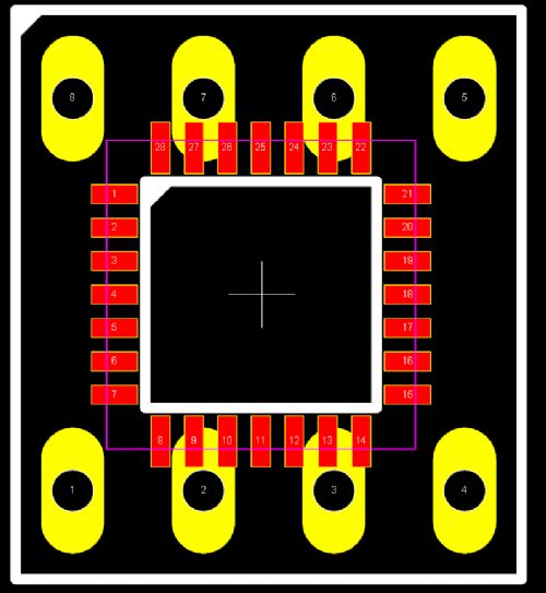

Posts: 2984
Posted: 08:21pm 14 Sep 2014
Hi Grogs,
Just a bit of food for thought...
Here is an accurate layout of the QFN over an 8pin socket.. The purple square is the physical size of the chip. It obviously wont fit as shown BUT If you were to use surface mount pins (mounted on the bottom) and not through hole then the QFN mounted on the top and you should have some room for a `couple' of solder link options to enable the same PCB to have 2 or more different pin configurations.
All that in a small standard 8pin IC package.

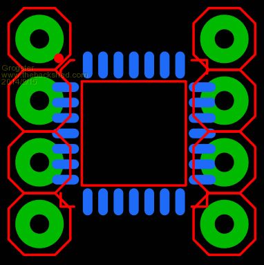

Posted: 08:53pm 14 Sep 2014
@ Mick - My CAD does not like that idea much - it WILL overlap - even at pin level.
Then there are two caps and a resistor yet to fit...
I suspect it is probably a little close?
I do see what you are getting at though with the DIL pins on the bottom copper only - you could put the pin through, solder it on the bottom, and trim it off at the top.
My only concern is lack of space - it is really pushing it!
Where would I get serface-mount pins from? Do you happen to have a part in mind you could point me to?
EDIT: I suppose I don't NEED to have a 100n cap on the power pins, and I don't NEED to have a 10k pull-up on MCLR on the board - they could be external. I could just put Vcap on the board, not the other two. That might free up some room for config pads you mention....Edited by Grogster 2014-09-16
Posts: 2984
Posted: 09:05pm 14 Sep 2014
Hi Grogs,
Yours is showing the same as mine.. they `just' miss the pins (you probably have slightly larger holes in your part but even your picture shows them missing on the LHS) but if you use surface mount pins then they wont protrude at all into the top layer just use vias to drop the signals down from top to bottom.
Tight.. YES!! Impossible .. NO!!
I see that you could have a SMD cap and 0805 resistors still.
Of course you dont need to suit an 8 pin socket it can be a SMD 8pin 2x4 pin header strip mounted on the bottom that gives more room underneath for solder config pads..
You could also have 2 pads on the top for I2C if you cant/dont wish to route them to config lines.
If we can come up with a pin-pin mapping with any options and `support' components it will be easier to see if/how it will layout.. but using the SMT parts it would definitely fit a 12pin or 16pin socket.
Mind you it would be a bit of a b|tch to hand solder.

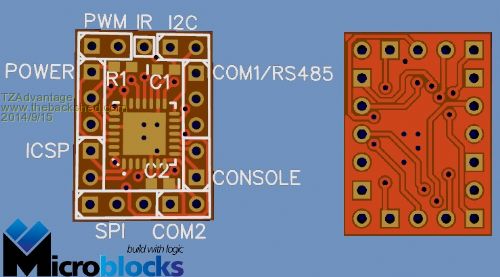

I made something similar some time ago. Did not finish it as i am still in the market for a reflow oven and the QFN's are a real pain to solder.
My wish was to make something as compact as possible, not necessarily in the shape of a dip package.
I came up with this:
The size is 13.4x18.4 millimeter. 2-Layer, bottom has a GND copper pour.
On the left side is reset, power and ICSP in the right order to plug in a pickit.
On the right console and Serial/RS485.
You could only use those and leave the top and bottom unpopulated depending on your needs.
There are only 3 uMite pins unused, ones with the least capabilities.
Here is the schematic:
2014-09-15_142142_Schematic_-_MB_uMite_P20.pdf
Edited by TZAdvantage 2014-09-16

Posts: 2984
Posted: 02:01pm 15 Sep 2014
TZ,
Beautiful little boards.. I love them...
A question, if I may, the GND `block' that you have in the centre of the PIC, about 4.5mm square, is there a metal tab on the underside of the PIC that mates with this? If so then we cannot run tracks with vias there, which I think would be crucial in fitting it all into a DIL 0.3" layout.
Does any one have any suggestions as to which pins would be most desired?
I have thoughts of I2C, SPI, Analog, I would like to see if we `CAN' get a one for all PCB laid out in the constraints that a DIP8 would allow.
DO we try to keep 5V tolerant lines (none are Analog though)?
Keeping with a 0.3" DIP8 socket what is the MAXIMUM PCB size you would like to see? Is 15mm x 15mm too big?
