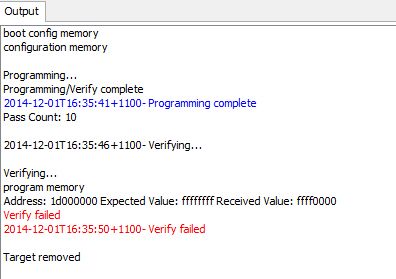

Hi All,
I only just last night tried upgrading to Ver 4.6b25 for the uMite and I get a verify failed error when I do a physical VERIFY command.. (see attached)
The program flash/burn itself passes (I thought this would have a verify as part of its function) and MMBasic appears to work OK. Grogster said he gets the same error but Geoff thinks that this might be a problem..
Can anyone else confirm or deny that this occurs.. As the error does not happen with earlier versions.
PS.
I have IPE set for a PIC32MX170F256B and I am using a PicKit3 to flash the firmware.

Well that's the thing it is ONLY when I actually do a verify that I get this error, the burn phase itself ALWAYS succeeds.
I am wondering if anyone else gets the same. I can accept that there is something wrong my end but earlier versions dont show this error..

I will go public here, and say that I to have the exact same error, in exactly the same way as Mick, but not just with the latest Beta. I have had that happen semi-regularly with the PICkit3 and IPE when I click the verify button.
It does not need to be the Micromite either, as I get this "Verify fail" error with the VT100 firmwares too, but I have just started to ignore these fails, or more to the point, just not bother to do a separate verify step.
The initial programming is a program/verify anyway, by IPE's own admission, so....
As with the uM, the VT100 once programmed works flawlessly, but when I click the verify button it is 50/50 if it passes or fails.

I downloaded the v2.26 IPE and it is exactly the same.
I will assume that as there are others with the same issue that it is not a `Mick has fat fingers' problem.
I will leave this up to the `C' experts with this one..
Oh.. I just remembered I read in the `170 I burned and I meant to do a comparison with the `source.hex'
Will do that now.
Posts: 2984
Posted: 08:03pm 01 Dec 2014
Hmmm,
I just compared the two files and received MASSIVE amounts of discrepancies, then I checked the file sizes and the original one is 702k in size whereas the saved version is 746k in size..
Hmm,
Out of my knowledge range..

I did a little mucking around and I think I know what the problem is.
The Micromite is storing the BASIC program and various settings in flash, and the first time it starts up these settings change.
You can prove it yourself. In IPE go into settings and click on "hold in reset". This will keep the reset pin low so that the Micromite can't start and alter the flash.
Program the chip, then re-verify. It should work.
Next go into settings and change to "Release from Reset". Do the verify again and it will fail because the Micromite has run. You can set "Hold in Reset" again and it will still fail.
If you enter a short program, then read the chip back, you can see the program starting at the beginning of flash at address 1d000000. Interestingly the program appears to be stored in reverse. Try entering abcdefg as a program. You can easily spot the hex values decrementing.
In some versions of Micromite, zeros appear to be written at the end of the program, in other versions it is not. It is these zeros that cause the first error.
If you short the TX and RX pins to do a reset, it will get rid of the error at 1d000000 but you'll hit errors further into the flash space.
Bottom line. IPE is working fine, and if you want to re-verify then turn on "Hold in Reset".

Ah, yes. That explains it.
When the Micromite MkII starts up the flash used to store the options is set to blank (all 0xff's) by the programmer, ie the erased state. The firmware checks for this and then sets the options (stored in flash) to the defaults. This takes half a second and if you watch you will notice that on the very first startup after programming the firmware, MMBasic will take about half a second longer to start up.
If you do a verify after the firmware has done its initial startup you will find that the flash has changed (by the firmware itself).
Geoff
