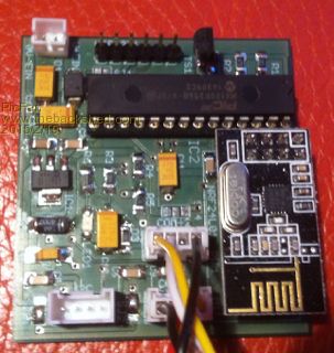

Hi Geoff!
Thank you for your great work! I only have 2 small problems:
I have built a wireless measurement system with 4 transmitters and 1 receiving center (433MHz or 2.4GHz). It works for months with PIC150MX128B without problems, but since I upgraded to PIC170MX256B following problems have occurred.
1.)
If I Change the batteries in the transmitters at 3 times will exchange, minimum 1 times the Basic program is deleted. The pins console TX / RX are not wired, they are open. With and without capacitor connected to pin 1, the problem persists. (During batteries replacement, the CPU is in sleep mode)
2.)
In the receiving center, the COM1 of Micromite 1 is connected to the console of Micromite 2. Upon loss of power supply, loses Micromite 2 almost always the program, Micromite 1 also, but less frequently.
I have replaced the chips, but the same problem.
I think the problem is related to the "option PIN" together, if you forget your code to delete the program.(Console RX Connect to TX and Power on)
Maybe it would be better to delete the program after 3 or 5 incorrect Code entries? (Configurable ?)
Sorry for my bad English !
Thank you and best regards from Austria !
Wolfgang
Posts: 3364
Posted: 01:43pm 19 Feb 2015
These sound like more than "small problems" to me.
I must admit that I have lost patience with the "reset by shorting Tx and RX" feature. It seemed like a good idea at the time but it has caused quite a few problems.
One solution would be to just not bother with this feature. With PICKit 3 clones as cheap as $20 it would be simpler to just reflash the chip. Another solution would be to have yet another option to disable/enable the "short Tx/Rx" detection - however that is messy as there are already too many options in MMBasic.
Does anyone have a bright idea?
There must be a simple way of telling the MMBasic to reset the flash when access via the console is impossible.
Geoff
