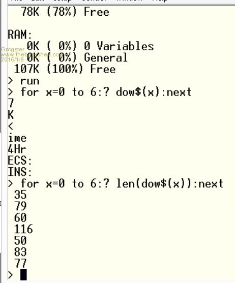

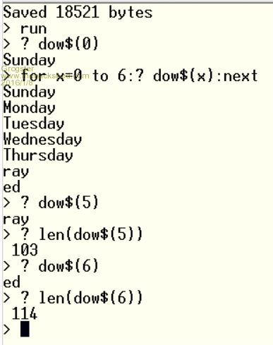

When run, the display shows the day of the week in the bottom-left of the LCD, and when you initially run this code, it work, but as soon as you touch the DATABASE button, DOW$ is erased - ALL elements of the string are now "".
It does not happen if you touch the OPTIONS or MESSAGING buttons, so therefore, seems to be something in the DATABASE routine, but I cannot see anything in there that would be wiping out DOW$.....
Can anyone show me the error of my ways?
ANOTHER EDIT: I have DELETED the library, and now the Cfunctions are in the main code, but I have not copied them to this thread. Full power-off reset followed clearing out the library and main code, before replacing power and loading the new code into main program memory. The point being, that with no library now, that can't be the source of some odd bug.Edited by Grogster 2016-01-07

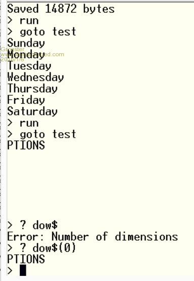

UPDATE:
Here is an image I get on the terminal, which shows the results of DOW$ after two run cycles.
The extra testing code is:
test:
For X=0 To 6
Print DOW$(X)
Next
End
...and the results are:
First time 'test' is run, I have stopped the code before pressing any GUI button.
Second time 'test is run, I have pressed the DATABASE button.
Note that DOW$(0) now seems to contain text from GUI button #2......
(that being OPTIONS without the O at the start)

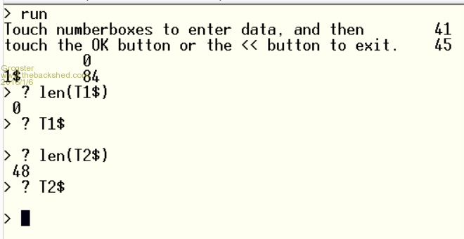

I've just tried to define two strings - T1$ and T2$ so I can use these in the GUI caption command, and am having EXACTLY the same issue, in that T1$ and T2$ are blank when you try to call them, so this is a totally different routine to what you mention disco4now, but they could still be related in some weird way.
The code I am trying to use in another screen is:
DateAndTime:
CLS
GUI delete all
Font 7,3
GUI caption #10,"DATE & TIME:",100,25,,RGB(yellow)
'Line 100,75,650,75,3,RGB(yellow)
Font 4,1
T1$="Touch numberboxes to enter data, and then"
T2$="touch the OK button or the << button to exit."
GUI caption #11,T1$,50,100,,RGB(green)
GUI caption #12,T2$,50,125,,RGB(green)
'Text 50,100,"Touch numberboxes to enter data, and then",,4,1,RGB(green)
'Text 50,125,"touch the OK button or << button to exit.",,4,1,RGB(green)

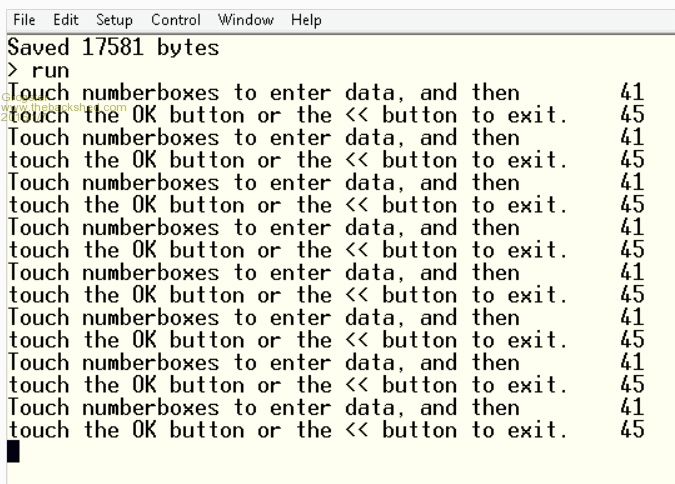

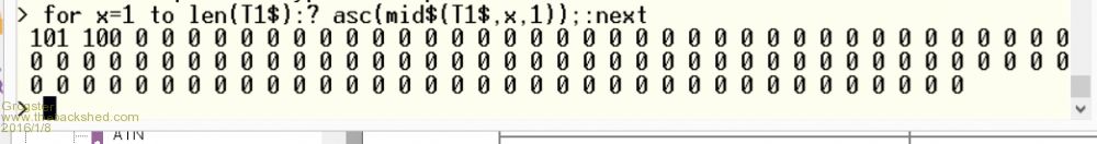

As soon as you try to draw the caption, T1$ and T2$ are blank with a length of zero, despite just being defined. If I put an END command between the T1$= and T2$= lines and the GUI caption commands, then ask the console to print them, they print.
Caption #10 works fine, as I am defing the text as part of the command itself, but captions #11 and #12 make the line too long for the editor, so I put them in strings first.
Posts: 10048
Posted: 02:42am 06 Jan 2016
UPDATE:
Yep, something very odd going on here.
New quick test code:
Font 4,1
Print T1$,Len(T1$):Print T2$,Len(T2$)
Result on the terminal:
I'll wait and see what Geoff says about all this before I get too carried away posting any more stuff about this.
Posts: 3368
Posted: 03:01am 06 Jan 2016
It looks like you have got a great demo of the issue. I will run it up on my MM+ test rig in the morning and report back.
Posts: 10048
Posted: 04:57pm 06 Jan 2016

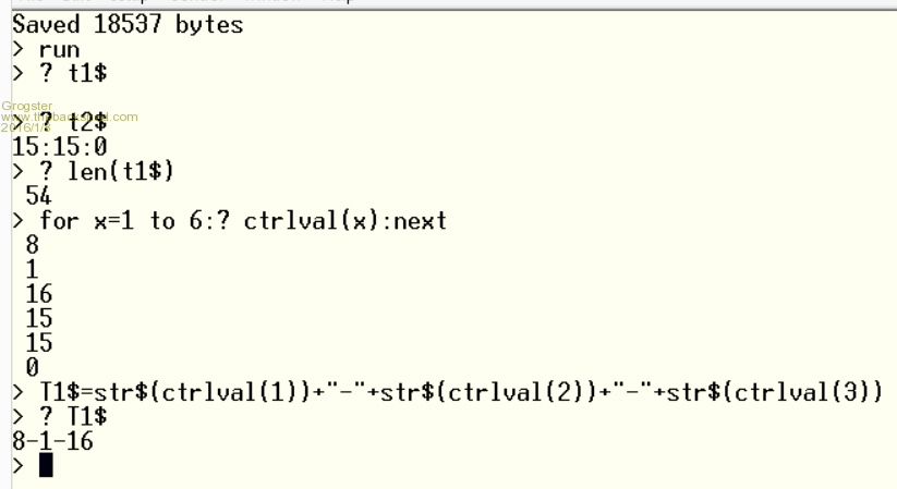

UPDATE:
The caption issue WORKS the first time through the code(as does the DOW$ issue), when you first power-up the MM+. Any subsequent attempts to run the code generate the problem.
So, physically remove power, run the code and it should work on the first run.
Re-run the code without cycling power, and the code will show the problem.
I just discovered that when I fired up the unit again today for more tinkering.
EDIT: This is with respect to the caption code above, not the original DOW$ issue, although that still remains an issue.Edited by Grogster 2016-01-08
Posts: 3368
Posted: 11:45pm 06 Jan 2016
This is very frustrating Grogs, your code works perfectly for me. Something very strange is going on here.
I am using a close to finished version of V5.1 for the MX470. Give me a day or two so that I can clean it up for testing and I will send you a copy.
I know that this sounds suspiciously like the answer I gave to drkl for his problem. I don't believe in coincidences like this, it is a worry.

sub test
For X=0 To 6
Print DOW$(X)
Next
end sub

UPDATE
I have found an even faster way around this issue, thanks to disco4now giving me an idea.
The problem seems to be related to the LENGTH option on the DIM command.
If I replace:
Dim MTH$(12) LENGTH 3
Dim DOW$(6) LENGTH 9
...with:
Dim MTH$(12)
Dim DOW$(6)
Then EVERYTHING works just fine - day references, captions - all that was not working before.
I think we may have stumbled on the cause - the LENGTH spec?

Posts: 10048
Posted: 06:40pm 07 Jan 2016
UPDATE
We're still getting corruption within arrays:
Note that DOW$ elements 5 and 6 are now more then 100 bytes long, when they should only be single words...
For the above image, I copied the rogue element into another string first during playing at the cosole.
I will wait and see what happens when v5 comes out soon.
EDIT: ...and yet more corruption...

Posts: 10048
Posted: 10:53pm 07 Jan 2016
Here is more of this error, this time when I tried to use spinbox values to set the internal RTC:
'SET DATE AND TIME:
DateAndTime:
CLS
GUI delete all
Font 7,3
Text 100,25,"DATE & TIME:",,7,3,RGB(yellow)
Line 100,75,675,75,3,RGB(yellow)
Font 4,1
T1$="Touch numberbox arrows to change data, and"
T2$="then touch OK or the EXIT button to exit."
Text 60,100,T1$,,4,1,RGB(white)
Text 70,125,T2$,,4,1,RGB(white)
Font 7,2
Text 20,175," DAY:",,7,2,RGB(cyan)
GUI spinbox #1,200,170,200,50,RGB(green),RGB(black),,1,31
Text 20,250,"MONTH:",,7,2,RGB(cyan)
GUI spinbox #2,200,245,200,50,RGB(green),RGB(black),,1,12
Text 20,325," YEAR:",,7,2,RGB(cyan)
GUI spinbox #3,200,320,200,50,RGB(green),RGB(black),,2010,2050
Text 425,175,"HOUR:",,7,2,RGB(cyan)
GUI spinbox #4,575,170,200,50,RGB(green),RGB(black),,0,24
Text 425,250,"MINS:",,7,2,RGB(cyan)
GUI spinbox #5,575,245,200,50,RGB(green),RGB(black),,1,60
Text 425,325,"SECS:",,7,2,RGB(cyan)
GUI spinbox #6,575,320,200,50,RGB(green),RGB(black),,1,60
GUI button #7,"EXIT",75,400,200,50,RGB(blue),RGB(gray)
GUI button #8,"OK",525,400,200,50,RGB(red),RGB(gray)
If CtrlVal(#7)=1 Then GoTo START
If CtrlVal(#8)=1 Then Exit Do
T1$=Str$(CtrlVal(1))+"-"+Str$(CtrlVal(2))+"-"+Str$(CtrlVal(3))
T2$=Str$(CtrlVal(4))+":"+Str$(CtrlVal(5))+":"+Str$(CtrlVal(6))
'Date$=T1$ 'GUI corruption issues
'Time$=T2$
'GoTo START
End
If I try to run this the string generated for T1$ is corrupted.
It is NOT corrupted, if I manually issue the exact same code at the command prompt.
