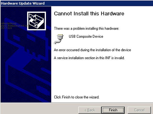

Also have the Composite usb device exclamation mark in device manager.
Have tried (installed) microblocks driver for this (right click install etc). No change even after reboot.

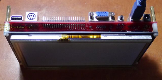

What are the lengths/specs/part numbers for the pcb standoffs for the display mounting.

I use 12mm M3 spacers to mount the TFT e.g. these Edited by matherp 2017-02-24

Here is a screen mounted on 12mm spacers and using 22mm spacers as stands to sit flat on the desk

I'm still stuck with the composite USB device issue.
Tried all the available driver versions.
I suspect my PC USB port power output is not man enough to drive the board properly.
So the driver fails to install.

Posts: 11914
Posted: 08:07am 26 Feb 2017
  Quote  I suspect my PC USB port power output is not man enough to drive the board properly.
Just put the header to "JACK" and use an external 7.5V power supply. Then try the USB again. That way the USB isn't supplying any power.

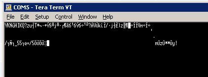

I'm still struggling.
I pulled the PIC 16F chip from the board as i could not get it to talk with any of the USB XP drivers suggested. Always had that exclamation mark in device manager.
I now have a serial converter connected to the console pins.
I have the com port / baud rate correct etc.
The console prints gibberish when I press the reset button on the extreme.
But the gibberish looks about the right amount of gibberish to be the splash screen.
Ideas before it goes in the bin... Very frustrated..

Have you tried the reset method from the manual:
Sending a stream of exclamation marks (!) to the console Rx pin at 34800 baud during its startup.
In the first 100 mS after powering up the Micromite will set the console to 34800 baud and check to see if an exclamation mark is received. If so, it will then wait for two seconds to see if it is going to get more than 30 of them in that time. If this is the case the Micromite will reset itself to its initial defaults and send the message "MMBasic reset completed" to the console.
This reset can be accomplished by simply setting the terminal emulator to 38400 baud and holding down the exclamation key while powering up the Micromite (on most keyboards this requires holding down shift and the number one key). This will even work if the console has been set to a non standard baud rate.

Put the 1455 back and use this driver on the documentation tab. This is known to work with XP.
Otherwise I suggest you return to WW to sort out for youEdited by matherp 2017-04-04

Do make sure you try the Driver in PeterM's link. I can also email it to you but some email servers 'strip' the attachment.
Also make sure the 14pin PIC is also inserted the correct way round (pins 1 & 14 nearest the buzzer).

I re-downloaded the driver and put the chip back, the driver still fails to load correctly. With the below message ..
I don't see how to send commands with tera term connected.
I don't have a PS2 keyboard available.
I expected to be able to control/configure the extreme via TT and the keyboard on my PC.
I can't do the reset to send exclamation marks as i can't see how to send them with TT.. My PC keyboard does not do anything with TT..
Sorry if I am being very dim.. The Extreme i'm alive light is flashing away.

Posted: 08:43pm 03 Apr 2017
Standby I now have MMEDIT Chat doing something via console connection!!!
OPTION LIST working.. Maybe nearly there..
