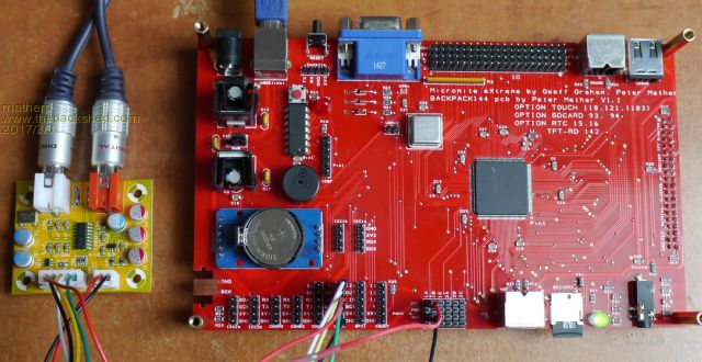

Release 5.3.10 for the 64, 100 and 144-pin MZs now supports FLAC playback over I2S
Supported frequencies are:
44100Hz 16-bit(CD quality) and 24-bit
48000Hz 16-bit and 24-bit
88200Hz 16-bit and 24-bit
96000Hz 24-bit
192000Hz 24-bit (252MHz only)
I2S Dacs are cheap and readily available. In the picture I'm using this one
Other versions include this and this
The command syntax is simplicity itself
PLAY FLAC "flacfilename" [,interruptwhenfinished]
so exactly the same as "PLAY WAV". The command is non-blocking and
PLAY PAUSE, PLAY RESUME, and PLAY STOP work as expected
Volume control is not available on FLAC files. With high definition audio volume should really only be controlled at the analogue stage.
Connections to the DAC are as follows:
MCLK - SPI3-IN (this is re-configured as an output of the clock signal and runs at 128 to 512 times the frame clock depending on the frequency allowing the DAC to oversample.
DATA - SPI3-OUT
SCK (Bit-Clock) - SPI3-CLK
LRCK (Frame-Clock) - pin-97 on the 144-pin, pin 68 on the 100-pin
All these pins are available on the SPI3 header on the Backpack144
Connections for the 64-pin chip are as follows:
MCLK - Pin-13
DATA - Pin-45
LRCK - Pin-30
SCK - Pin-29
For DACs with an inbuilt MCLK this connection can be omitted.
The functionality on the 64-pin chip would allow a very nice HD-audio touchscreen MMX-pod to be built
For anyone not familiar with the FLAC music format see wikipedia. FLAC is MP3 done properly
The FLAC codec was ported from the work of David Reid to whom great thanks are due Edited by matherp 2017-03-04

Couple of notes on the DAC I'm using pictured above.
On mine the red and black wires on the power connector were reversed, the silk-screening is correct.
The DAC has a 50MHz oscillator for MCLK connected via a 100R resistor next to the oscillator. I removed the resistor to use my MMX generated clock. I haven't tested with the on-board oscillator. It seems more sensible to have all three clocks fully synchronous.
The sound quality though my good amp/speakers is outstanding - certainly better than playing from the source CD with my CD player. All of the clock generation in the MMX is done in hardware directly from the 24MHz oscillator and looks totally jitter free on the scope. I personally can't hear a difference between 96KHz and 192KHz but that may be because of the sample FLAC files I've found on the web and downloaded.Edited by matherp 2017-03-05
