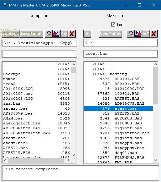

MMEdit V 3.7.0
This update includes support for the micromite eXtreme including file transfers.
MMedit’s file manager can be used to transfer any type of file between the PC and the micromite eXtreme.
This should save wearing out the SDcard holder!
The file manager hasn’t had much use since the introduction of the micromites so it might be ‘new’ for some users.
Old users (that's long term , not senior citizens) might notice that I have swapped the PC and micromite over so the micromite file list is on the right. That was a personal preference and I might make it configurable in a future update.
The other big change is in how MMEdit determines what sort of device is connected. It no longer tries to work it out and you have to select the correct syntax file to get communications working smoothly. This should also speed up some of the file transfers and ‘load and run’
If you have “save config in BAS” selected in Preferences, the com port and syntax file choice is saved with your program so by opening a program, the correct syntax is also loaded and this in turn sets the required options for communications.
One little side effect is, if you choose the “DOS” syntax and hit “Load and Run”, the program is sent to the DOS version as if you had clicked on “Run in DOS”
I think I have entered all the new commands for the eXtreme (and micromite V5.3 but please let me know if I have missed any.
Because of the changes to the syntax files, you will have to download the full program this time.
Also, the changes I have made to cater for the expanding range, has probably introduced some "unexpected behavior" so be careful and let me know if you are the one lucky enough to find one of the oddities.
