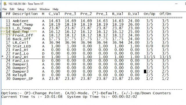

Hi All,
Can anyone see what I'm doing wrong here?
On the output screen, the "Active Point" is marked with a "*" at the beginning of the line.
It's hard to follow that line easily with the eyes, so I thought I'd simply underline it.
I can get that working, but then the formatting changes; Stuff moves to the left...
Esc[4m attribute set to underline the active point, & stuff is moved left.
This is the code that's writing the screen.
The line to set the underlined attribute is shown commented out.
After the point number & description are printed he TAB(18) is supposed to move to column 18 before the C_Val is printed.
That seems to be what fails when the attribute is set.

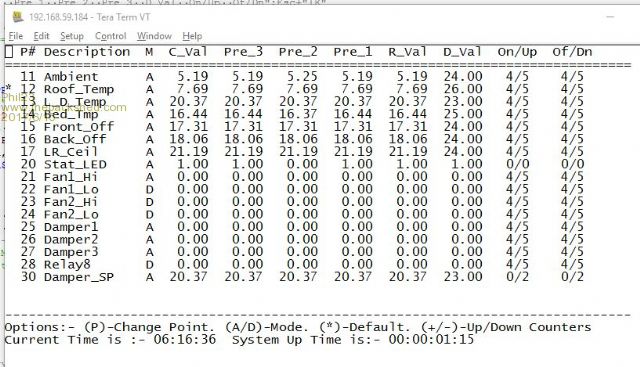

I think it's something to do with the TAB().
If I try padding it out with spaces, I end up with a mess, Double spaced etc,
And I lose the alignment of the /'s separating the On/Up & Of/Dn values if they contain 2 digit values.
Works fine until I try to introduce the attribute to underline the current point.

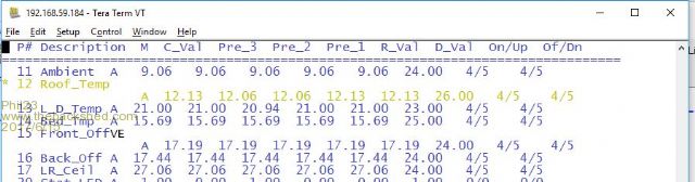

  WhiteWizzard said  Out of interest, does the weird formatting issue still occur IF instead you use a colour code setting to change the colour of the 'highlighted' line (instead of setting it with an underline escape code)?
That was my first idea, to use colours, but it had similar issues, and was also breaking lines in two.
Not sure what you are referring to as colour codes;
I just tried colours with VT attributes.
IE
[Code]
Yellow - Esc[33m
Blue - Esc[34m
and for the underline I used
Underline - Esc[4m
Normal - Esc[0m
[/code]
Using the colours I get this.

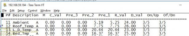

Pretty much the same in PuTTY.
Need to look at the HEX output, as I think the TAB is causing the issues.
It's almost as if the characters used in the Esc codes are adding to the cursor position counter when MMBasic tries to output the spaces.
Phil23
Joined: 27/03/2016
Posts: 1667
Posted: 01:23pm 15 Jun 2017
This is the HEX capture of what the Micromite is outputting when the underline is set.
Haven't tried to identify the TABS yet; work is calling.
Phil

Posts: 6607
Posted: 02:17pm 15 Jun 2017
If you don't want to change the descriptors,
padd as required as you print
  Quote   PRINT STR$(Pn,2);" ";LEFT$(S_Desc$(Pn)+" ",16);
The 16 might need adjustment.
MMBasic doesn't know that your 'underline' code is not a printable character so it is counted as printable.
If you want to stick with TABs, you could also adjust the TAB(18) to TAB(xx) whenever you do the underline.

  TassyJim said  MMBasic doesn't know that your 'underline' code is not a printable character so it is counted as printable.
Thanks All,
That's exactly what I discovered from the HEX output.
Because MMbasic is incrementing the cursor position for the control codes, excluding the Esc, the [4m adds 3 to the cursor position, hence the TAB command adds 3 less spaces than required.
I fried my brain a little trying to read the HeX output in Teraterm, before waking up to myself & realising Jim's HEX display in MMedit is far superior, having both Hex & Text on the screen, as any Hex display should offer.
So yes, TAB(18) became TAB(21) & the 70 became 73.
More readable now with the underline.....

I can see there the TAB() gives me grief, & usually my screen layouts are controlled by the space characters.
In this one, keeping all the forward slashes in a vertical line is required for the layout to appear correct.
Doing that with spacing became messy & long winded, while the Tab worked just fine until Introduced some control sequences.
Phil.

  robert.rozee said   phil, the at$(x,y) function i posted earlier will allow you to position the cursor at an exact location on the screen, will this not achieve what you are after?
Thanks Rob,
Yes, it will achieve exactly what I want & I plan on adding that function to all my screen output code. It will make life easier.
Unfortunately I have one of those problem solving minds that needs to know why somethings not working.
TAB() worked fine just plain text, but issues appeared when adding other attributes & control code.
Puttting TAB() aside because it wasn't working properly, was tainted by one thing...
Why???
I understand it's short comings now & can move on from it.
Painful & time wasting, but it's how my head works.
Phil.
Why???
Phil.
In MMBasic, TAB(x) inserts extra space characters into the PRINT stream to increase the size of the stream to the number in the TAB command.
MMBasic has no idea where the data is going to or if the receiver interprets any characters as other than printing characters.
TAB() is just one of the ways you can format your data before sending it.
MMBasic seems to ignore some control codes when counting character positions.
Sending a TAB character CHR$(9) requires the receiving device to do the formatting. In the case of a VT100 terminal, the tab stops can be set at any position so you would normally send the commands to clear all currently set positions and then set the required positions before using CHR$(9). If you rely on the tab stops being set before you send your data, you may be in for a few surprises.
The other way control print locations is to use the VT100 commands to locate the cursor. Rob's at$() functions makes this easier to do. You need to set the line as well as column each time. This can add more work in keeping track of the line position but gives the most control.
Earlier versions of MMBasic used the PRINT @x,y command to print at specified locations on the screen. It was intended for use on graphic screens but would also send the VT100 positioning commands (suitably scaled) to the console.
