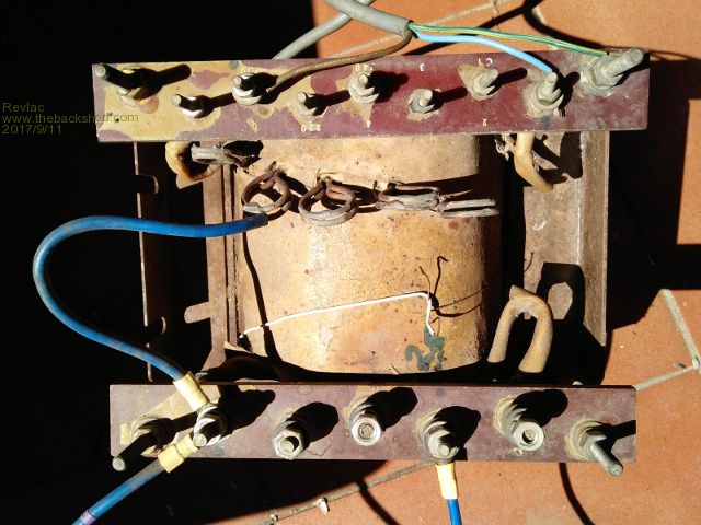

OK there has been a few inverters built using rewound toroids, quite impressive too.
Its getting a little more difficult to find toroids as most new GTI's don't use them, at least not large ones anyway.
There is some good size EI transformers around, if they could be put back to work doing something useful instead of tripping over the damn things or ending up waisted as scrap.
The idea was to try and get an EI Transformer with enough grunt to run the power tools in the shed, It will mostly run during the day so Im not too bothered about the idle current or the efficiency, but will try and get an acceptable amount that I can be happy with.
This is what I have found so far.
Transformer measured 1.06volts per turn buy running a small wire around the windings
core is 70X80mm Weight 27KG
Tested 50volts at the battery 235v on the AC side (driven by the EGS002 inverter)
current draw no load @ 27 volts on the primaries: no choke .913amp 46 Watts
on the 26 volt winding .850amp
with the E core choke 5 turns .685amp 34 Watts
now I did try the 25v winding and found a significant drop in the no load current, however there must be some point where running a low voltage through the primaries that its to low for the little EGS002 PWM to handle safely?
I have run various loads, water pump, small air con, large angle grinder, large fan and a freezer without a choke, the current draw (efficiency) was terrible.
But I must say when running with a choke the results where looking pretty good for average loads, at least as good as the High frequency inverter that is running the house ATM.
Its was some time ago when I tested this and haven't done anymore with it after blowing up a few fets and the 002 board, have so much other work to catch up with, hope to get back onto it soon.
Will Try again with proper current meter.
As this is a multi tap transformer there is a few different voltages to play with and see what turns out better, there is also another tap 300volts I think from memory, If I use that tap it would lower the volts per turn? Is there any benefit in trying that? Or just keep the turns ratio the same as the toroids are wound?
I don't really want to rewind this one as its good to play with for a bit until I get something a little bigger.

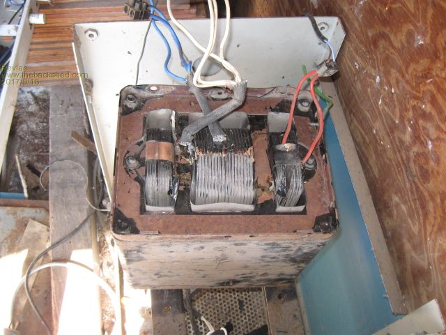

Now the next one is 200x50mm and a hefty 105Kg its from an old PSU for a computer system back in the 1980's probably even earlier.
Has 240v to 110v step down and a capacitor filter was connected to the winding on the left side.
The core is held in place with 2 bolts and would make rewinding the thing pretty easy If I decide to use it for an inverter.
Strange looking thing never seen anything like it before.
Perhaps there is a good reason for that.

Posted: 11:04am 16 Sep 2017
Thats a high leakage transformer, and will need to be rewound differently to get decent performance out of it. It has sloppy coupling, and with shunts as well, looks more like a battery charger configuration to me.
If you rewind with the secondary spread out on the core from end to end, and wind the primary over that , your coupling will be much much better.. we want tight coupling for this purpose.
As it is wound presently, leakage will be a big worry. It will mean you will drive much higher peak currents for no gain when under higher power... would no try to go much over a kw or so in it's present guise.
When wound tightly, it will be very good, but with idle current about twice the losses of a torroid would be my best guess
.........oztulesEdited by oztules 2017-09-17

I would suggest that the big traffo is a constant voltage transformer!!
They were extensively used in early UPS's. It is best suited to a boat anchor as far as an efficient inverter goes. I have seen them before and it looks like a "Deltec" inverter transformer. When the mains was up, it worked as a battery charger, when the mains failed a BIG contactor changed it over to an inverter. Its late 60's early seventies stuff.
Hope that helps.
Joe
p.s.
I chucked a few of them away!!!
Its also known as a ferro resonant transformer. when they work hard they make more noise than a diesel generator.
Some further thinking on that transformer!!
It was driven by huge SCR's that are about 3 inches/75 mm long and one inch/25mm square. one SCR and one cycling diode per package. They were made by Seimans.Edited by joebog1 2017-09-19

Hi Joe
Well I think you have almost nailed it.
Its labeled as Sola Electric Computer Regulator, but it appears to be as you described.
I was scratching my head for a bit over the SCR part you mentioned
Then I realize that I striped apart a unit a bit like that some time ago,(Plugged into the transformer somehow I think) had a load of capacitors, power transistors, thyristor's, SCR's,diodes control boards etc.
The best or most useful part so fare would be the single and double stack ferrite cores it had.
There I have learned something new.
Or is it something old.

Aron, the ferro resonant tranny still has good laminate in it, and so is not throw away. Can certainly be used if rewound.
Those transformers run in saturation, and thats part of how they self regulate... ie a change in line voltage will have little effect on the core magnetization, as it is saturated anyway.....masks the line noise as well, thats why they are inefficient at low loads....but if you drop the primary input ac voltage, knock out the chokes, it can be used as a normal tranny... if you don't lower the input ac, then it will saturate more than when you had the controller inside.
At full loads, they can be as high as 92% efficient, but at low power, they may be as low as 20% efficient and less. As a charger generally in the 50-75% range overall, as full power is mostly of short duration, before it settles in to the bulk charge... which will be well less than 100%, so efficiency suffers dramatically.
It seems to be an American thing. I never saw a Aust traction charger using this kind of tranny, but a plethora of American ones did.
........oztules

A thing to check before you try and undo that transformer!!
Check to see if there is a gap in the "middle leg" ( stop larfing!! )
Deltec and Solar Basic is same company!!
you will probably find its hi-potted. Read: lots of beer lots of patienec and be prepared to lose some laminations, the proverbial PITA to undo.
Gday oztules, there were constant voltage transformers made in Aus. Most by Ferguson Transformers. They were almost exclusively ( MY experience) used in recording studios mostly to run Scully lathes. Shheze thats a long time ago
Joe

Gday oztules
I will certainly have a play with it (the transformer I mean:) will know more when I take it apart
There is also a few ex Telecom 48v battery charges here, one of them I use to charge the lithium battery bank. Runs well too, will take a look at them next.
Gday Joe
Yep the middle leg has an air gap at the end about 3/16th the other end is tight

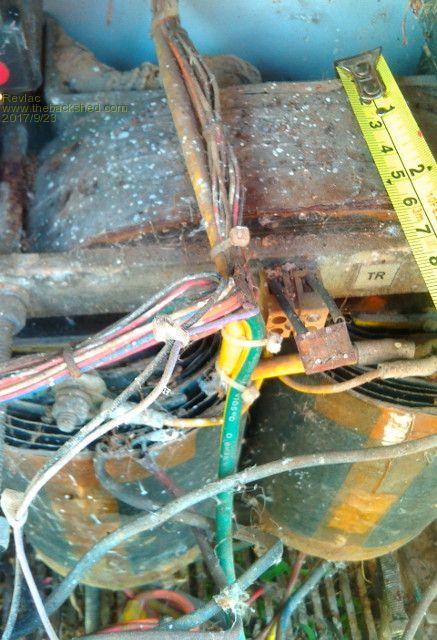

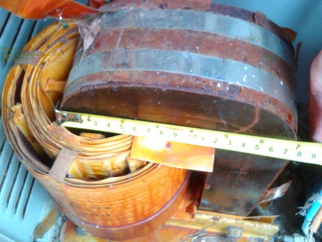

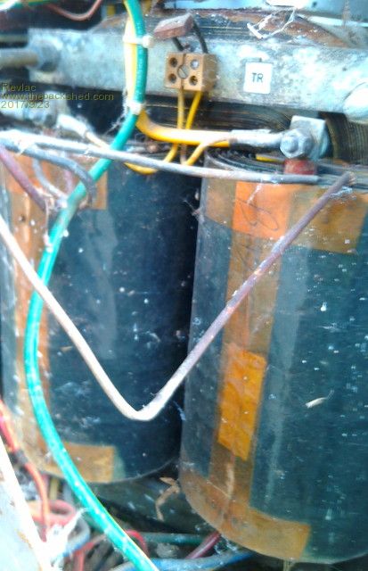

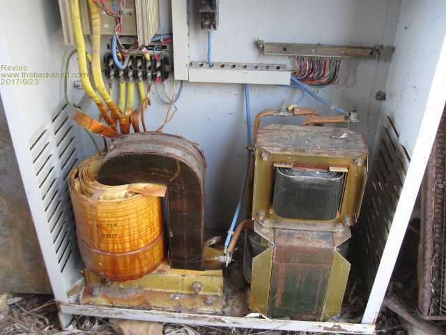

Revlac
Joined: 31/12/2016
Posts: 1310
Posted: 03:28am 23 Sep 2017
HI Warpspeed
I see you have no problem designing and building your own gear.
The changeover speed on some small ups these days (cheep 500w version I had) is not fast enough for some equipment, At 10ms transfer time, my old computer used to drop out.
Some local shopping centers don't have a backup geny or UPS, the grid went down and they just shut the door.
A few have industrial size UPS (Think the inverter transformer runs full time) Keeps the cash registers going.
These battery chargers used by Telecom were built strong and could connect up to 100 of them together if they had the communication wires connected.
This one is Power Electronics
charges about 50A, Have run it to 60A no problem provided I don't mess around with the current limiter, (Snaps the breakers off almost instantly) it uses a block SCR and Diode configuration very robust design IMO.
Have one identical to this, charges the lithium battery bank sometimes, noisy 80 decibels @ 1m.
The 2 different size chokes are huge.
The transformer looks like 2 horse shoes strapped together output is 80v.
Would be quite a large area to rewind a new secondary and primary on to it.
Has a large air gap between the primary and secondary ATM
This next one Is L.M.Ericson much the same but more compact
pictures are a bit crappy from the phone camera.
Batteries in the good camera leaked and stuffed the inside of it.
Has smaller core area but they covered more of it.
I think theses core's may be worthy contenders.
Also have a transformer from a CIG 150 mig welder my only dislike about that one is all the laminates are welded together where as all others I have are bolted (clamped together)
Well Them's my choices
Aaron
Cheers Aaron
Off The Grid

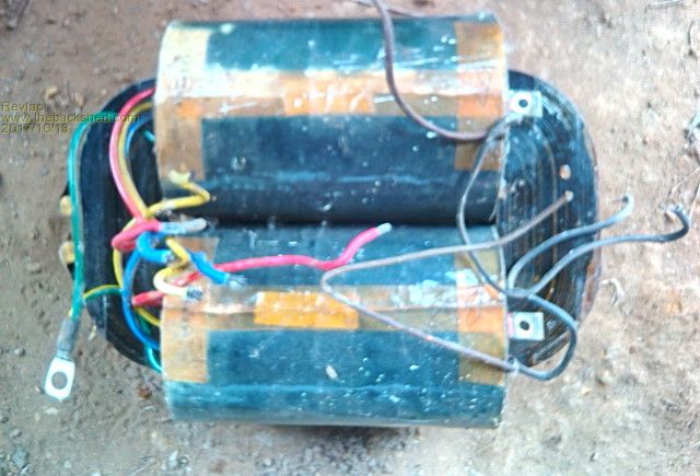

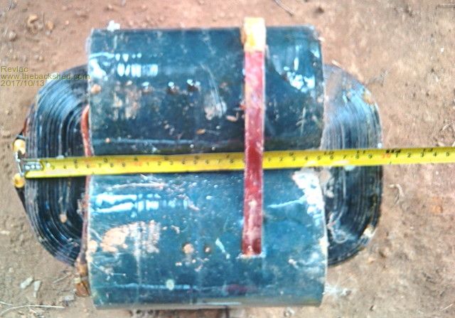

Revlac
Joined: 31/12/2016
Posts: 1310

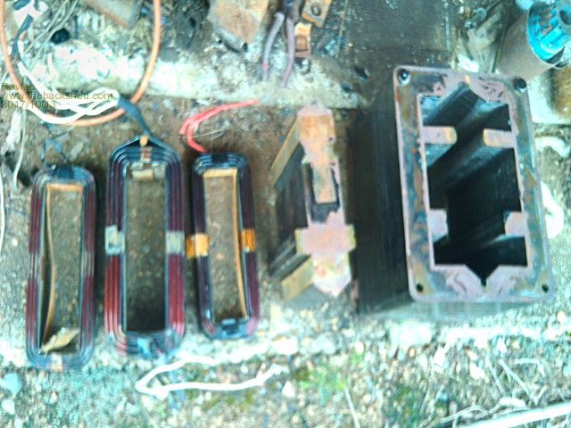

Posted: 03:10am 13 Oct 2017
Finally managed to get that Big Transformer apart, thought it would be an easy job, just take the bolts out then slide the center out, But no! after stuffing around trying to press it apart with a jack, the middle leg would not move, stuck in tight with paint.
I ended up separating all the laminates just to free it up.
Anyway this is how it turned out, looks like a bit more work than I have time for ATM.
Core is 100cmsq
Volts per turn was 3.7
primary was 64 turns
About 1.5 Tesla
This is the calculations That I thought would be appropriate
For 48Volt by 235Volt
primary turns 14
Secondary turns 127
Tesla 0.833
Turns Ratio 9:1
This might have to go on the back burner for a bit.
I have this C core that should be a little easier start with.
For low idle current I'm looking at 0.575 volts per turn.
Core is 52x60mm
primary turns would be 45
secondary turns 405
Tesla .837
Again that is a 9:1 turns ratio, might work it down to 8:1 yet
Just depends on how that many turns will fit with the size of wire that I have.
Thank's Warpspeed for the link to that Tesla calculator, Had fun with that.

Aaron,
Either of those C core transformers look promising, provided you can separate the two halves.
They will almost certainly be dipped in transformer varnish and then oven baked.
That effectively "glues" the whole thing into one solid lump, and sometimes they come apart fairly readily and sometimes they don't.
It may take something like a very large chain block, a sturdy metal frame, and several tons of force, but see how you go. Don't be too surprised if you cannot get them to come apart.
