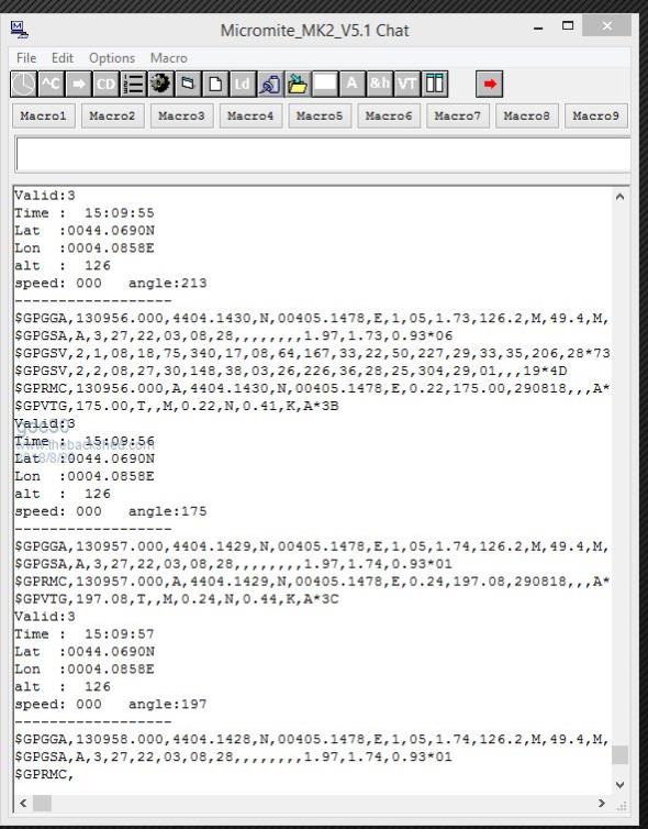

peter:
I abandon the idea to use serial port and i2c (with pic32mx170 as slave) on rpi, it does not work properly (I lose gps frames and some times rpi corrupt i2c), so I go back to the stm32h7 where i don't need to use a slave

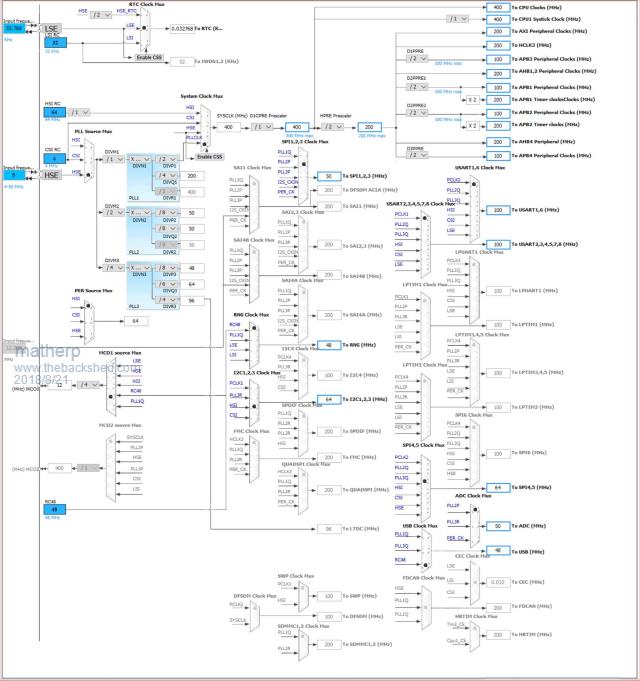

Posts: 11962
Posted: 01:20pm 21 Aug 2018
Yes it can be done but there is relatively little advantage over the MMX and it would just be another port to maintain. Lots of things are different about the H7 vs F7 in particular the clocks and the memory map. These would need quite a lot of work. To give you an insight into the H7 setup, the attached is the configuration screen for the clocks in the chip (lots of them!!)
Edited by matherp 2018-08-22

This update (no version change) fixes a couple of bugs in GPS handling.
2018-08-29_211035_Armmite1.3.zip
In addition I've included a diagnostic for GPS.
Use
OPEN "COMn:baudrate" as GPS [, timeoffset] [,monitor]
e.g. OPEN "com4:9600" as GPS, 2, 1 'switches on GPS monitoring
Monitoring will output to the console the GPS messages as they are received. The critical message is GPRMC. The code looks for the parameter after the time to be an "A" to indicate data is valid. If the parameter is a "V" this indicates the data is invalid. This drives the GPS(VALID) function and no other GPS functions should be used unless GPS(VALID) is non-zero. Monitoring can be turned off with:
CLOSE GPS
Re-opening with the monitoring parameter set to 0 or missing will run normally.Edited by matherp 2018-08-30

hi peter
test update ok, no pb, gps work correctly
it is a good idea to put monitoring function
re-opening Com is also good
tomorrow I will test function "send frame to gps" but it is more complexe because not all gps card have this possibility
