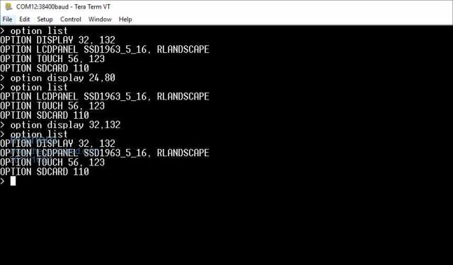

Can someone look do an option list and see what Option display shows.
I can't set it to 24, 80 and it causes problems using the inbuilt editor.
If I set option display 24,80 I end up with various results, last result returned 24,66 but now at least the cursor moves to the end of line and matches MM.Edit chat window and I can edit long lines the old way and not drop characters.
Posts: 12068
Posted: 07:19am 21 Oct 2018
24,80 is the default so is not shown in option list, same as all other "defaults". All versions of Micromite are like this.
Edited by matherp 2018-10-22
KeepIS
Joined: 13/10/2014
Posts: 2286
Posted: 07:41am 21 Oct 2018
That's all well and good, but I changed it and it does show up if you set it, now I get incorrect values if I try to reset it, I should not have to re-flash the chip just to get the correct values back. Or are back but the reported values are just wrong?
I set it back to default a dozen times and it still displays incorrect values, it does not disappear from the list.
Edited by KeepIS 2018-10-22
Posts: 12068
Posted: 08:29am 21 Oct 2018
As you can see from the above it is working for me. What happens if you do OPTION RESET?
Starting from a clean re-flash can you provide a sequence of commands that are giving problems so I can see if I can replicate

Posts: 12068
Posted: 09:46am 21 Oct 2018
This is correct. The display size automatically adjusts for the number of characters that can be displayed on the TFT when "OPTION LCDPANEL CONSOLE" is set. This is the same for the MM+ and MMX.
Use "OPTION LCDPANEL CONSOLE 1" and you will get 36x100 using FONT 1Edited by matherp 2018-10-22
