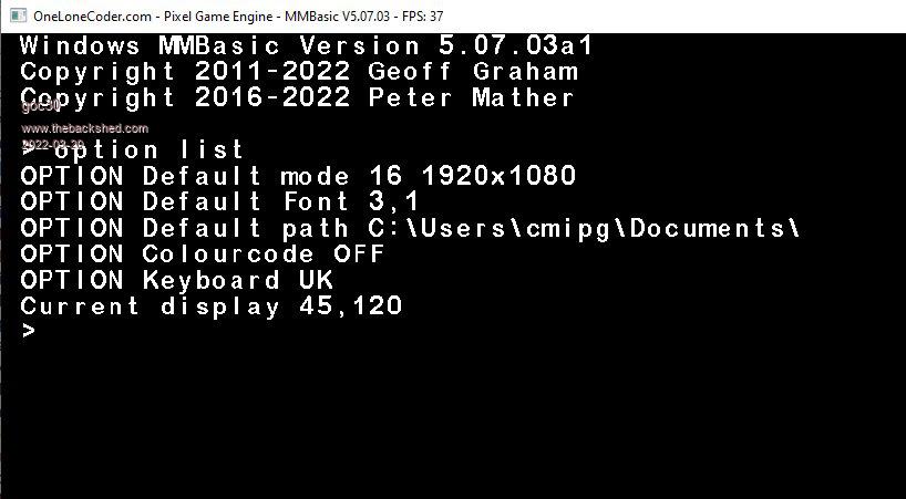

Is there a MMB4W mode that matches the ILI9488's 480x320? I don't see it in the CMM2 manual, but seem to recall that some modes have been added to MMB4W.
I see that mode 7 matches the ILI9341's 320x240. Being able to exactly match an LCD resolution makes it easier to develop a graphical interface with MMB4W which can seamlessly be moved to the PicoMite.
Posts: 12041
Posted: 02:20pm 18 Mar 2022
  Quote  Is there a MMB4W mode that matches the ILI9488's 480x320?
Here you go - mode 20

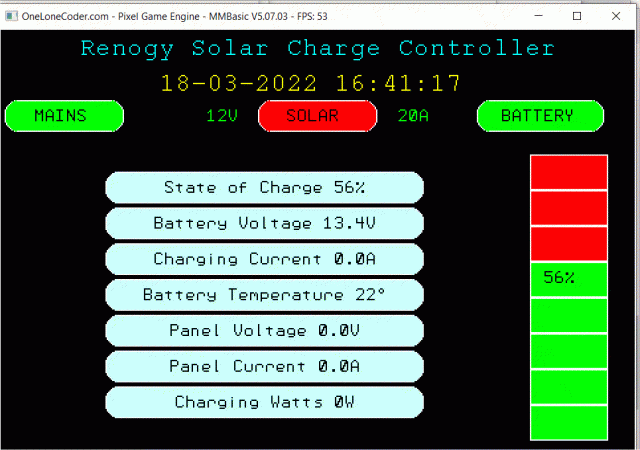

Because it is windows and it's very flexible screen handling, would it be useful or feasible to have a custom screen mode option like mode 99 490,673.  After mode 99 you just stipulate the resolution? Just wondering.  for all those users that will keep asking for new modes, they could just use that.  It is probably a waste of time and not doable in this version but I was just thinking.  Think of a vertical arcade game in a tall thin fixed window. Disregard if this is a stupid Idea.

  matherp said  Here you go - mode 20
Thank you. I had tried, though I feared not rigorously, to make the display somewhat independent of the resolution, and mode 20, 480x320, worked perfectly with no other changes for the program from here (which used mode 13, 400x300).
