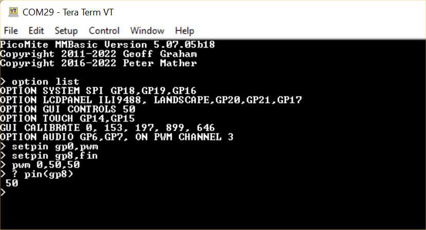

Posts: 6303
Posted: 01:15pm 03 Sep 2022
Hi Peter,
I would like to report a feature (a.k.a. bug) in the picomite 5.07.05b17 software (this is not the VGA version, but I expect it to be the same in the VGA version).
The default setup for extended function inputs (count/frequency/period) is GP6,7,8,9
The default (layout dependent) audio outputs are GP6,GP7.
I guess this intro is enough for Peter, but let me explain for the ones that don't get it yet.
If you assign the GP6 and GP7 pins to audio, the frequency measurement on GP8 and 9 is incorrect (i.e. 83 Hz versus 50Hz).
Most likely the timer clock divider is adapted to generate 44kHz audio, and this changes time/frequency measurement on all 4 pins in the group GP6,7,8,9.
the software warns the user not to use pin 6 and 7 (assigned to audio) but does not hint that GP8 and GP9 cannot be used anymore when
Setpin gp8,FIN
? pin(gp8)
Maybe a simple numerical correction of the output value of GP8 and GP9 is possible. Maybe a warning not to use GP8 and GP9.
As a real hardware guy I expect my zero crossing circuit to fail, and spend some time measuring it before I started looking at the software....
Edited 2022-09-03 23:19 by Volhout
Posts: 12301
Posted: 01:27pm 03 Sep 2022
Can't replicate
Posts: 9402
Posted: 01:46pm 03 Sep 2022
