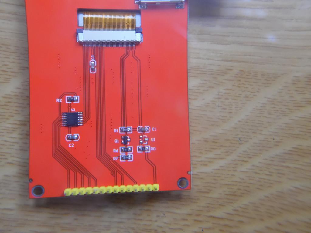

Thanks I'll try that. Is the BL 3.3v only.
OA47
Joined: 11/04/2012
Posts: 1056
Posted: 10:28pm 09 Apr 2024
Palcal the specs are very difficult to find but here is what I have found:
  Quote  GENERAL ELECTRICAL PROPERTIES
Minimum supply voltage [V DC] 2.8
Maximum supply voltage [V DC] 3.5
Minimum IO-pin input voltage [V] 2.8
Maximum IO-pin input voltage [V] 3.5
IO-pin output voltage [V] Equal to supply voltage
There is a provision for a 3 terminal regulator cct. next to the backlight cct. but on the ones I have the regulator circuit is bridged out with a zero ohm resistor and the pads for the regulator are not populated.
0A47
Posts: 3411
Posted: 10:53pm 09 Apr 2024
  Quote   Is the BL 3.3v only.
The whole panel is 3.3V only. The 3.3V regulator (U1) has not been fitted and is bypassed by a link (R0).
The backlight anodes go to Vdd (Pin 1) via R1 (10Ω) and Q1 switches the cathodes to ground. The base goes to BL pin via R6 (1kΩ) and to ⏚ via R7 (10kΩ).
The old 2.8" ILI9341 don't have Q1, the LED anodes go direct to LED pin and cathodes direct to ground so they require an external resistor to limit the current.
I inadvertently plugged the 4" panel into a 5V board without any damage but SD cards are damaged by 5V, fortunately did not use one.
To use the 4" panel on a board that has 5V on Vdd remove R0 and install U1 (3.3V LDO regulator).
Edit. Followed my own advice, added a regulator as above.
Now running on 5V.

@phil99 what regulator did you use. I have identified the IN pad one should be GROUND and one OUT, I cant identify the ground pad.
Also I guess these displays can't be used with the MM BackPack because the PWM signal to the backlight is 5v.
Edited 2024-04-10 14:23 by palcal
Posts: 3411
Posted: 05:06am 10 Apr 2024
The regulator was salvaged from a dead 2.8" panel and doesn't have a recognisable type number. Too small for that.
Looking at the 4" panel with SD socket top left and connector pin 1 (Vdd) top right which goes to the middle (top) pin of the reg. Connector pin 2 ⏚ goes to bottom left of the reg. Bottom right of the reg. is 3.3V out and goes to C1 and R1.
The 1kΩ base resistor of Q1 is high enough to allow 5V PWM. Just 4.4mA max at 5V.

I've searched Element14 and RS Components but can't find any with the correct footprint. I have some SMD regs I can probably wire in somehow but would like to do it properly.
@morgs67 what one did you order.
palcal
Joined: 12/10/2011
Posts: 2053
Posted: 07:19am 10 Apr 2024
It's taken me over an hour but I finally found one at RS components
MCP 1754-3302CB its 150ma, should be ok.

Modified my Pico backpack to supply display with 3.3v.  The 4" display that stopped working on 5v. is now alive again and calibrates ok. Now to test on MM2 with 3.3v.
On the MM2 the 3.5" screen won't calibrate I get Touch Hardware Failure after two targets and it won't calibrate on the Pico so maybe a display fault.
So my 4" screens now work and calibrate on both Pico and MM2.

Another oddity with the 4" IPS ILI9488.
The resistors near the SD socket on other panels are in series with the SD pins (to protect the SD card in the event of 5V SPI data I guess) but on this panel they are all 4.7kΩ pull-ups.
When the SD SPI is connected to the display SPI Blit, Save Image and Pixel(x,y) no longer work as the 10kΩ (or 6.8kΩ) from LCD_CS to MISO can no longer pull MISO low enough.
The cure is to remove R8 from SDO.
A possible alternative to removing R8 may be to reduce the 10kΩ to 1kΩ - 1.5kΩ to override it. Untested, may be too low for some SD cards.
The pull-ups are another reason to take care not to apply 5V to this panel unless you fit a 3.3V regulator.
@Palcal, yes also found the blotch eventually reappears.

  Quote  A possible alternative to removing R8 may be to reduce the 10kΩ to 1kΩ - 1.5kΩ to override it. Untested, may be too low for some SD cards
Now tested. All the SD cards I have are happy with this so I suggest leaving R8 in place and using 1.5kΩ or 1.8kΩ for the LCD_CS to MISO resistor.
