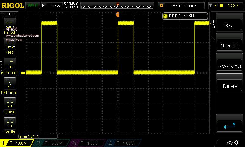

ville56
Joined: 08/06/2022
Location: Austria
Posts: 642
Posted: 06:59pm 08 Dec 2024
2 scope images:
1) signal at the DS18B20 without pullup resistor (data are at the low/high transition but resolution is too low to see them)
2) same signal with pullup 4k7 attached
my conclusion: the pico does not properly pull the pin to low with 4k7 pullup to start the conversion because the output is not correctly set since at least V6.00.00 RC17.
73 de OE1HGA, Gerald
Posts: 9223
Posted: 07:06pm 08 Dec 2024
It looks like that. Perhaps the output wasn't set to low before the in/out mode switching? That would almost certainly be in the firmware.
