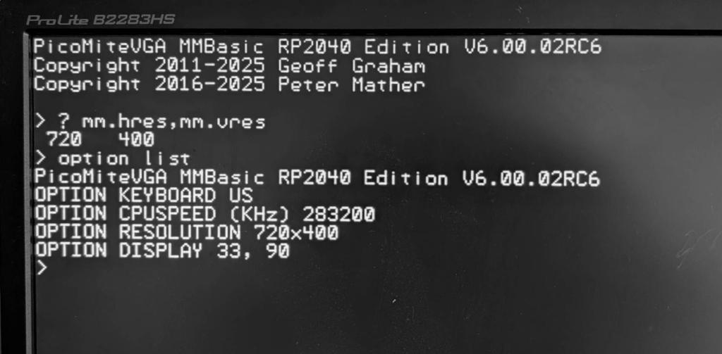

First time I tried VGA..maybe a noob comment:
> option list
PicoMiteVGA MMBasic RP2040 Edition V6.00.02RC6
OPTION KEYBOARD US
OPTION CPUSPEED (KHz) 252000
OPTION RESOLUTION 640x480
> option cpuspeed 378000
Error : Invalid Option
> option cpuspeed 315000
> option widescreen 720
And a wish: Would it be possible to make the "colour map" command available in all versions?
Edited 2025-03-24 18:43 by dddns
Posts: 6223
Posted: 09:10am 24 Mar 2025
Hi
The RP2040 only supports 640x480 (mode 1) and 320x240 (mode 2), no widescreen 720.
In the new code, the OPTION CPUSPEED has disappeared. This will be in the new manual.
Use OPTION RESOLUTION 640,315000
or OPTION RESOLUTION 640,378000
Apparently this was usefull for the RP2350 that has far more complex relation between resolution and cpuspeed with all these HDMI resolutions.
But it breaks with the old OPTIONS.
Edited 2025-03-24 19:10 by Volhout
Posts: 3421
Everyone is a 'noob' with this version. Found it on page 2 of this topic.
OPTION RESOLUTION 640, 378000 'sets the firmware to run at 378MHz - 640x480 refresh rate 60Hz

But still, the announcement post says:
RP2040 VGA VERSIONS
OPTION CPUSPEED 252000/315000/378000 'NB: not available when widescreen mode enabled
OPTION WIDESCREEN 720/OFF

Posts: 12102
Posted: 10:12am 24 Mar 2025
  Quote  The RP2040 only supports 640x480 (mode 1) and 320x240 (mode 2), no widescreen 720.
Not true
OPTION RESOLUTION 720
works on the RP2040 VGA, mode 1 (720x400) and mode 2 (360x200)
  Quote  HDMI and VGA now both use OPTION RESOLUTION and the 640x480 CPU speeds are now set the same by default.
All variants
OPTION RESOLUTION 640 [,252000] 'sets the firmware to run at 252MHz - 640x480 refresh rate 60Hz
OPTION RESOLUTION 640, 315000 'sets the firmware to run at 315MHz - 640x480 refresh rate 75Hz
OPTION RESOLUTION 720 'sets the firmware to run at 283.2MHz - 720x400 refresh rate 60Hz
VGA only
RP2350 only
OPTION RESOLUTION 848 'sets the firmware to run at 336MHz - 848x480 refresh rate 60Hz
OPTION RESOLUTION 800 'sets the firmware to run at 360MHz - 800x600 refresh rate 56Hz
HDMI only
OPTION RESOLUTION 1024 'sets the firmware to run at 324MHz - 1024x768 refresh rate 60Hz
OPTION RESOLUTION 1280 'sets the firmware to run at 372MHz - 1280x720 refresh rate 60Hz
Edited 2025-03-24 20:25 by matherp
