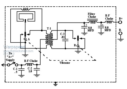

Back in ancient times before semiconductor devices, everything used valves which needed to be run from a high voltage dc power supply.
For things like a car radio that only had the 12v car battery, a thing called a vibrator power supply was used. You might even remember those from your youth.
These had vibrating contacts in both the primary and secondary side of the transformer that worked together synchronously. The contacts in the primary generated an alternating square wave, and the contacts in the secondary converted a higher voltage square wave back into dc. Mechanical rectification if you like. There were no silicon diodes in the very early days.
Now the curious thing about this is that if you could keep the vibrator going, the whole thing is completely bi directional. This is what Wiseguy referred to earlier as "a dc to dc transformer".
If we replace the vibrating contacts with mosfets, we can achieve the same effect of having an isolated dc to dc power supply that is completely bi directional.
One side chops up the dc into an ac square wave, and the other side acts as a synchronous rectifier turning the ac back into dc.
If the transformer is 1:1 ratio and we have two battery cells, one on either side, they effectively become solidly linked in parallel, but without any direct galvanic connection. Power will flow from the higher voltage side to the lower voltage side until the voltages become exactly the same. And the effect is completely bi directional.
So you could link 16 cells via 16 1:1 windings and they *all* assume the same voltage?
Sounds like black magic to me but I believe you.
Is that 'same voltage' the average of all cells?
And how much or little by way of Amps is there being shuffled around? I suppose that depends on the cell voltage difference and the 'shuffled' current drops to zero once all cells get to equal potential?
I suppose this method would work a lot quicker than my present 'relay shuffling' where each cell gets connected only once every 56 seconds to get a measured boost, depending how much, or little, it needs.

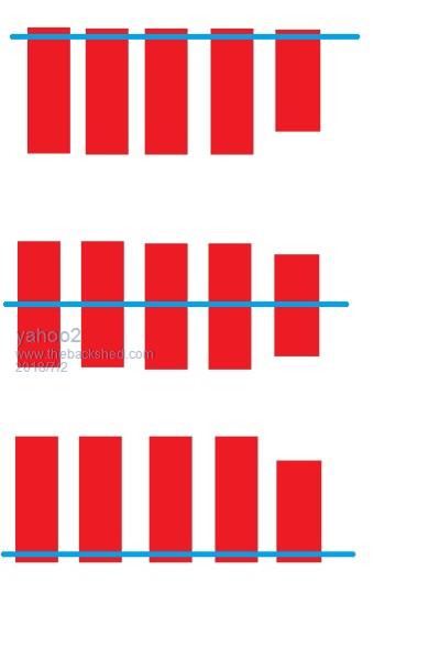

Hi Klaus, when I mentioned constant balancing, I am talking about balancing at any voltage. I only balance at 3.6 volts on a CALB bank because that is where they need to be all level. if I balanced at 3 volts they will not be level at 3.6 volts, the smallest capacity cell will hit full and shoot up in voltage before the others.
you guys are balancing voltage and assuming that equates to balancing capacity
if you try and make the voltages level over a range of state of charges the smallest cell will be constantly adjusted every cycle.
They will "try" to all assume the same voltage, but if the cell capacities are greatly different that can never really happen throughout the full charge/discharge cycle. It might just settle down to having some average mean cell voltages that are still different to each other, but not by as much.
The current flow is going to be determined by the internal resistance of the switching circuit. Mosfet rdson and transformer winding resistances for example may be made fairly low, but can never be zero.

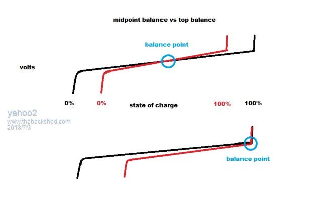

I have obviously done a crappy job of explaining this, maybe I can do it with pictures.
the red line is a cell with less capacity than the black line (rest of the cells). If I balance at a specific state of charge all the cells will be at that voltage EVERY CYCLE and the smallest cell will always hit full or empty before the others.
We need to chose a voltage to balance very close to the top and stick to that voltage so that all the cells hit the "knee" together. Then we trigger our low voltage disconnect before the smallest cell gets to the bottom "knee".
with really old cells I would prefer to balance at the bottom and stay away from full charge but solar being what it is there are almost no opportunities to bottom balance a battery bank.

The way I do it is have an upper limit of 3.4875 volts per cell then I balance between 3.6-3.65 volts about six times a year or less. seems to work OK, haven't had a client with a problem yet. (touch wood)Edited by yahoo2 2018-07-04

Thanks Yahoo2 - I think I get you now - a picture is worth a heap of words, but it raises another couple of questions for me.
How do you know the weak cell is at its midpoint of capacity - is cell voltage a relatively reliable indicator of remaining capacity ?
Your method sounds a little like a type of equalisation where you try to set the string capacity midpoint to match the weak battery capacity midpoint. But it appears this also reduces the capacity range for the whole bank ?
My understanding is that an active balancer would give one the best results at all points along the good batterys capacity curve.
All the "better" batterys will assist the weaker battery as far as delivering capacity to load (they would all contribute to the capacity loss of the weaker battery by slowing its progress to low end point) - all cells ideally reach the exhaustion point at ~ the same time. When charging the weaker battery (without balancer running the weak cell would peak out earlier), but the balancer now works in reverse and shares any minute over charge on the weak battery between all the other cells until the ideal total string voltage is reached.
I dont see it as driving the poor little weak battery harder whilst cycling but rather helping it & slowing its demise whilst minimising capacity loss for the whole string. Edited by wiseguy 2018-07-04

  wiseguy said   Thanks Yahoo2 - I think I get you now - a picture is worth a heap of words, but it raises another couple of questions for me.
No , you have it backwards, I am saying DONT balance anywhere away from one end or the other. choose one point and stick to it.
Perhaps there are some things you wont understand until you run a battery bank hard and your active balancer will not keep up and you cook your first cell, or worse, cook someone elses.
Lithium cells dont always give you nice slow absorption cycles, I have seen banks charge for forty minutes and the taper at the end is 12-30 seconds if you are off by even 2-3 watts at the end and you are measuring total bank voltage to control the charge rate, it will not see one high cell you are going to have to dissipate 100-200 amps. The individual cell high voltage disconnect is supposed to be a failsafe not a regular event.
Yes I know that new perfectly matched cells can run for years with nothing keeping an eye on them but this is a DIY site where cheap old mismatched gear is catered for.
Its really scary how fast the voltage on one particular cell can rocket upwards at the end of charging.
Its vitally important to monitor all the cell voltages individually and stop charging as soon as any individual cell "takes off", and that can happen in seconds even at quite low rates of charging.
Once you have personally seen this effect with your own eyes, you will be astonished. Its the reason why many people prefer the individual cell discharge loads that cut in and out at a very specific voltage.
The cell that takes off first will start its discharger going first, and charging will then abruptly cease as the cell voltage rockets up to the charger turn off.
The cell discharger continues to pull more power for a brief period from that same cell, until that high cell falls back and the discharger cuts out.
In this way, the cell that takes off first, and has the highest voltage at the end of the charging cycle, has a small amount of current "stolen" by the discharge load each charge cycle, and that allows all the others to gradually catch up over time.
As this happens at the end of every charge cycle, eventually all the cells will start to "take off" pretty much simultaneously, and the cells will then be quite closely top balanced.
Its fascinating to watch all the individual cell voltages very slowly march up the screen pretty much in a straight line. Then at about 3.40v several will break into a sprint up towards the 3.45v finish line, where the charger cuts off. This all happens within a minute or two.
I see no point in charging to a much higher voltage as some people do. The difference between reaching 3.45v and 3.55v is about twenty seconds of charging time. That is not going to help the actual state of charge very much.
I would stop at 3.40v, except that last 50mV is where the cell balancing load switches in, and its what makes the top balancing work very selectively.
