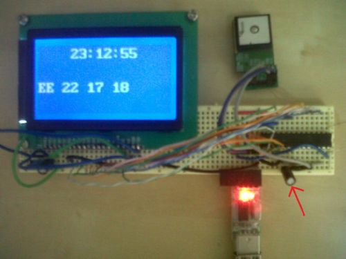

Joined: 28/01/2013
Posts: 17
Posted: 01:27pm 22 Jan 2014
Hi,
I've had my PIC32MX150 working for a few day's if you look at the photo, you can see I'm using a 47uF 16V electrolytic.
I'm powering the whole circuit from a USB to serial TTL interface that has a 3.3V and 5v output, the USB interface is plugged into a powered USB hub that keeps the whole lot running 24 hours a day.

Alan68
Joined: 28/01/2013
Posts: 17
Posted: 03:01pm 22 Jan 2014
Hi,
I've measured the voltage on pin 12 (console data in) and it's 4.6V from the USB to TTL interface, the Microchip manual say's that pin 12 is not a 5V tolerant pin.
I've used 2 resistors to make a potential divider, 3.9K from the TTL output of the USB to serial to pin 12 and a 10K from pin 12 to 0V.
