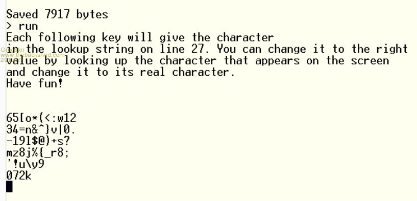

EDIT - Updated test results:
NO RESPONSE at all from the \ button, 2nd to the right of the spacebar.Edited by Grogster 2015-09-04

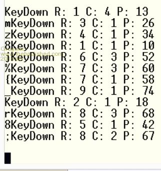

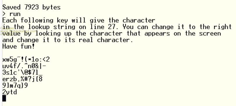

Hmmm. That is exactly the same output.
Still miss keys. I hope there is not a mistake in the matrix.

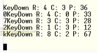

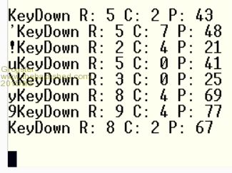

Can you change this line:
[code]DIM Matrix.KeyDown.Debug = 0 'DEBUG[/code]
to this:
[code]DIM Matrix.KeyDown.Debug = 1 'DEBUG[/code]
It will then print a line with the row and column numbers.
Maybe that helps pin down which ones are missing.

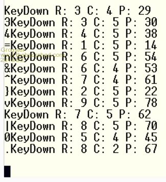

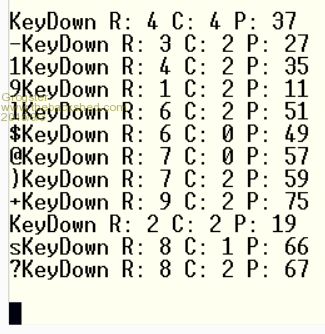

RESULTS:
ESC-F12, left to right:
TAB-Delete, left to right:
Caps-Enter, left to right:
LShift-RShift, left to right:
Fn-\, left to right:
Left,Up,Down,Right arrows:
Note that I pressed ENTER at the end of each row, to get a line on the TT screen, so I knew where to crop the screen grabs.......
Unless you actually WANT to do all the work to get this running right, you could just ignore it at this point, as my IF/THEN code works fine, it is just not that efficient and can't handle up/down code etc, but for my purposes, that is not needed anyway.Edited by Grogster 2015-09-04

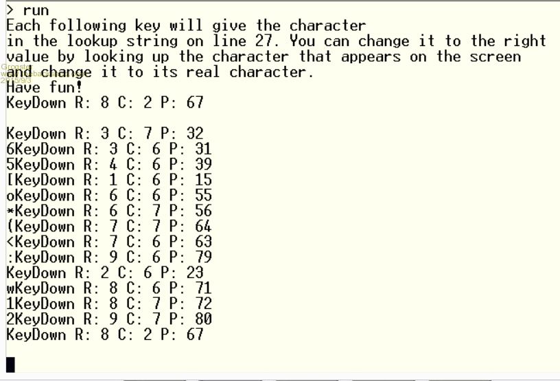

Ah i see the mistake.
change in de subroutine this line:
[code]P = row * 8 + col + 1[/code]
into
[code]P = (row - 1) * 8 + col + 1[/code]
I am learning a lot to decode a matrix and handle all the shift/ctrl, more than one key issues etc. I am happy you actually have some hardware to test it on.:)
Edited by TZAdvantage 2015-09-04

RESULT:
The \ key is now producing a result.
ENTER position changed to a + character, so I made that zero, reran the code, and it has move to 59 - is that OK?
How are we progressing now?

That is much better.
I'll send you a Lookup string within a few minutes so that all the keys return their right character (without shift/control/caps/fn etc for now).
EDIT:

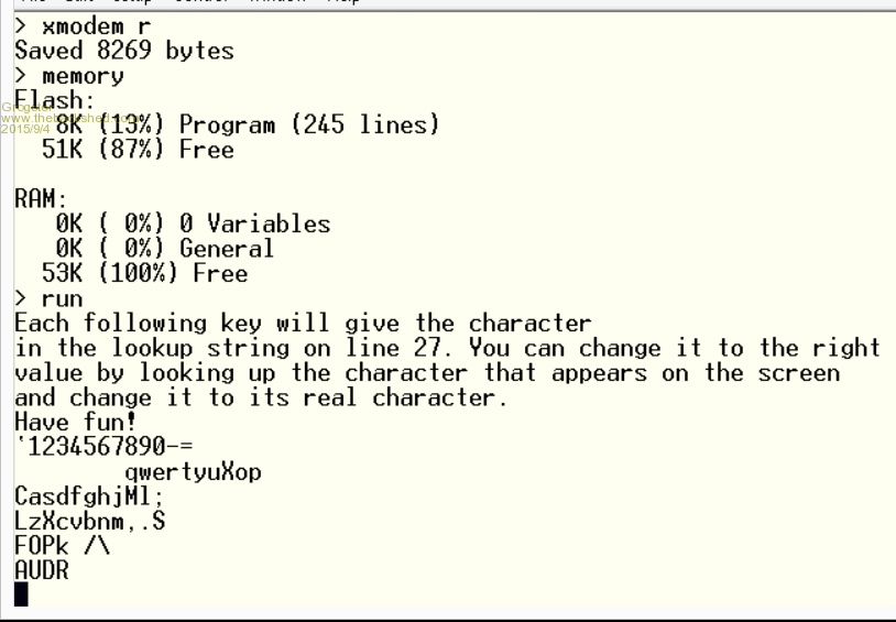

Ok here is the new lookup string and a small modification to allow for the backspace key. Just paste this over the existing part.
Each 'normal' key should return the right character. The 'special' keys return a capital letter, that still has to be processed.
But first get this translation right,before continue to the next step. :)

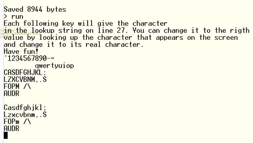

New code acknowledged. I will try this out later today, and let you know.
Posts: 10062
Posted: 04:55pm 03 Sep 2015
RESULTS:
MicroBlocks
Joined: 12/05/2012
Location: Thailand
Posts: 2209
Posted: 05:22pm 03 Sep 2015
Ok that still needs a small tweak in the Lookup string.
[code]
DIM Matrix.Lookup LENGTH 72 AS STRING = "XcdRLe3XX,lXPu9X zaDTq1`UxsACw2XmSFXBXXOgXfvtr45hnjbyo76X;E./p0-XmkX\i8="
DIM Matrix.LShift LENGTH 72 AS STRING = "xCDxxE#xx<LxxU(x ZAxxQ!~xXSxxW@xMxxxxxxxGxFVTR$%HNJBYO&^x:x>?P)_xMKx|i*+"
[/code]

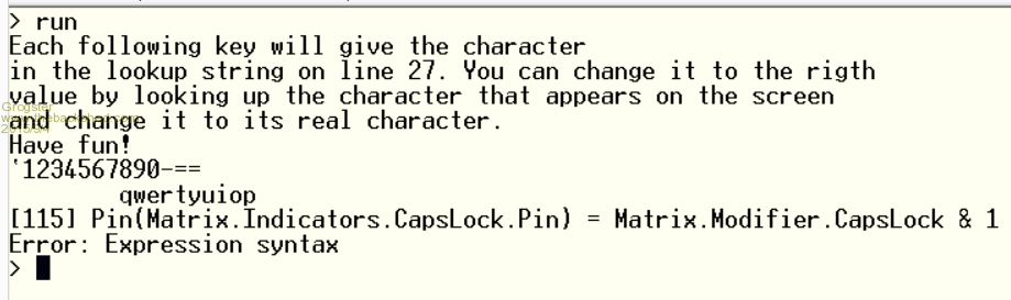

I am working on the capslock and shift.
You can also try to use more then one key.
I do not have a protection against ghosting so it should only work with 2 key rollover.

if len(Matrix.Buffer$) > 0 then
Keys$ = Matrix.Buffer$: Matrix.Buffer$ = ""
print Keys$;
if Matrix.EnterPosition = 0 then print 'DEBUG
endif

SUB Matrix.KeyDown(row, col)
LOCAL Key$, K, P
if Matrix.KeyDown.Debug = 1 or Matrix.EnterPosition = 0 then 'DEBUG
print "KeyDown R:" row " C:" col " P:" P 'DEBUG
endif 'DEBUG
if Matrix.EnterPosition = 0 then 'DEBUG
Matrix.EnterPosition = P 'DEBUG
POKE VAR Matrix.Lookup, Matrix.EnterPosition , Matrix.Key.Enter 'DEBUG
print "Enter key has been set. Its position is" P 'DEBUG
print 'DEBUG
PRINT "Change the code on line 22 to:" 'DEBUG
print "DIM Matrix.EnterPosition ="P 'DEBUG
print
print "Stopping program. Use Edit or MMEdit now" 'DEBUG
print "To change the code." 'DEBUG
END 'DEBUG
endif 'DEBUG

Posts: 10062
Posted: 12:22am 04 Sep 2015
RESULT:
MicroBlocks
Joined: 12/05/2012
Location: Thailand
Posts: 2209
Posted: 12:25am 04 Sep 2015
Oh boy. I am in C writing mode today.
The & should be AND in basic. How dumb was that. :)
The next line has the same.
Posts: 10062
Posted: 12:30am 04 Sep 2015
RESULT:
I went back and pressed CAPS again at the end of the first test, then repeated those rows. Seems to be handling the CAPS LOCK key OK. No CAPS LED at the moment, but when you get time.....
EDIT: Any reason you are using upper-case character for the control keys, rather then using non-printable control codes? I was using mostly codes from 00 to 1F for special control keys. These are non-printable character codes.
If you press CAPS LOCK, then F, you will get an 'F', and is the connected MCU not going to have a hard time deciding if this is an 'F' or a 'Fn' code?Edited by Grogster 2015-09-05
MicroBlocks
Joined: 12/05/2012
Location: Thailand
Posts: 2209
Posted: 01:28am 04 Sep 2015
The CapsLED should have worked. I'll check....
Ok i forget to use setpin.
You can add the following lines starting at line 91 right after the pins for the rows and cols are set:
[code]
'Setup CapsLock and Power pins
SETPIN Matrix.Indicators.CapsLock.Pin, DOUT
SETPIN Matrix.Indicators.Power.Pin, DOUT
[/code]
I used readable character because i use a lookup string.
All keys pressed will be lowercase because it is still unmodified.
A capital letter is easy to add to the lookup string as it is just text.
Otherwise the lookup string would need a lot of +CHR$()+ and that will make it long and difficult to read.
So in the case a key is pressed it is looked up. If it is a special key (A-Z) then that needs to be processed and will not result in a character being send.
Once a shift is detected then the second lookup string has all the shifted values. These are all capital letters and special characters. A small x is invalid so i can test for that and not output anything if the combination is not allowed.
At the end none of the capital letters in the first lookup string will reach the output.
The Fn key will not output anything by itself. For instance if you hold Fn and press 3 then the code for F3 will be send. (This still needs to be done).
