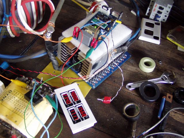

Here are a few pics from this morning.... after reading your woes, I can't put my finger on why.... but here is a few pics showing what I have gotten away with ... with messy circuits spread over a wide area.... but something is right, as it works fine.

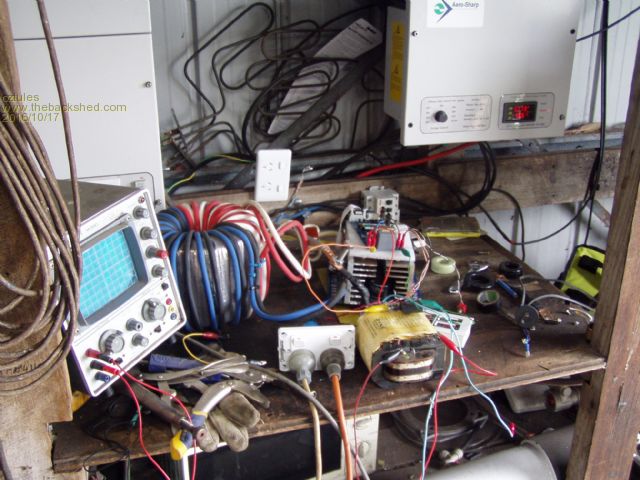

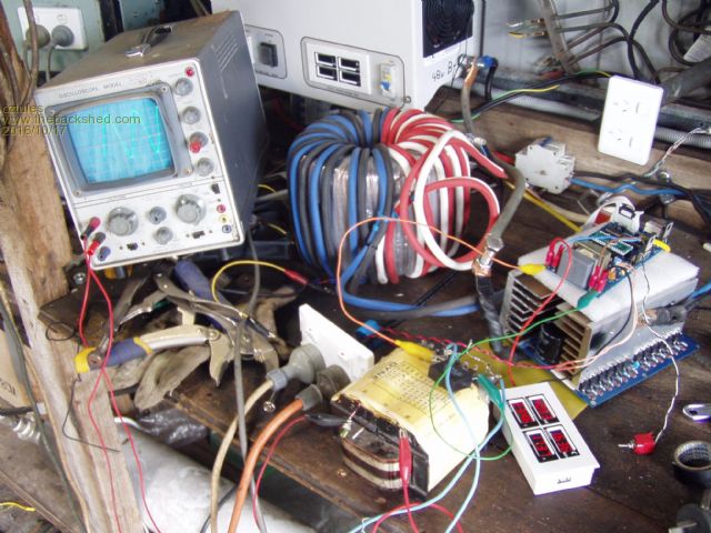

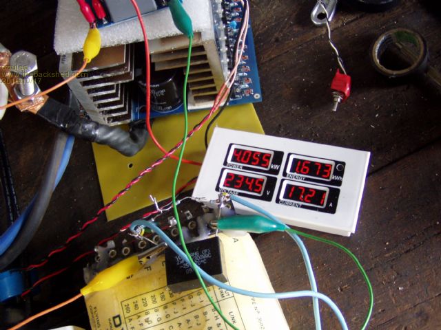

Here we are with a wide shot showing the carefully laid out inverter under test. It is using that board I showed earlier, with the controller I showed earlier ... somewhere here. Both PCB files are there to send straight to the chinese nanufacturers if you want.
This proves that tidy does not mean dosen't work

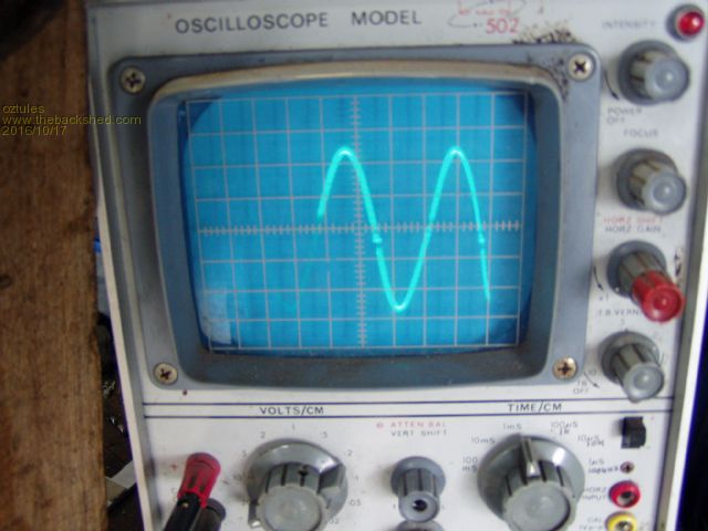

and again..... see sine wave... over 4kw
and power meter...
The dyne transformer is simply to isolate and bring the 240 down to 32 for the scope... it has an extra 2uf across it because it is used to bench test the boards after I build them.... it help a little bit extra for shaping as I only have 2uf on the board ( little tranny took up the extra space so only one there now).
There is a small blip at cross over if you look closely at expanded view, a close up gives only part of the wave because of the crappy camera... and operator who know no better how to use it. ( no zero line is not set )
I figure that if that is the worst that happens at 4kw.... I'm happy
Sharp eyes may notice a few little torroid rings there, and this is using a torroid ring from a sharp GTI for the filter... ran out of e cores... seems to work just as well, but other torroid rings in my possession do not work very well at all with low turns on them.
Here is another pic of the inverter boards

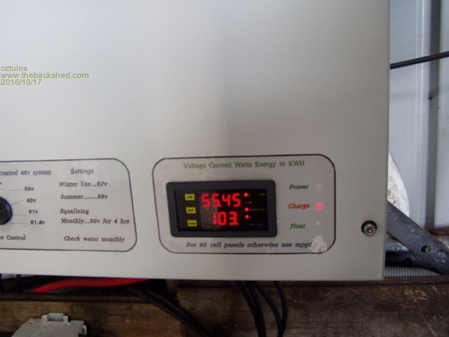

As an aside, here is the solar controller in the background doing over 100 amps
That footscray transformer is 2 in hand 25mmsq wire for the primary and 4 in hand 1.8mm for the secondary... so fairly stiff too.

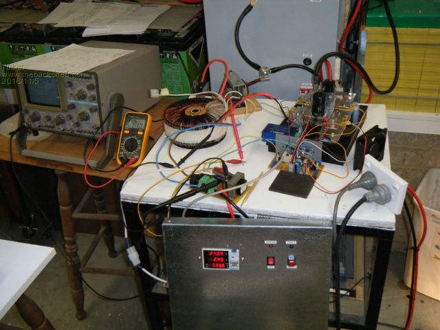

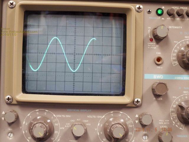

Posted: 01:05am 05 Nov 2016
OK the parts (EGS002 boards) arrived and it *IS* working now.
Here is a pic of the test set up
Nice smooth startup with no load and perfect wave form ( better than yours oztules ).
Then I connected a 75W old fashioned light bulb. Same nice wave form.
Connecting a 500W immersion heater, ditto waveform. No distortion or noise visible.
These tests were without that AC filter BTW, just the shaping capacitor.
I let it run for some time, the large heatsink I was using did not get any warmer than the 37 deg shed temperature.
With no load testing, I saw the voltage is adjustable over a very wide range and the over current shut off works very well too.

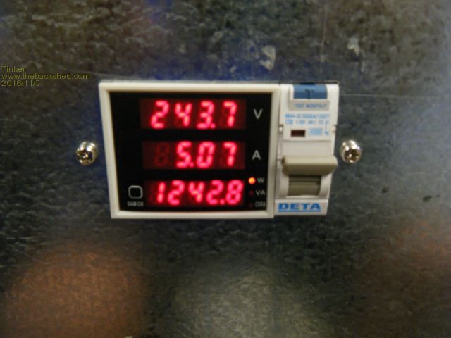

Then I got carried away and tested just how much load that small toroid could handle
It actually run long enough to take the above picture before the magic smoke indicated a melt down.
I guess 1.2Kw was asking too much from just 4 Mosfet's in the bridge.
Now I'm replacing these (also working on a mostly solder less connecting of the legs for easy repair) and then do some more testing to see if that big filter makes a difference - which I now doubt.
I can now see why oztules and the EGS002 board had "issues", these are tricky things. I modified mine and will post these mods and the associated schematic here once my unit runs satisfactorily with the full complement of Mosfets.

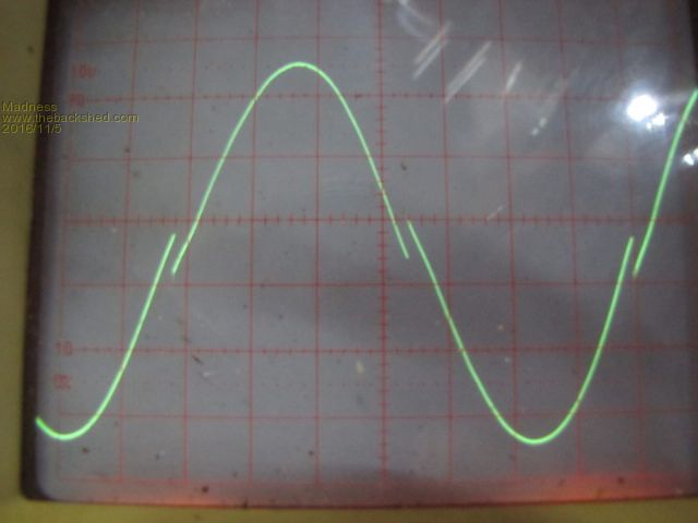

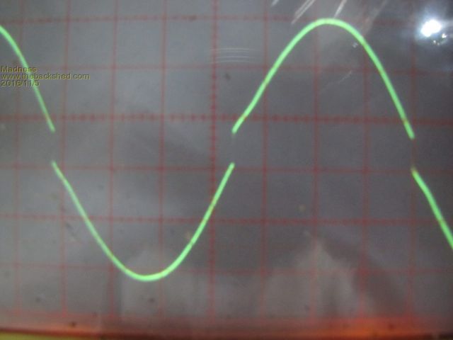

Hi Klaus, I have sine wave envy, just completed my new board and rearranging the tracks made no difference. Still have a gap at zero crossing which gets worse with more MOSFETs and more load, running it on a Toroid makes it worse again than on a EI.
Are the mods you made related to the waveform?
This is the best I can get, 2 images are from each side of transformer secondary.
Edited by Madness 2016-11-06
Posted: 01:42am 05 Nov 2016
Madness, I can see why you have "sine wave envy". I too would not be happy with what you have.
What are you using a a driver board?
I am using 2.2uF for the shaping cap (on the little board with the voltage & current sensing parts.
There will be another 1uF with the -big- toroid, that is mounted directly to the secondary terminals. Dunno how well that works.
Madness
Joined: 08/10/2011
Posts: 2498
Posted: 01:55am 05 Nov 2016
I have tried 2 and 5 UF on the secondary, seems to make no difference.
Sorry which cap are you referring to as the shaping cap?
My driver boards are standard Oztules, I have 2 with temp shut down and 1 with pin 6 shutdown. All of them give an identical result, pictures above were taken with 4 MOSFET test board, the fully populated board with 24 MOSFETs adds lots more distortion and small squiggles on the main sine wave rather that start after the zero crossing gap and diminish towards the peak or go further with more load.
