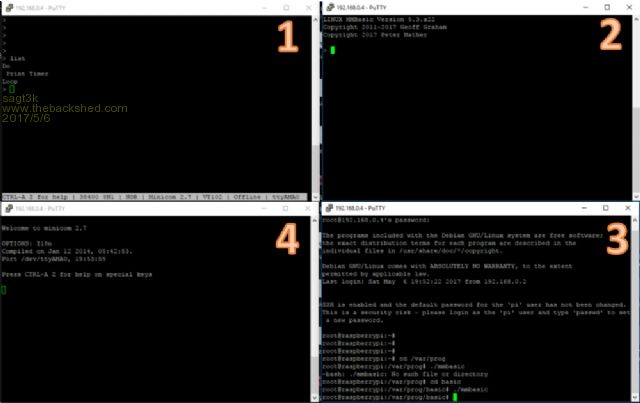

Hi matherp
I run 5.3.a22 on RaspberryPI3
Follow these steps:
1) start minicom on /dev/ttyAMA0 (I connect on UART0 of raspberry a Micromite), you can see, I'm editing code on micromite on UART0<-->MICROMITE console.. OK!!
2) start pi-mmbasic, run a simple code. OK!!
3) quit from pi-mmbasic. OK!!
4) try to start again minicom on /dev/ttyAMA0, UART0 not answer. NO!!!
I tried to go out and go back to minicom. nothing to do. The only solution is to restart raspy.

Posts: 12244
Posted: 09:09am 06 May 2017
  Quote  The only solution is to restart raspy.
As I said in my previous post. Something in the boot up sequence is setting the pins to UART mode which is an alternate setting. PIGPIO is setting them to standard digital I/O. When MMBasic exits it leaves all the pins as digital inputs i.e the only guaranteed safe mode - exactly the same as the Micromite. To solve this you need to find the boot code that does the setup and then run it after you exit MMBasic.

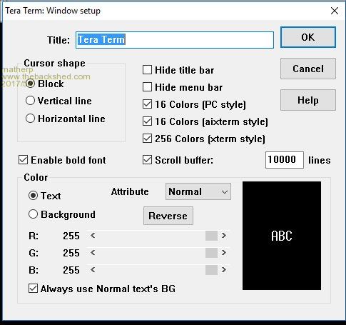

Jim: I don't know why you aren't seeing colour in Teraterm. This is my configuration
  Quote  one thing we did discuss is how ctrl-Z works: it does, by default, not close an application but merely suspends it,
ctrl-Z (and ctrl-C) is/are being trapped by the program and it does do a full exit in response to ctrl-Z. I am not using the pigpiod daemon as this has limitations which would not work for the Pi-cromite. The pigpio code is linked into the Pi-cromite code. This is why you can only run one instance of the code running. I will look at having an option setting that defines which pins the Pi-cromite takes over but the current approach is that the Pi-cromite takes over all I/O in the range gpio2 - gpio31

Posted: 07:44pm 07 May 2017
I still can't get colour using teraterm.
Putty is OK so it's not mmbasic or the Pi settings
With TeraTerrm I get colour from other micromites and 'some' colour from the Pi's command line.
That is 'some' but not as much as when using Putty.
I can't see any obvious setting in TeraTerm but it must be the way it negotiates it's capabilities with the PI when first connecting. I can monitor things if I connect using Telnet but not with SSH.
Can you send me a copy of your TERATERM.INI file and I will try and find where the difference is. It's starting to bug me.

Posts: 12244
Posted: 08:22pm 07 May 2017
Teraterm V4.86
2017-05-08_062218_TERATERM.zip
Posts: 6640
Posted: 08:59pm 07 May 2017
Thanks Peter,
I ended up deleting my INI file(s) and reinstalled to get a full clean INI file with comments.
Now I have to try and work out exactly which setting it is that took away the colours.
The default settings with nothing more than font size changed works well.
Having yours to compare with will help.
I ended up running V4.94

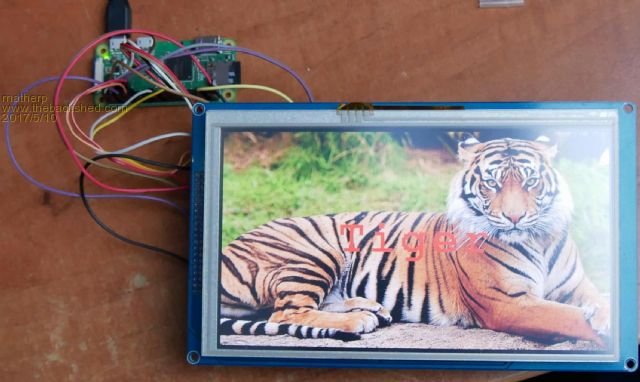

Please find attached V5.3.a23
2017-05-10_170859_mmbasic.zip
This includes a bit of tidying up and also full support for the SSD1963 displays (not though as a console)
pinout is:
SSD1963_pins
SSD1963_WR_PIN 32 //GPIO 12
SSD1963_RS_PIN 13 //GPIO 27
SSD1963_RESET_PIN 31 //GPIO 6
SSD1963_DAT1 35 //GPIO 19
SSD1963_DAT2 38 //GPIO 20
SSD1963_DAT3 40 //GPIO 21
SSD1963_DAT4 15 //GPIO 22
SSD1963_DAT5 16 //GPIO 23
SSD1963_DAT6 18 //GPIO 24
SSD1963_DAT7 22 //GPIO 25
SSD1963_DAT8 37 //GPIO 26
Option syntax and all GUI/drawing commands are exactly the same as the MM+ and MMX
e.g.
OPTION LCDPANEL SSD1963_7,RL,,33
In this example pin 33 is used for RD to allow transparent text and BLIT to be used.
Performance on a Pi 3 is reasonable (Image Load is very fast). Somewhat slower on a Pi-zero (800x480*24 image loads in 0.873 seconds)
