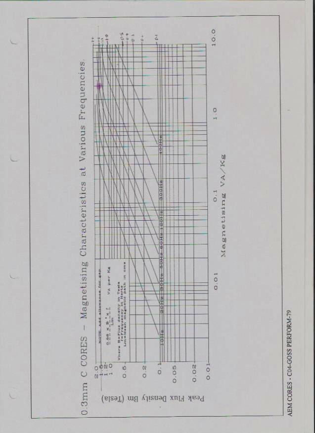

Posted: 09:43pm 05 Jan 2018
I have some very small faint and difficult to read curves for the Australian (AEM) silicon steel cores, which hopefully might come fairly close to the unknown Chinese silicon steel toroid material. At least hopefully it can give us a rough guide.
The fuzzy pink dot is on the 50Hz curve at 1.5 Teslas.
Anyhow, by eyeballing these curves the closest round figures I can come up with for magnetizing core loss are:
3.2 watts per Kg at 1.5 Teslas
1.7 watts per Kg at 1.2 Teslas
1.0 watts per Kg at 1.0 Teslas
So if you end up at around 1.5 Teslas you can figure on an idling power of about 17 watts for a 10Kg sized core and 51 watts for a 30Kg sized core, very roughly.
There may also be other significant idling power losses beside just the magnetising current of the transformer itself. If the mosfets are switching directly into a highly capacitive load, there are going to be some huge not very productive current spikes.
The capacitance comes from physical proximity between turns and the steel core, and more significantly from any deliberate capacitance connected across the secondary.
This capacitance has to be charged and discharged EVERY pwm cycle at 20Khz, and the power to do that can be quite significant.
That can be all but totally eliminated by connecting a suitable series choke between the mosfet bridge and the transformer primary, as you would normally expect to see in a buck regulator circuit.
Many here have experimented with chokes of various types, and it is generally recognized that there can be large gains in idling efficiency to be made by fitting a suitable series choke feeding the primary.
If you are only interested in reducing idling power, a ferrite choke will do that. But ferrite saturates at about 0.35 Teslas, steel at maybe 1.8 Teslas. So for a dc choke with very little ripple current, ferrite is far from ideal.
The transformer magnetising current is very important, but its not the whole story regarding reducing idling power losses.
Get the transformer magnetising current down as low as you possibly can by stuffing as many turns as will possibly fit onto that core. Go lower than 1 Tesla if you possibly can, although it does start to become rather impractical and uses up a lot of wire !
That is half the battle.
The other half is building a non saturating primary choke.
That will not only reduce idling losses, it will increase efficiency at high power output if the choke can keep working at high power output levels without saturating.
Its not so much the gain in overall efficiency at higher power output, as the reduction of mosfet and heat sink temperature rises, and the potential improvement in reliability.
If its running happily supplying several Kw output into the load, an extra hundred watts of input power is not that much of an issue, unless its all going into heating up the mosfet junctions and the heatsink. The more efficient you can make it, the better it will be.Edited by Warpspeed 2018-01-07

Posted: 11:13pm 05 Jan 2018
Oops, I should never post until after my second cup of coffee in the morning.
That should read:
If you end up at around 1.5 Teslas you can figure on an idling power of about 32 watts for a 10Kg sized core and 96 watts for a 30Kg sized core.
Thats getting up rather high.
At 1.2 Teslas it would be more like 17 watts for 10Kg and 51 watts for 30Kg.
A 20% drop in flux drops the no load losses by 53%.
The improvement is pretty dramatic, and it gets even better if you go even lower.
