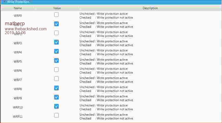

I am still investigating why my STM32F407VET6 board will not run your ARMmiteF4 basic software. That is...Only the first version you made specifically for the serial port runs, and runs reliable. But even the second version you made for serial port, does not work on my board. That image is larger.
I noticed following measuring voltages on the board:
- When the chip starts up in DFU download mode (BOOT0=1) all the JTAG pins on the F407 are either high impedance, or active driven. When running ARMmiteF4 code, the input pins have an weak pulldown enabled (with 10k pullup resistor, on my board the Vhigh=2.5V). If that relates to the problem, I don't know, since I measure this with the one and only working ARMmiteF4 code for my board.
I measure this at : PA6, PA7, PB3, PB4, PA13, PA15. Especially the JTAG pins should default to weak pullup, not pulldown, but better high impedance, since there are HW pullups and pulldowns (like in DFU mode)
I am very interested in the option bytes (they set sector protection on the flash). Do you reprogram these with the CUBE software ? If not, is there any way I can inspect them and see if they are causing my problem. Maybe you know what these bytes should be.
Additionally there was a post on the ST forum that on their USB stack there would be provision of a GPIO pin that indicates when the CPU is ready for USB. That pin would be used to connect to the 1.5k resistor (in stead of a fixed pullup of 1.5k). They did that to avoid critical timing (the host will try to enumerate the device within 100mSec after the high is detected). Can you find in your code if such pin exists, and what pin it is.
I hope you don't get tired of me. I am intrigued by the problem.

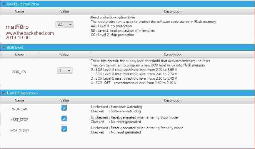

To program option bytes use the OB tab on Cubeprogrammer. Mine as follows:
NB: WP values seem to be different each time I read them but in essence there should be no WP
Edited 2019-10-06 03:50 by matherp

My chip must be defect. Each time i read the write protection flags, the bits are different. Either through usb or through serial. This was the last try. In the bin with the F4. But I am becomming more and more charmed bij MMbasic, so I ordered a pi zero. No ADC, but fast.... only wonder how fast it boots with raspbian buster lite. And if you can run it headless after configuration is done. New challenges. Grogster made a board for the pi zero. Ill look into that one.
Thanks all for your help. But it seems all energy in the world cannot save this chineese F4 monster.

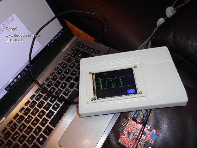

i have a little problem :
since some time my board loses the calibration settings for the touch display, after power down and power up i have to calibrate the TFT, autorun does not work any more.
in the listing options, only the TFT- settings  and touch  displayed nothing else
i had  "reflash d" the chip with "full erase" but it had no effect
somebody has an idea to fix it ? or what can be the reason ?
thanks Ron

Ron, looks like I've introduced a bug - now I need to understand when and how since I'm not aware I've changed the relevant code
Please try the attached:
ArmmiteF4.zip

.. sorry Peter it doesnt work. 100% sure i use the right file.. after power  down and power up it lose the calibration, doesnt start at autorun and.. the "magic" reconnection does not work anymore..all other things are alright

It works for me (using the 3.2 inch ILI9341 16-bit-bus display).
If you just update the firmware, then without uploading your program do a GUI CALIBRATE, cycle power, then GUI TEST TOUCH, what happens?
Maybe the fault you're experiencing only happens when a large program is present?

Posted: 10:51pm 31 Oct 2019
@septimus.. all done so..... the calibration ist out of range again... i purchased an new board :)
thx
